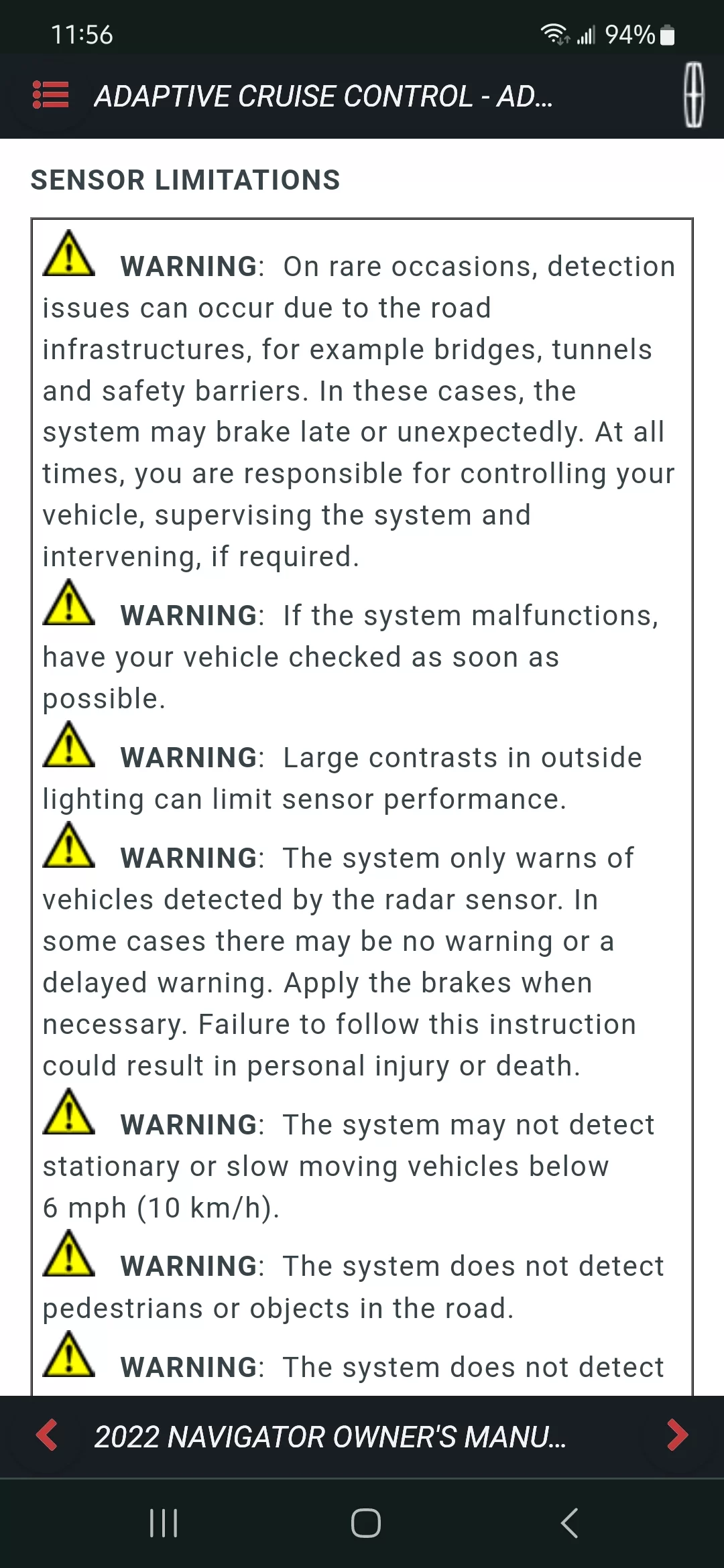

Most every ADAS system contains the warning for stopped or slow moving vehicles. It is a fundamental limitation of the radar system resolution and the number of objects that can be tracked by radar. When running into the the tracking limit, stationary objects are ignored. Just because the system has worked for you in the past does not mean you should ignore the warnings that come with the system.
