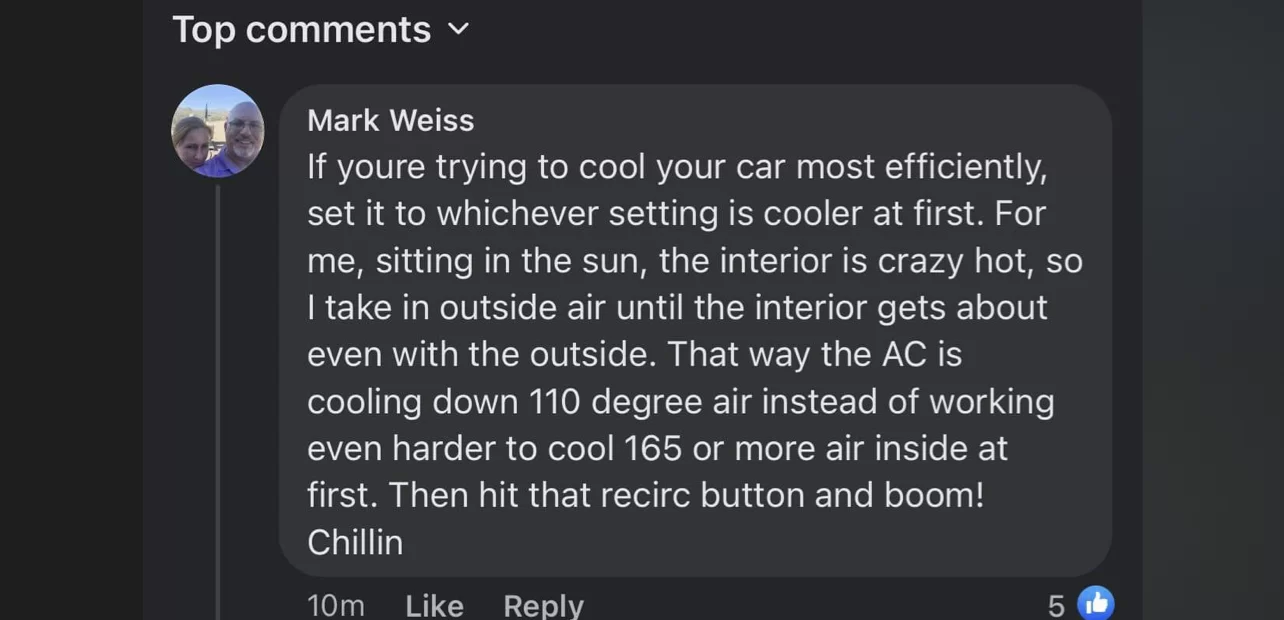

I take that back. Maybe auto is better??
I need to read
Interesting, never thought about that. Here's what ChatGPT says:
Recirculation mode is useful when the inside of the car is already at a comfortable temperature or when you want to block outside odors or pollutants. However, when the interior is excessively hot, it's better to follow these steps for faster cooling:
  1. Open Windows: Before turning on the air conditioning, open all the windows for a short period to let out the extremely hot air trapped inside the car. This will help reduce the initial temperature quickly.
  2. Turn on A/C in Fresh Air Mode: After a minute or so, close the windows and turn on the air conditioning in fresh air mode. Fresh air mode brings in outside air, and since the outside air is likely cooler than the inside temperature, it will help to lower the temperature inside the car.
  3. Lower the Temperature Gradually: Set the A/C temperature to its lowest setting and increase the fan speed to its highest level. As the interior cools down, you can gradually adjust the temperature and fan speed to a comfortable level.
  4. Switch to Recirculation Mode: Once the interior temperature has dropped to a more comfortable level, you can switch to recirculation mode to maintain the cooler air and improve energy efficiency.
Now does the lucid software do most of this turning off and on for us ? I know it says auto but what does auto mean
It means it automatically turns it on and off.
