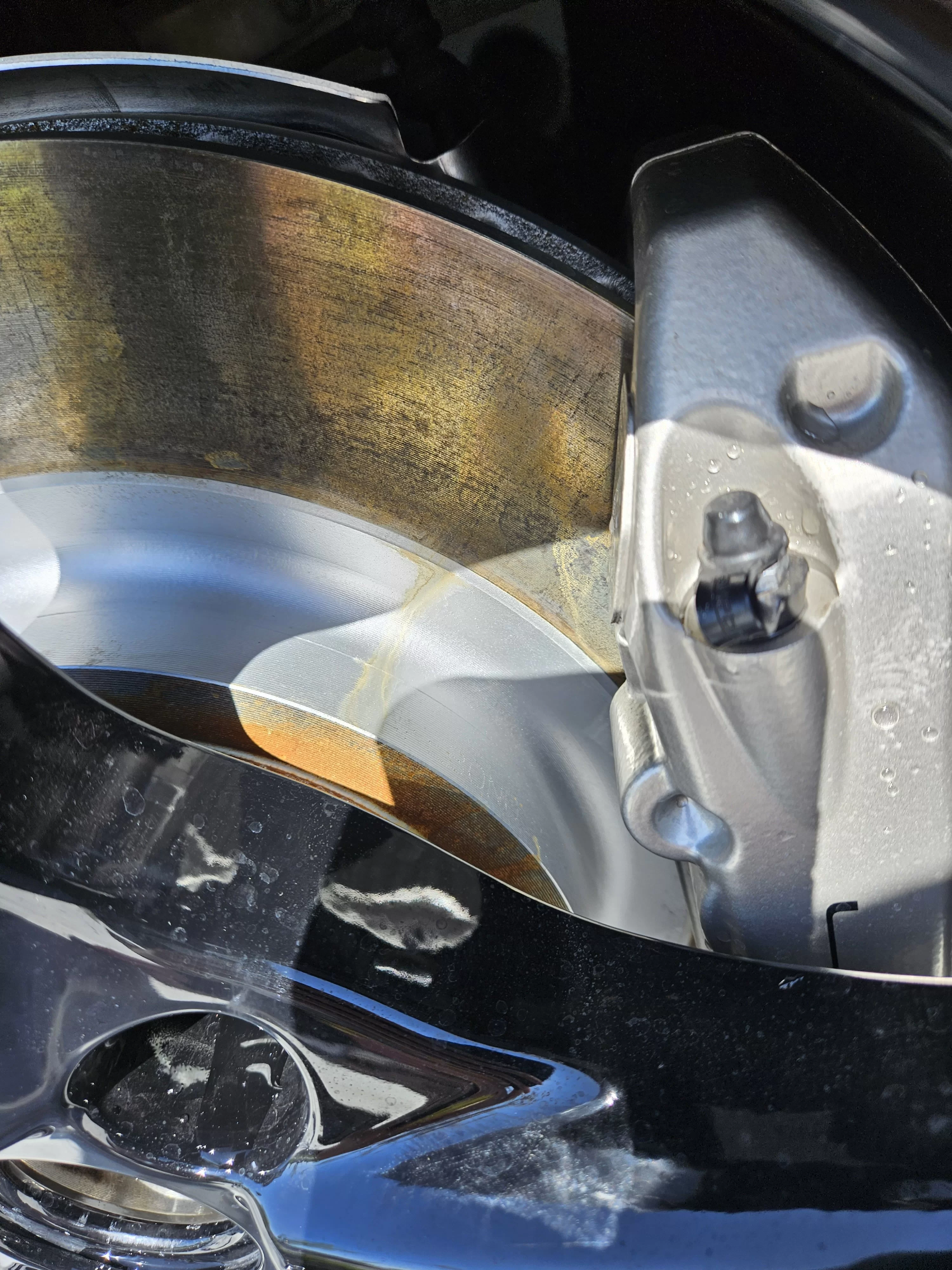

My service advisor is telling me that this is a universal feature of all Lucid Airs. Do y’all have rusted rotors too?
I hope Peter Rawlinson sees this post (and pictures)… do you think he would approve?
He was the architect of the Tesla Model S and my 2016 and 2018 Model S vehicles had no such rust. I have 2 Lincoln’s and they have no such rust.

First of all, please read the guidelines. The tone of your post is inappropriate, and could have been rephrased as a question without the vitriol. Please don't do that again.
As for your question: rotor rust is very common, especially among EVs. The rust is superficial (a thin orange film on the braking surface). It usually goes away as you drive the vehicle for a bit and engage the braking system. The reason it is more common in EVs is because we don't use the brakes nearly as much, so they rust while they remain unused.
Go get on the highway and actually use the brake pedal 5-10 times to slow down, then look at your rotors.
There's no harm in superficial rusting of the rotors.

The rust I am referring to is not on the rotor surface. From my pictures you will see that the rust is on the “non caliper contact” points so braking will not remove it.

If it's a true concern, have them buffed and painted. This is purely a cosmetic issue.

Yes, certainly cosmetic. My motivation is to help Lucid be aware of these misses so they can remedy and protect their luxury brand image. I ran into a Lucid marketer and he said that they are very intentional about understanding customer experience.

I'm a little confused by these posts. In the 20 years I've owned homes in south Florida, I've never had a car that didn't accumulate rust on the brake rotors, and quickly, too, when sitting after a rain or car wash. Sometimes the rotors would bind to the point that you felt and heard a dull pop as the rotors broke free when you started to move. Unless you have carbon fiber discs, you're dealing with cast iron here, folks. It rusts.

First I use Gyeon Iron Wheel Cleaner on the rotors and then BrakeBuster on the wheels/ rims. The problem is I can’t get even a toothbrush in and around the rotor cap/ hub to scrub out all the rust.
Great comments about the 20” wheel design not favorable for rust prone rotors (non brake pad contact points). I hope Lucid fixes this down the road by going with different parts suppliers.
