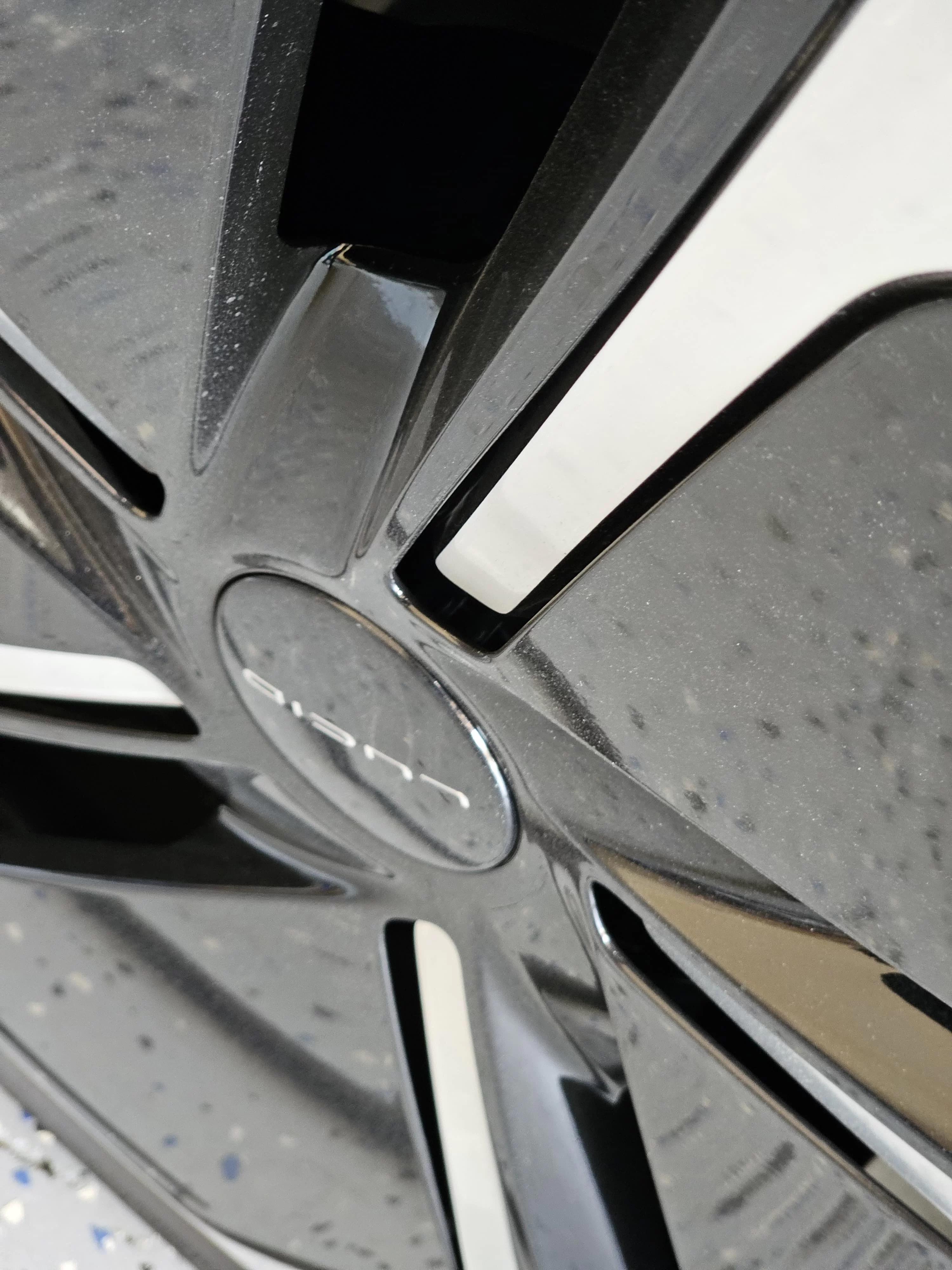

Hello All... First time EV driver here... (trying for this to not sound like I'm in an AA meeting). Overall, I'm loving my 2025 Air Touring. I've recently noticed a few items that I will submit to maintenance, but the center clip keeps popping out on the driver's side of the car. I haven't noticed it on the passenger side. I can easily pop it back in, but I fear that over time it will wear and get loose, ultimately causing the entire cover to pop off while driving. Not sure if anyone else has had similar issues.

One of my covers tended to do that...
I dimly recall that I bent the metal clip a little before popping back in and haven't had problems since. YMMY and please don't blame me it the clip breaks...😅
do you have the valve stem properly aligned to the cover? on the back of the cover there's a little icon that shows where to align the cover to the stem. also did you remove the hub cover if you have one (although I don't think the aero cover can successfully snap on at all when the hub cover is in place).
I'll check this as I've never taken them off. They came from Lucid like this but you never know... thanks.
