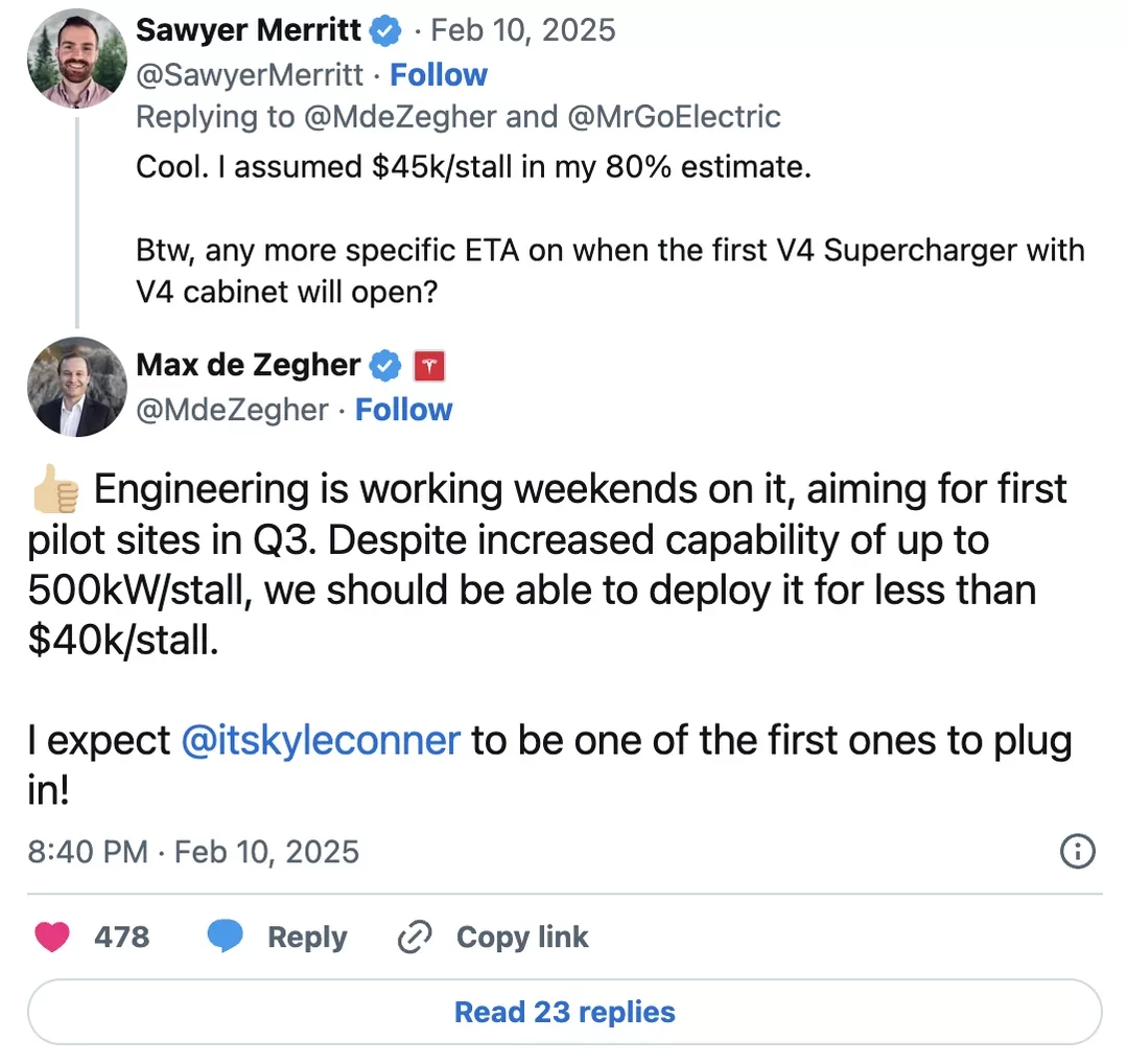

Tesla has announced true V4 cabinets that will support up to 500 kW for cars, but those are still in the permitting and rollout phase. Once you pull up to one of those, you will not be throttled back to 50kW but get the full Monty of 500kW!

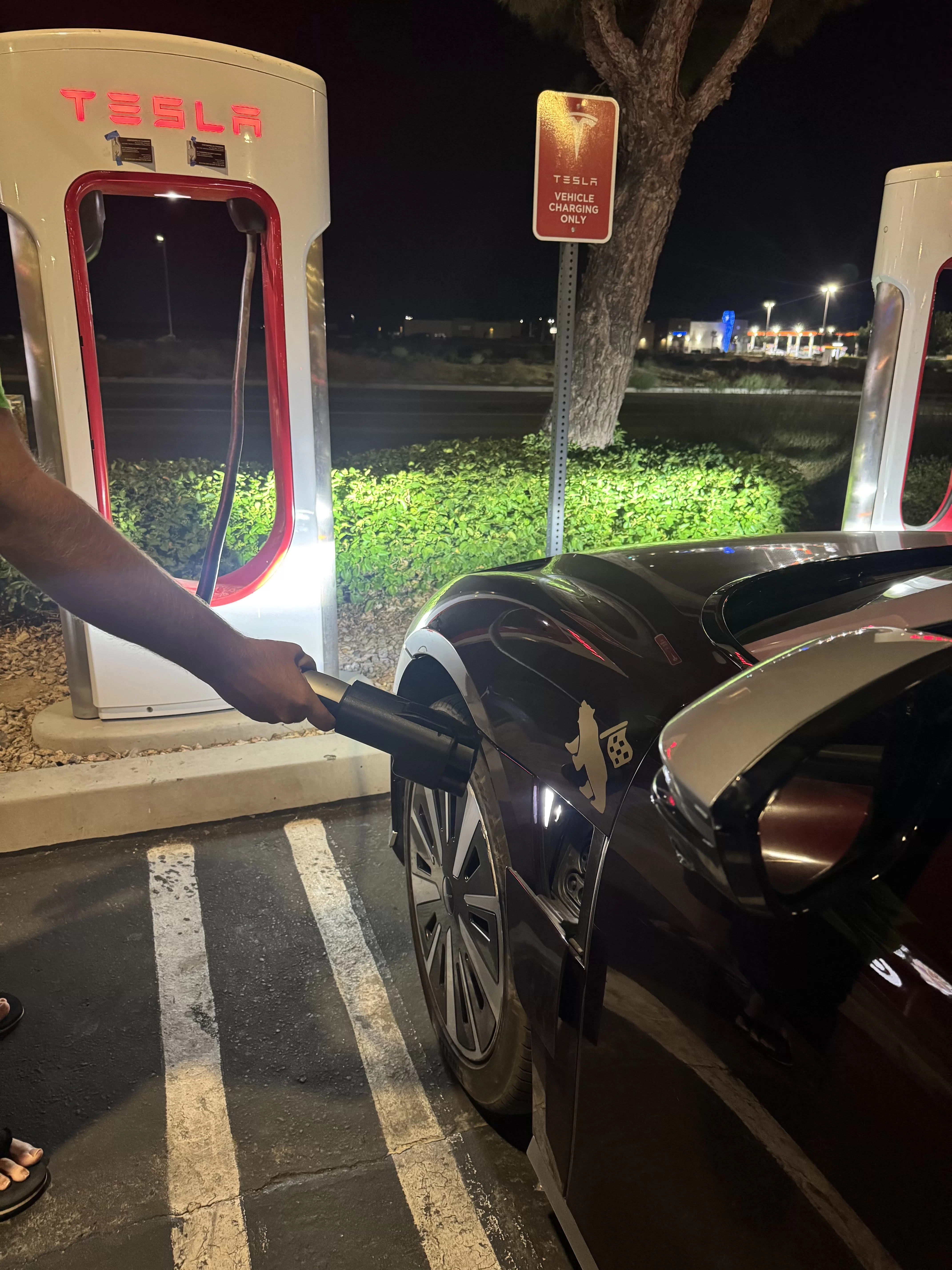

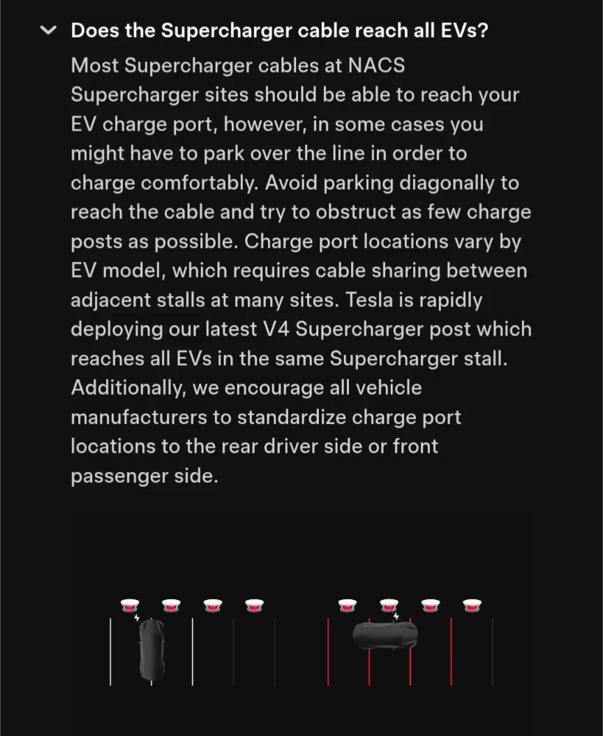

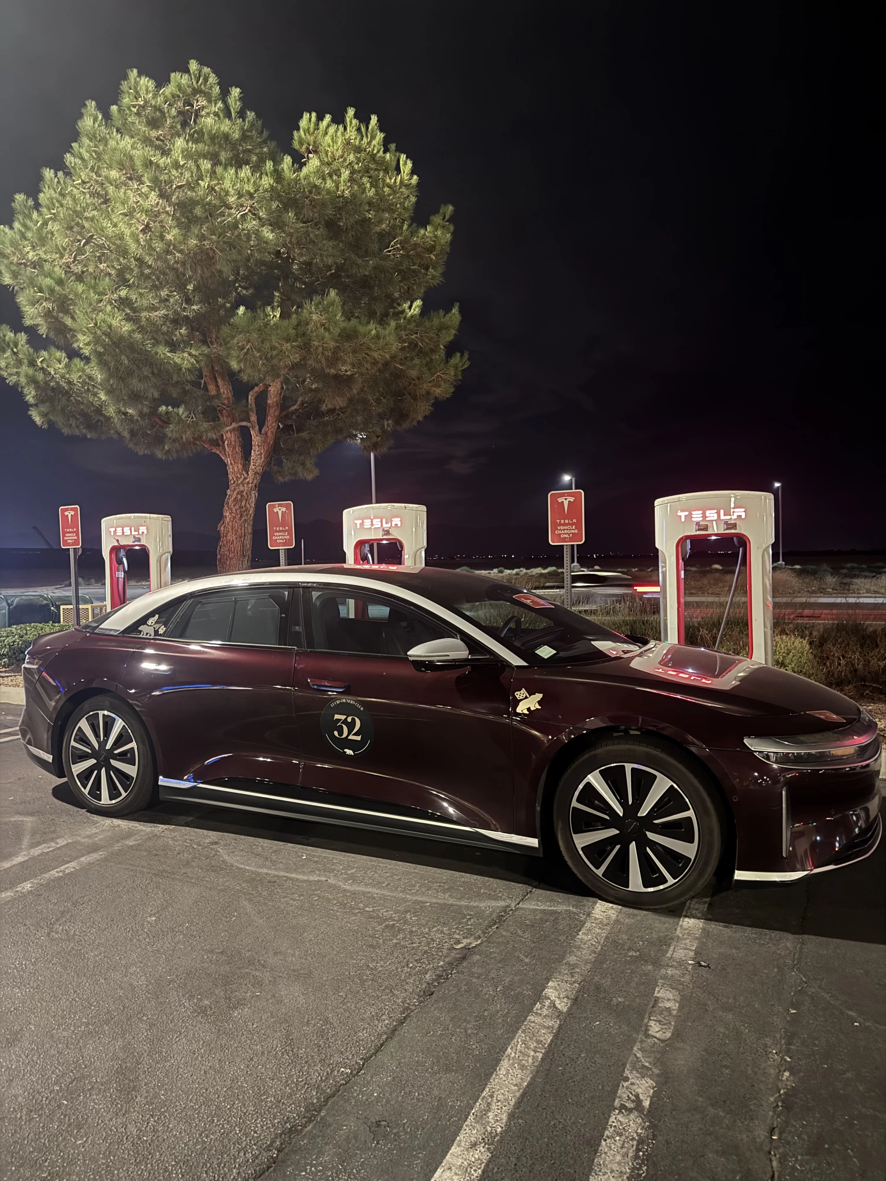

Works great except it won’t reach on the older Tesla charging spots, lol. Would be nice to have a 3-4 ft extension cable.
(Valet recently wrecked my 19s on a curb, ugh)
My 19s aren’t as cool as @Amster ‘s Gravity Bears.
So close but so far!! (Ft. @Denali_Dane )

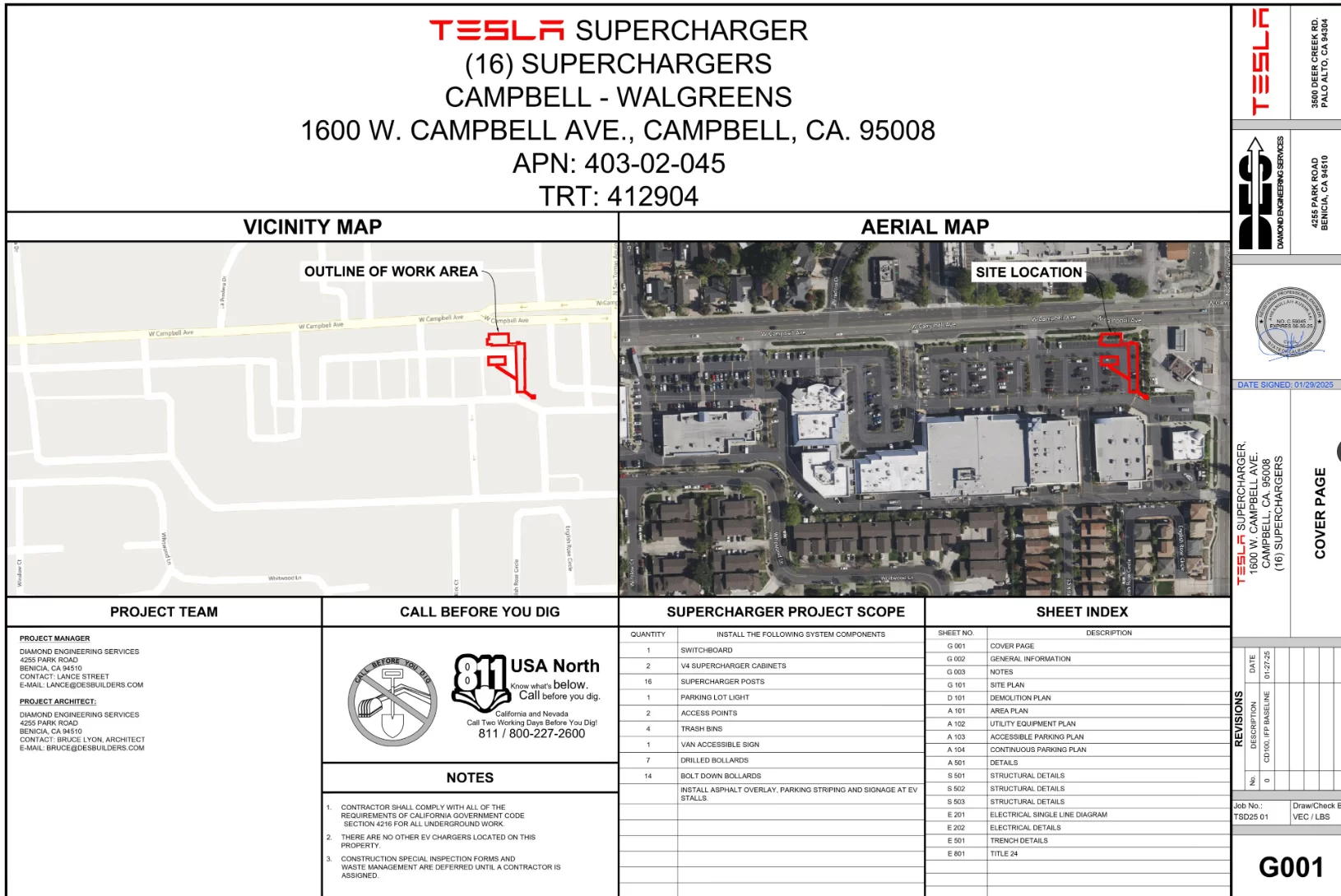

Do you have any proof of that whatsoever? If not, then let's keep things to the actual facts. The facts are V4 pilot sites are intended to go live Q3 this year. Sites are already in permitting
Here is a true V4 site in CA currently in permitting

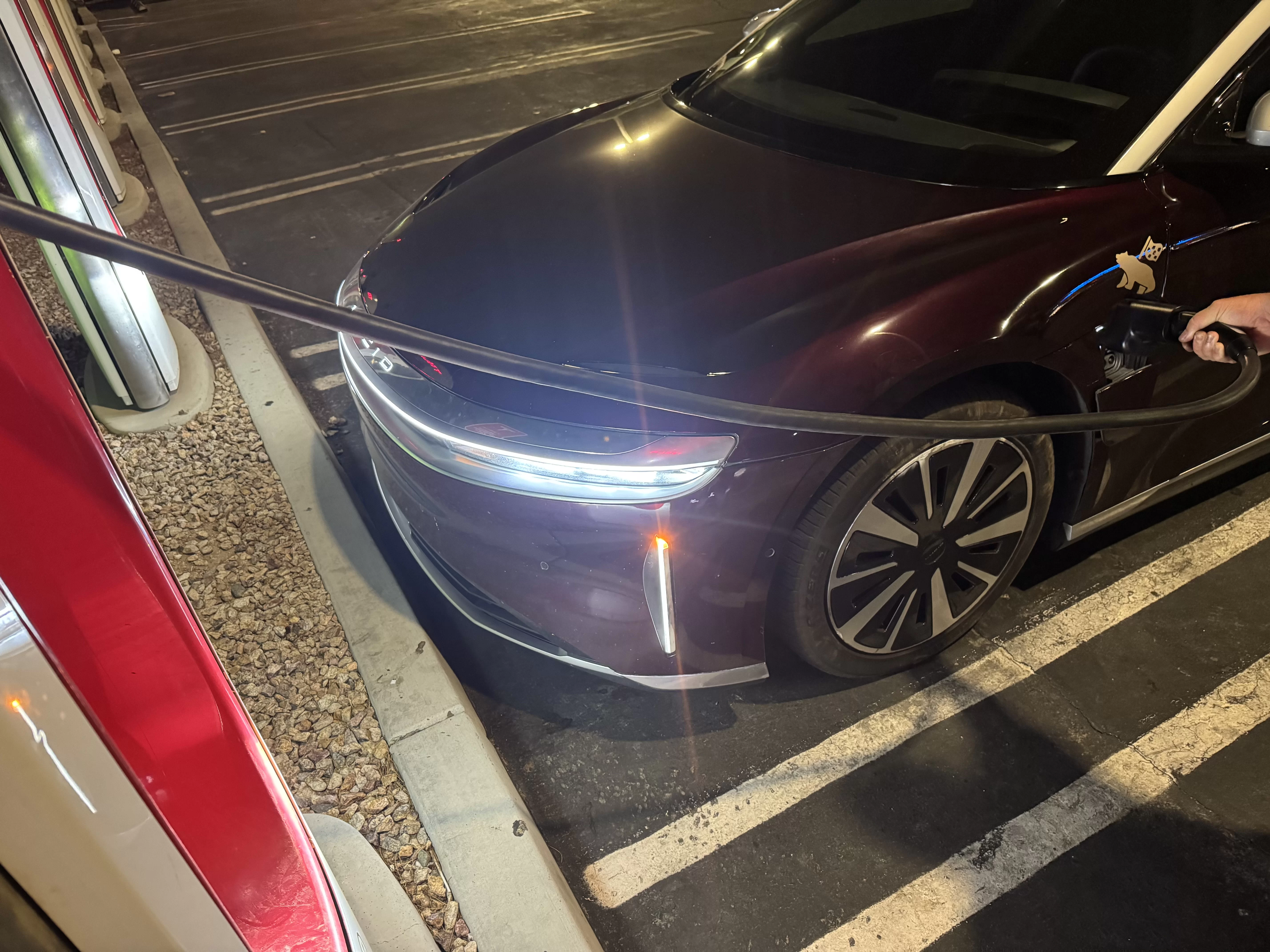

lol, as you can see by my photos it doesn’t reach in that orientation. No matter how close you get it…
Jeez @HC_79 tried calling me out.
I saw an opportunity and I took it, would you expect any less 😂
In all seriousness though, the Air is going to be a PITA to get plugged in at the V3's. If the cable was just that little bit longer.....
