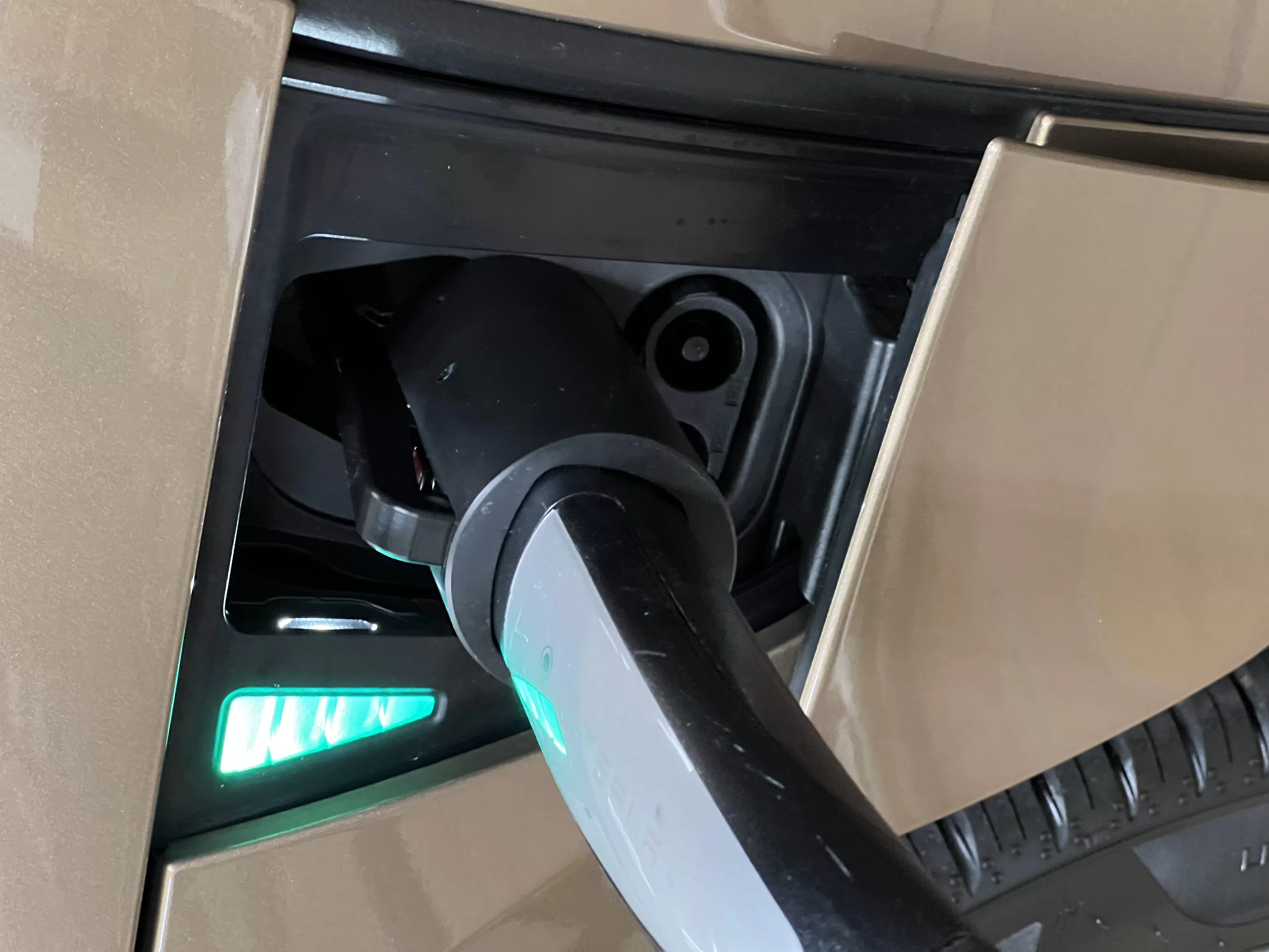

Here is a picture of the MINI 80 connected to the Tesla cable "charging":
I bough one before I took delivery of the car to verify it works. I tried it on my wife's plug-in BMW. Currently I've seen a maximum of 16kW charging with it (I have an 80A, 19.2KW charger). I was charging to 80% and started at 78%.I have to remember to buy one of those soon.
