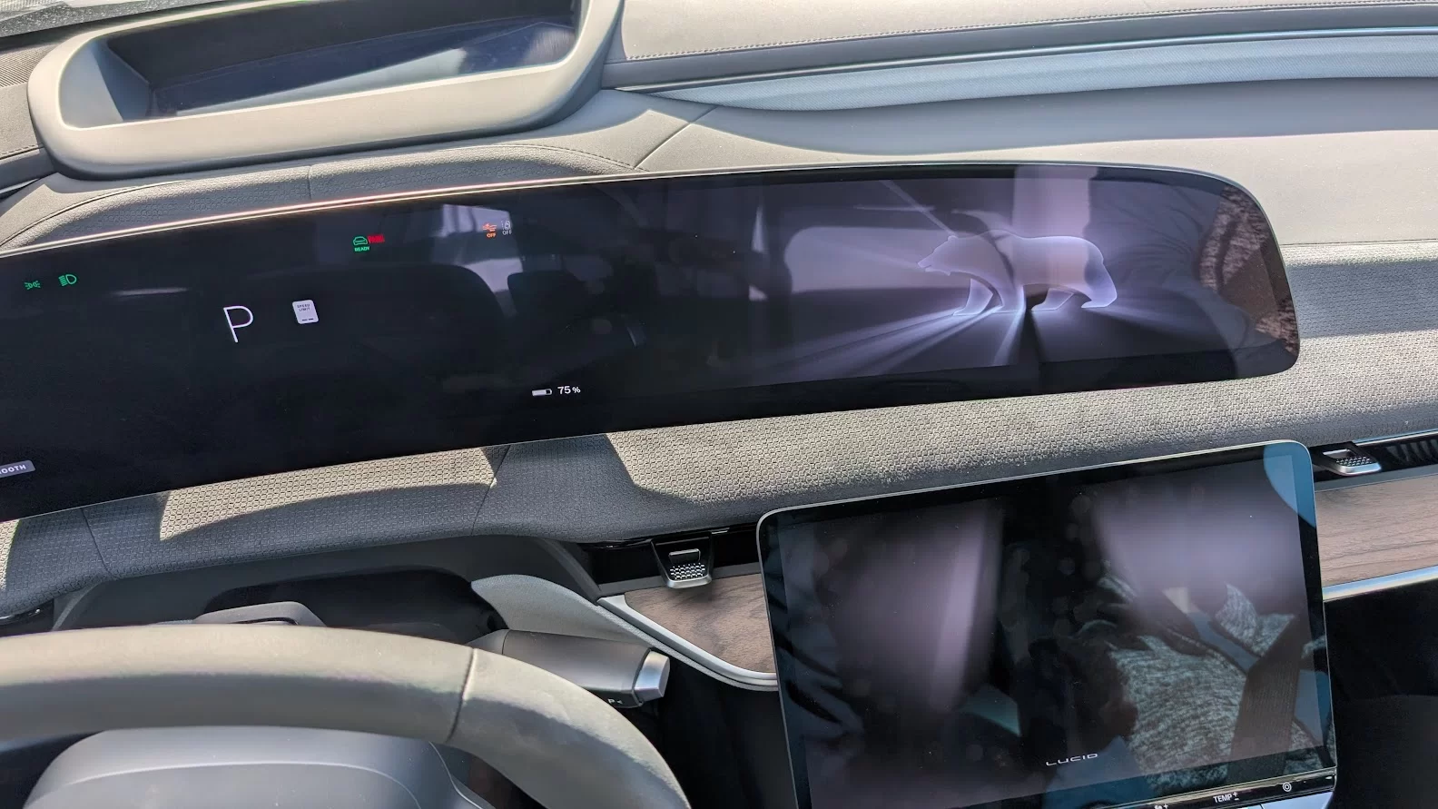

For us the most common one is getting stuck on the following boot screen... we can drive out of the garage while stuck like that but we can't close the garage door. This happens at least once per week for us. A reboot fixes it.

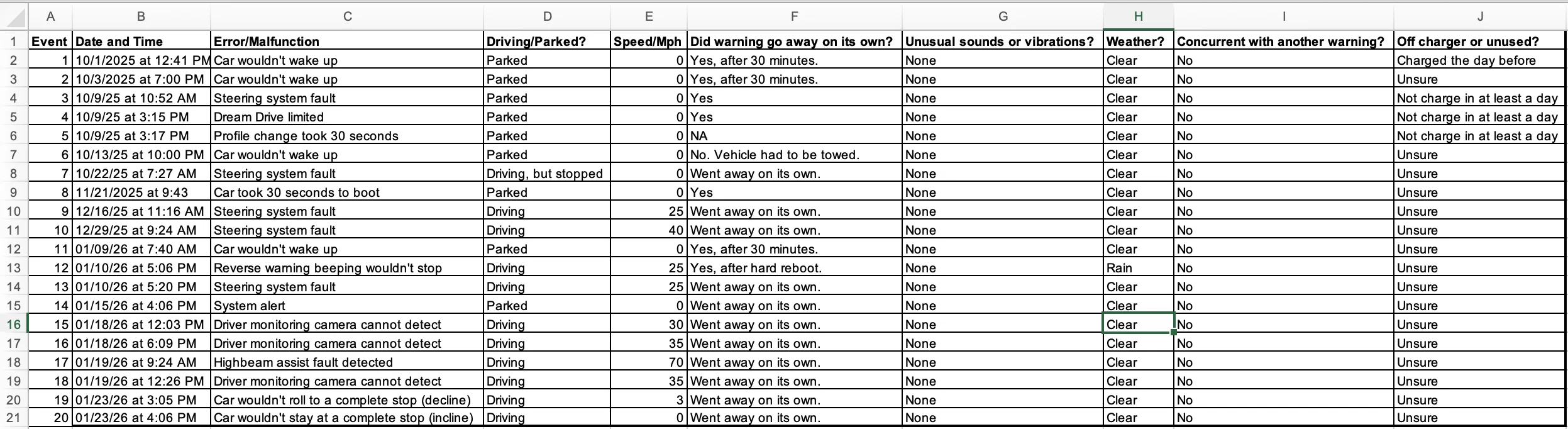

Since my last post a couple of weeks ago, the car will no longer charge at the scheduled time (01:00 AM) despite Lucid pushing out a 'fix'. Now the driver's side window won't stay closed. When I pull up on the window control button, the glass raises all the way, but then immediately lowers again to about the halfway point. Customer Care quickly identified this as a problem only a mobile tech could remedy, but still unsure of when that'll happen.
Unbelievable...in less than five months, I've reported to Lucid 25 documented faults/errors and counting, and it's been in service for 21 days. When interested people ask me how I like my Gravity, I just have to laugh.
That's one I've never seen. I've had completely black screens once. I haven't had to reboot the car in a few weeks. Funny how different people's experiences are with the same vehicle. Ours was a December 1st build.
