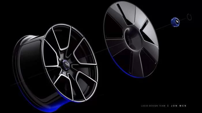

You’re aware that you’ve just posted a picture of a 5 lugnut wheel with a faux center locking wheel cap, right?
I stand corrected. As per page 199 of the manual, it appears to be 5 lug indeed, with the center locking nut an actual locking nut but for the wheel cover, not the wheel itself.You’re aware that you’ve just posted a picture of a 5 lugnut wheel with a faux center locking wheel cap, right?

No idea. The more likely scenario is journalists suck, and got confused.True that. I still remember the "Car & Driver" article that lauded the Lucid Air's air suspension two years after the car was in production with a coil spring suspension.
However, multiple press sources besides "Top Speed" referred to the center lock wheels. For example, "Torque News": "The Lucid Air Sapphire departs from the aerodynamic wheel designs seen on the rest of the Air family in favor of lightweight forged wheels with race-style center locks."
And then there are the numerous tire manufacturers and retailers who refer to the Sapphire as a "center lock" model.
I'm wondering if the Sapphire prototypes that were demonstrated to the press had center lock wheels that were changed to 5-lug wheels for production?
Yup.I think it's confusing since the wheel is 5 lug but it's the aero cover that is apparently "center lock" as per Lucid's own press release.

- Removable carbon fiber aero wheel covers with center lock nut

This is not accurate. The center lock is only for the aero covers. 5 lug nut wheel.The Sapphire wheels are center lock wheels and cannot be mounted on a car with lug mounts without modification.
