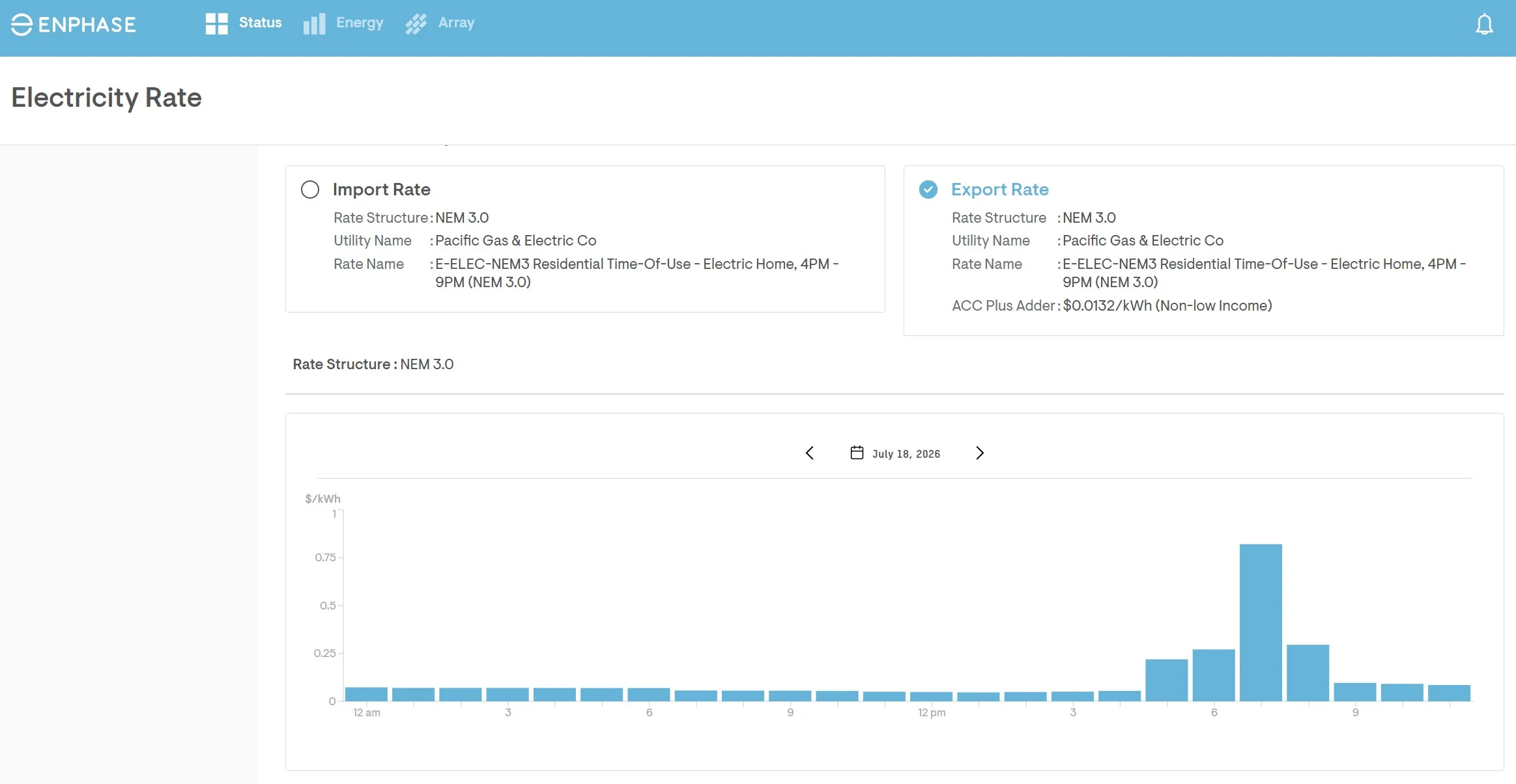

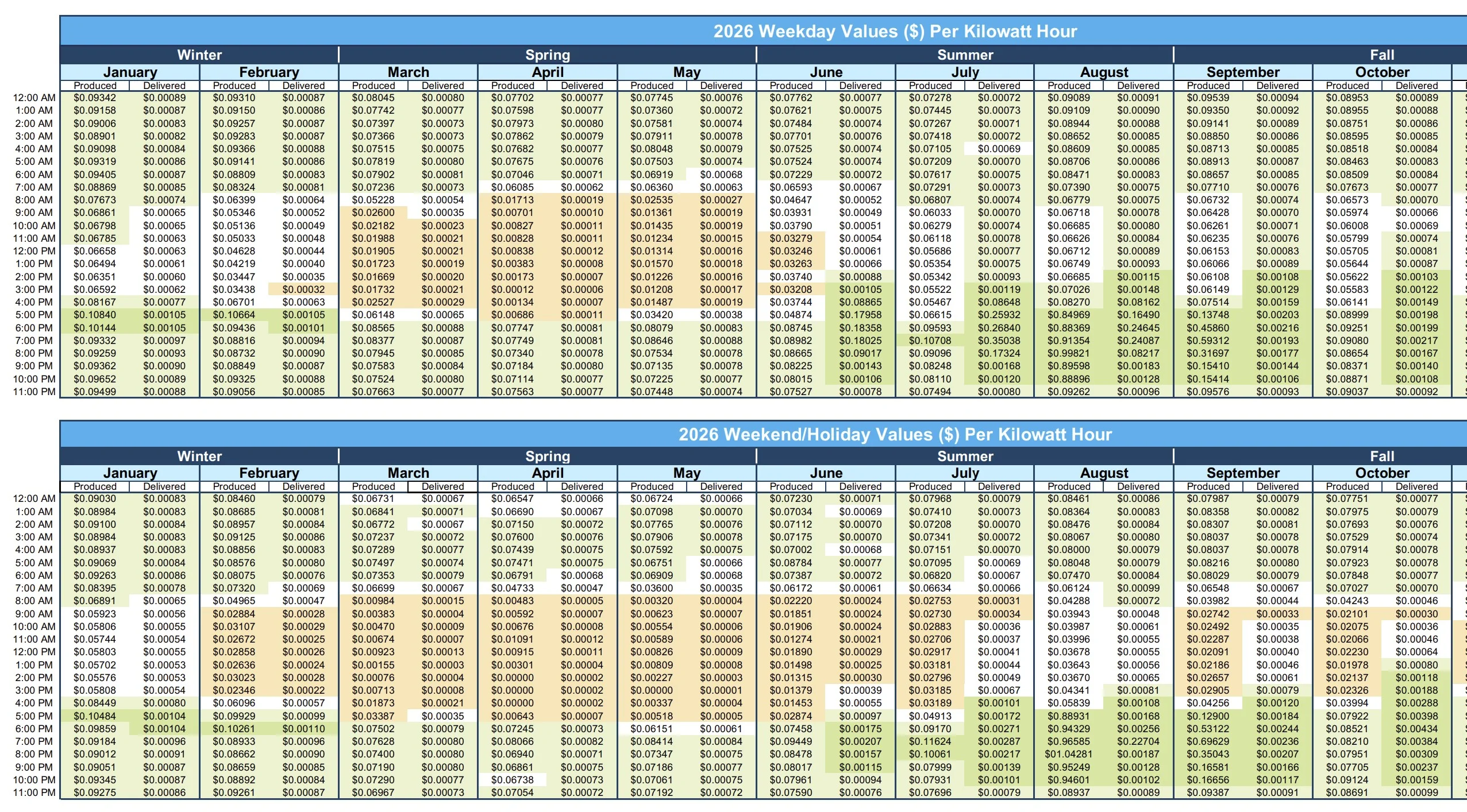

The export rate at $1/kWh is only during a few hours during VPP events..
Enphase says that PG&E told them $0.82/kWh for yesterday. Rates in August top $1/kWh from PG&E's chart. I don't know why the rates that Enphase imported from PG&E for yesterday are higher than the rates in PG&E's chart. Maybe there's an adder incentive for new NEM3 customers.
