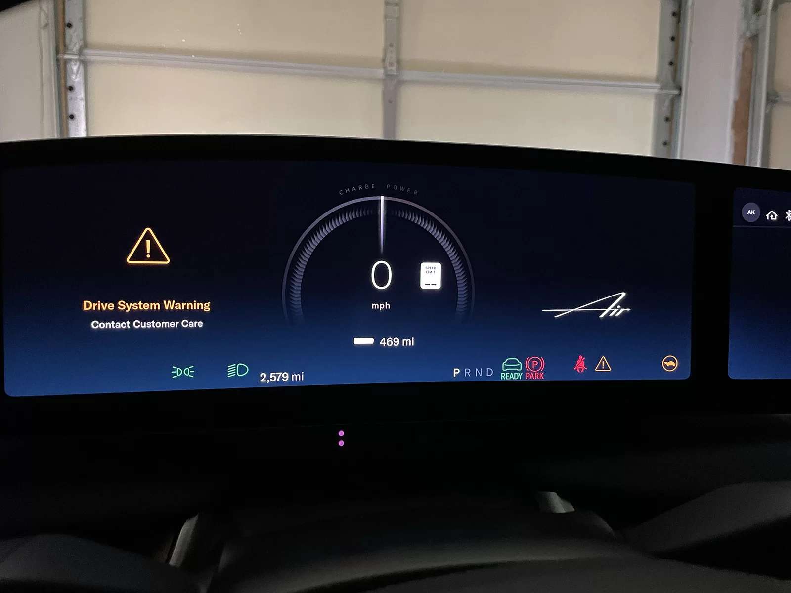

Went into the car this morning ready to go on a long road trip. And then I get the "Drive System Warning, Contact Customer Care." Great way to start this long weekend. Looks like I will have to revert back to driving one of my ICE cars this weekend. The only thing I did differently than any other time was to set the charge limit to 100% since I was taking a road trip. Customer care said it will take up to 48 hours for a tech to schedule something. Seems a bit long and a waste of a weekend where the main event was me driving through Shenandoah National Park with the Lucid.

I’ve received that exact same error on 3 occasions but the car actually drove fine and was cured by a soft reboot. Maybe try a valet card deep reboot? Or did you try that already?

Customer care only had me do a soft reboot twice.
This is from my service rep, who has been addressing any issues from day one:
I’m so sorry this happened to you. Since the vehicle is in turtle mode it limits your speed. This will be something where the vehicle would need to be transported down here to us in Richmond so we can really look into it and replace what is needed. Unfortunately it’s not something we would be able to do on a mobile visit since power cycling didn’t resolve the warning lights. We could get you setup with a rental but that sometimes can take the better part of a day. Let me know if you would like me to get a rental setup for you and also if we could have the car transported to us today and if not what day would work best for you?
I will try the valet reboot when I get back home later this morning, since I put my trip on hold a decided to stop by work.

Can you give me the steps to do the valet card reboot, I have not tried that yet, but have seen others do it on the forum.
For the Valet card, make sure you do NOT have the fob or phone anywhere near the car after you’ve opened the door (if it proximity senses them it won’t reboot properly). Then close the door and hold the valet card above the B pillar camera on the driver side, and the car will lock and shut down. Then go away from the car for 15 minutes and come back and unlock it with the fob. It may not work, but all 3 times I got that error it was a false alarm and the reboot cured it. Mine seemed to be caused by this complex toll radar assembly underneath this bridge near my job. The vehicle would first say “drive off alert unavailable” then would say drive system error contact customer service. Your problem may be different though as my car never got the turtle icon, just all the other alerts you have.

Thank you for the detailed instructions, I will save it in my notes and try this as soon as I get home. If it works, I may cancel the tow truck driver, who is on their way from PA and will take the car to Richmond, VA.

No luck with the reset. Closed hauler came. The car barely moved as I depressed the accelerator and kept jumping back to park when I moved my foot off the pedal. They got it tucked in and it's off to Richmond.
