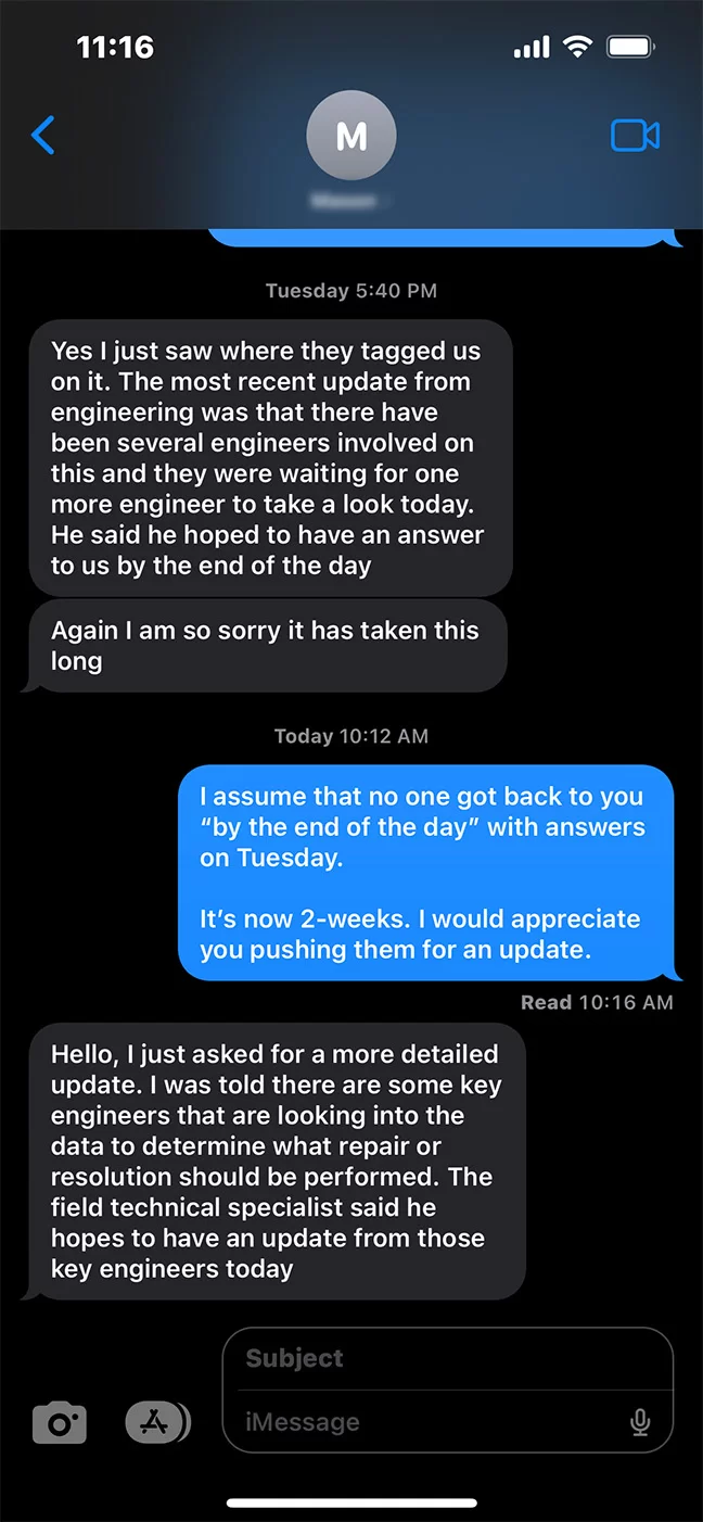

Yes I just saw where they tagged us on it. The most recent update from engineering was that there have been several engineers involved on this and they were waiting for one more engineer to take a look today. He said he hoped to have an answer to us by the end of the day. Again I am so sorry it has taken this long.

Demand a call with Sr Management.Still no word from Lucid and it's been nearly two weeks. So, as I have stated earlier, the service tech in Richmond, VA told that he is waiting on the Lucid engineers to identify what is causing the issue. That was last Friday. I decided to call Lucid Customer Care yesterday and see if they could get in touch with the engineering team to provide me some update - and I specifically told the Lucid Customer Care that the tech is updating me with what he knows, which is not much, and I am calling so they can contact Lucid engineers. All they did was contact the tech. Here is what he has told me:
Of course the end of the day, hell the entire day came and went without an update and today I still have no update.

I will wait until Friday, when it will be two weeks and then start to reach out to management on this.Demand a call with Sr Management.

Just an FYI - no contact from Lucid. Second time they have promised to contact me by COB and they did not.
Wow, over two weeks to diagnose a problem. I am not an IT person but would have thought that Lucid would have been able to identify system problems rapidly. It would be rather disconcerting to learn that they take a trial and error approach to diagnose drive unit problems. Perhaps the over-promising of a response is a function of too few engineers available, rather than faulty diagnostic systems. Either way, not confidence-inspiring.I did get an update today. My tech said the engineers were able to pinpoint the issue to front drive unit and the engineers want the tech to perform some voltage checks on it. Once he completes that he will send the data off to the engineers and they will tell him what the next steps should be.
