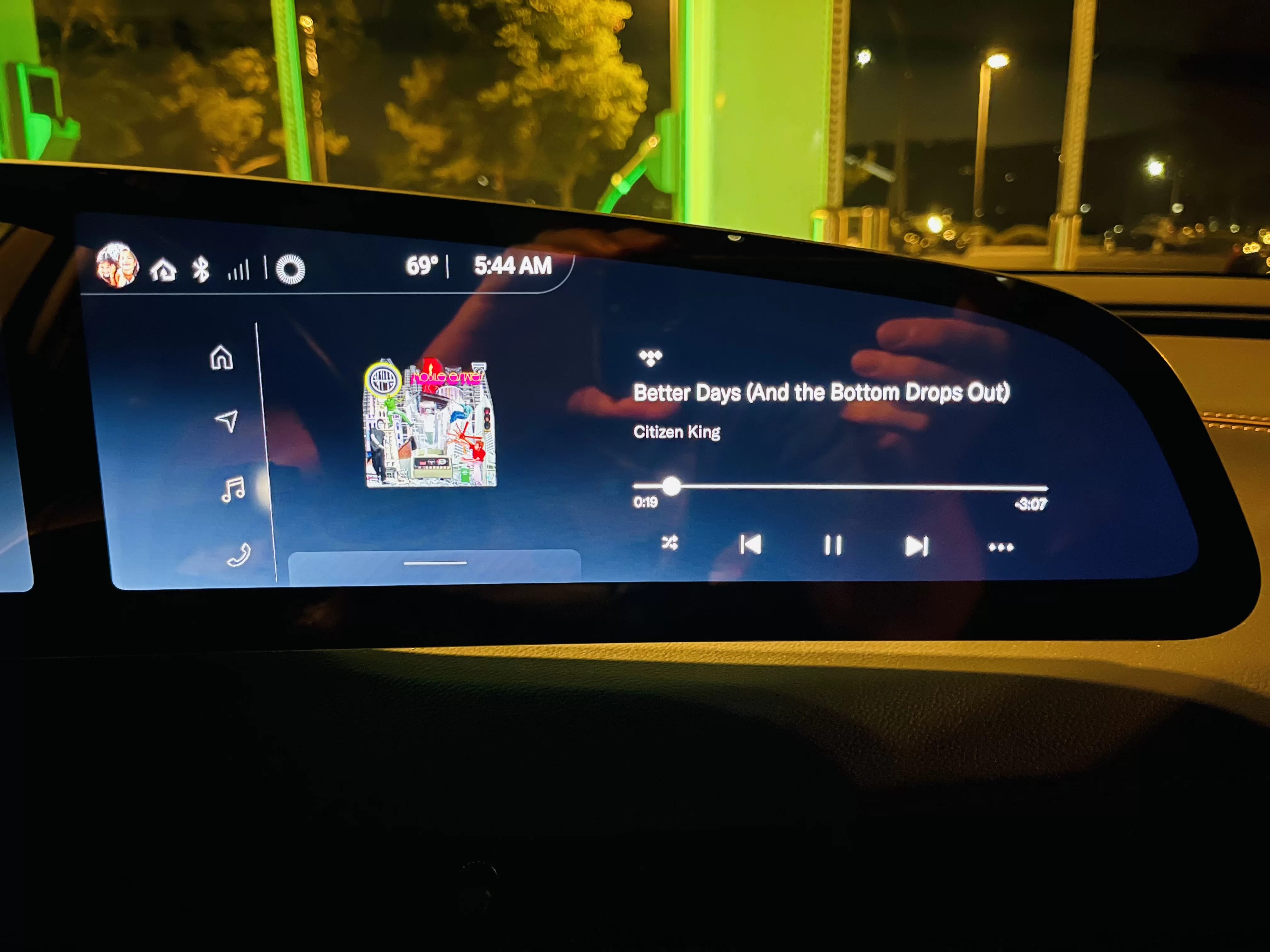

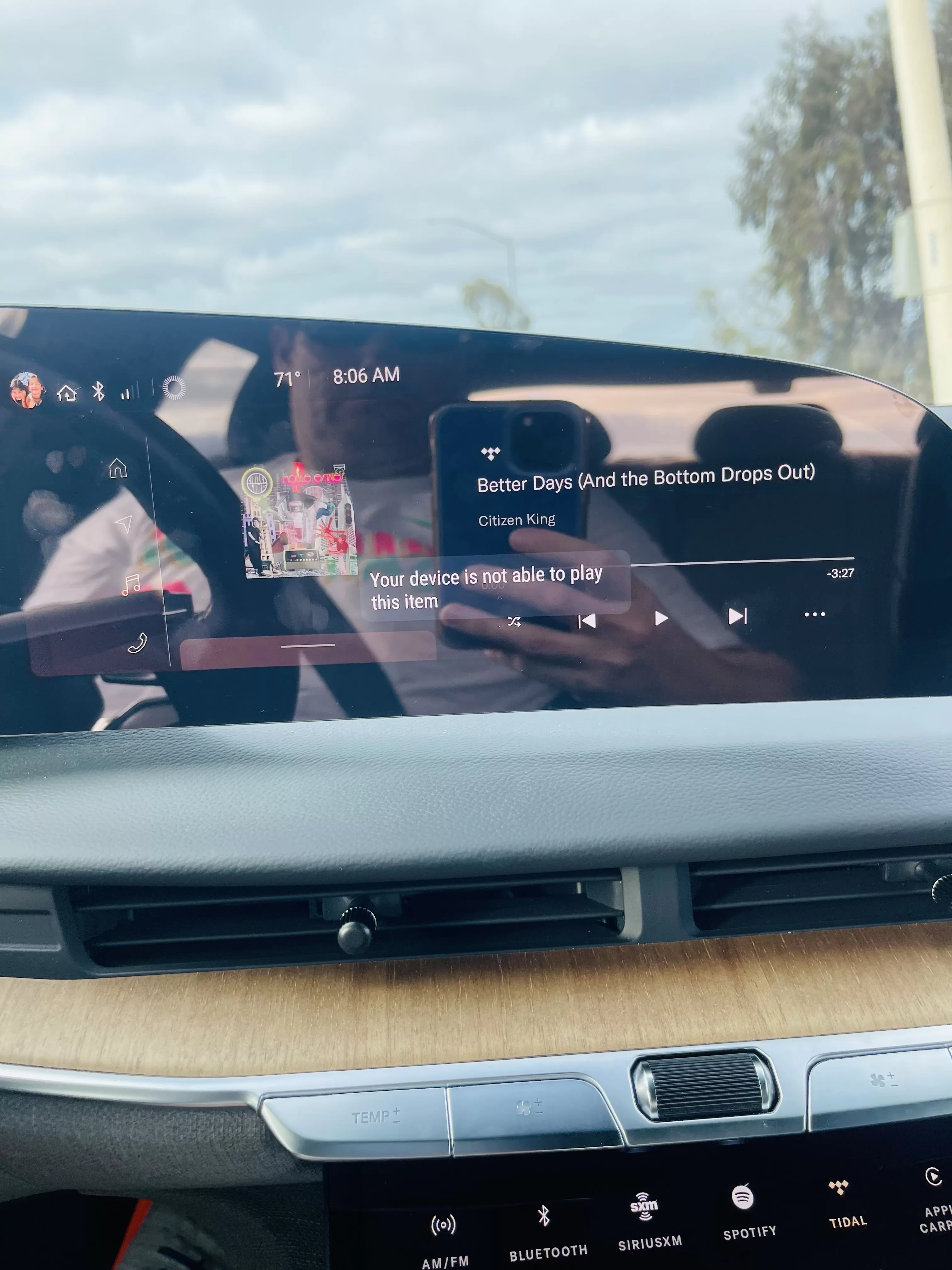

I’m facing different Tidal issues but issues nonetheless. I’ve gotten the “your device is not able to play this item” popup a lot and Tidal just ceases to work until I do a soft reset or walk away from the car for a power down. It’s not cell service, because this morning it happened in the garage on WiFi and in the photo you can see I had service on the faulty photo and don’t in the not faulty photo.
Not sure what’s going on, but this is new to me on 2.8.0 in my Air. I’ve had Tidal since the beginning of Air time, 2022 and never had this issue until this latest software version. I’ll submit a ticket 🤞 View attachment 32366View attachment 32367
This is "unable to play this item' is my reoccurring issue. It seems to occur when trying to scroll through selections, but once I get this message it seems that Tidal is out of commission until I do a soft reset -- or shut down and re-enter vehicle.
