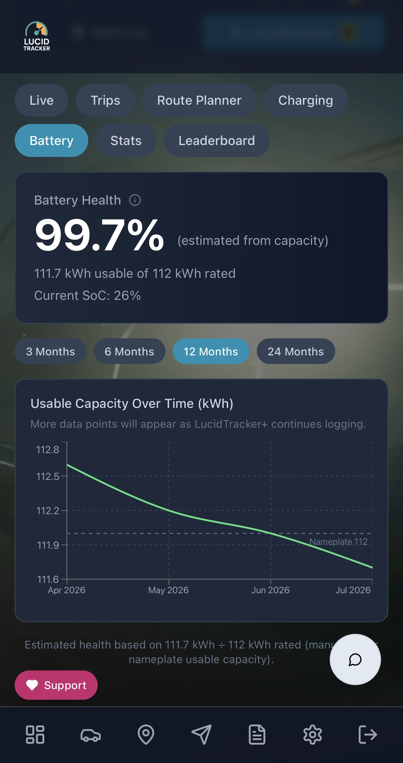

Why not grab the data after each drive, for a couple of days. Look for patterns in the data.
Indeed its in Lucid tracker.
Any idea how many data points there are and what the time stamps look like (spacing between samples).
Also a bit curious how the curve is being shaped based on that data.
My Pure is about 13 months old since purchased new an has 12K miles.
My testmycode site shows this:
Whereas, Lucid Tracker shows this:
That obviously means BatteryHealthLevel does not mean the current health of the battery.
What is the consensus on what BatteryHealthLevel actually means when picked up from testmycode.
Looking at the numbers I posted above, Lucid Tracker is using CapacitykwHr to calculate battery health.
My current capacitykwHr is 83.27 which rounded up is 83.3 and that Is what Lucid Tracker is displaying.
