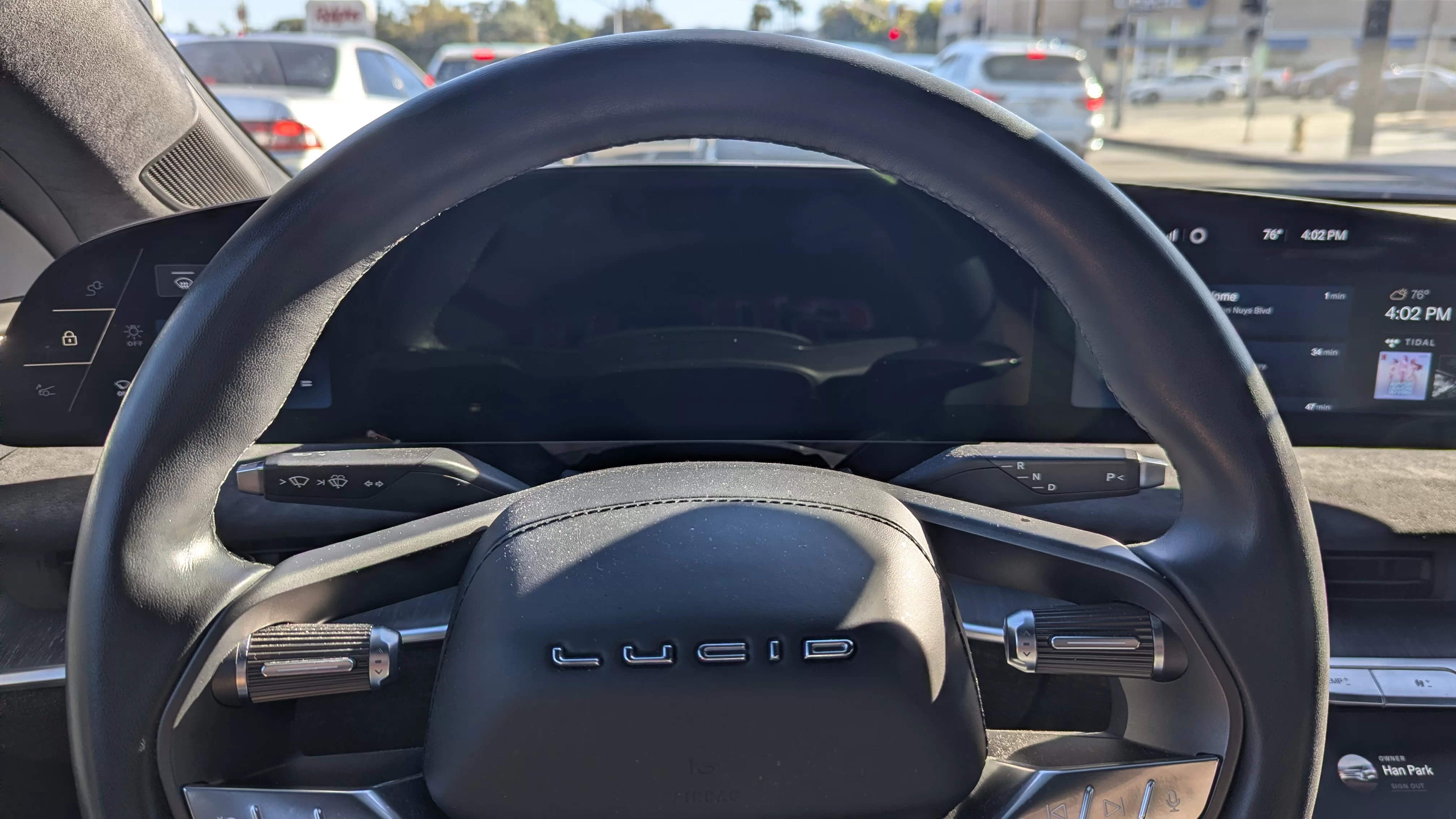

Mine failed to install also. Two days ago, my pilot panel and the right side of my main display went blank. Reboot did not help. Support pushed the update 2.8.7 with the hope it would fix the display. They are now analyzing the issue and I'm waiting for the next step. This is the first time I've experienced any problems like this. My car is a 2023 Air Pure AWD with DDP.

I had the same message a couple of times after installing 2.8.5. Then the screens went dead. I'm of the belief this is all software related and hopefully they will resolve it soon. Thankfully, my car is still drivable.

Also applied to my ‘23 touring and on first drive, within a few miles, saw the screen go dark while driving, though had I not been looking I would not have noticed (Ie, no change to driving dynamics). Pulled over, hit Park, and everything back to normal? No surprises since and will say m/kw actually seems to be up - on that first drive I was at 4.2!
