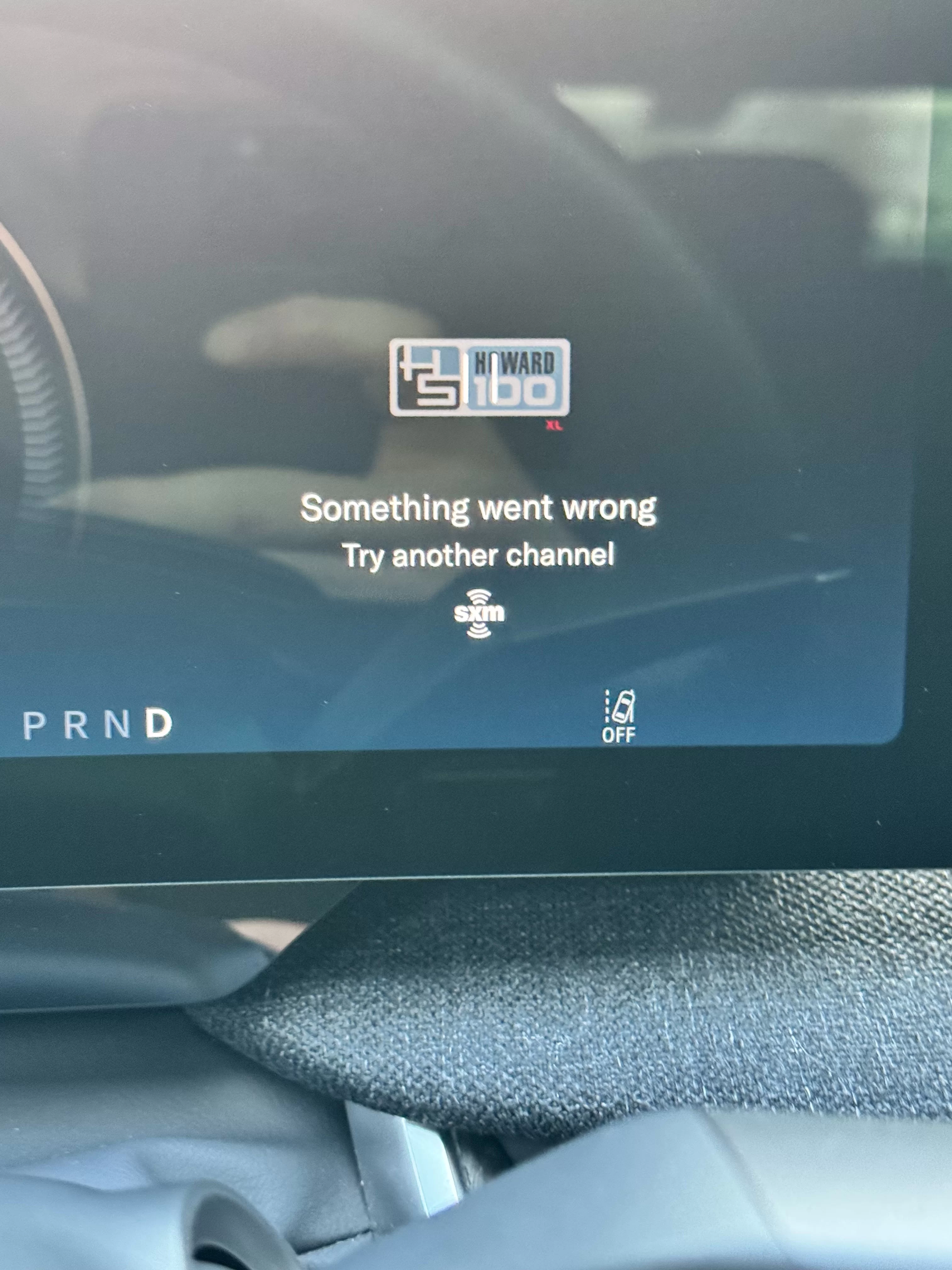

Sirius Radio played on my drive home, and when I pulled into my home garage with wi-fi on. Next morning (3/16/25) it said no or slow internet and would not play when I drove away, nor my entire drive. I did not reset it since I wanted to see what would happen over time. It stayed broken no matter where I drove.
Before I did a reset, I tried turning off wi-fi, and switching stations. It did nothing.
March 18, 2025
Sirius had not come back in several days of local driving. I parked in front of house (wi-fi off), did 2 button + brake reset, and it came back immediately. It had not lost my favorites.
My working hypothesis is that the cell data modem has a poor recovery mechanism from a fade. It must be manually rebooted to re-acquire the Sirius stream.
