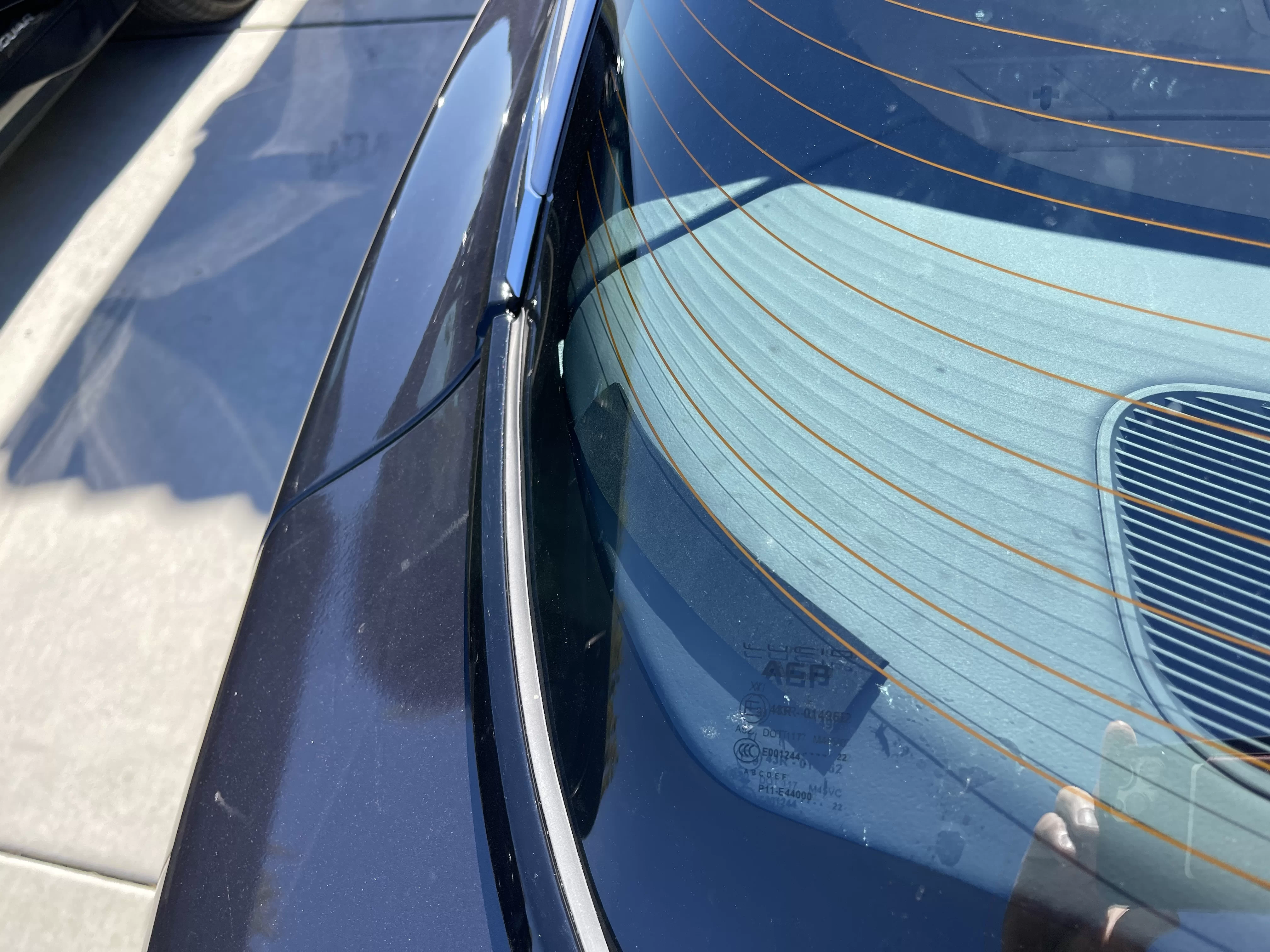

Here are some pictures. The right rear window has the cracks and is about where the creaking noise seems to be coming from. The creaking was noticeable since the day I purchased the car (10/14/22). The crack I only noticed a few days ago. The other picture is of the same location on the left rear. Notice how misaligned the meeting of the truck lid and rear quarter panel is. My opinion is the entire back end of the car is not properly fit together.
Personally, I think the creak might be a different issue from the window cracking. The entire trunk of your car seems like need to be adjusted. Really sorry to see issue like this. I hope it's not common. So far, my Air only has creaky steering wheel, which is known issue. Service will fix it a couple of month later.
I’m not sure it’s the trunk, the creek seems to arise on the inside.

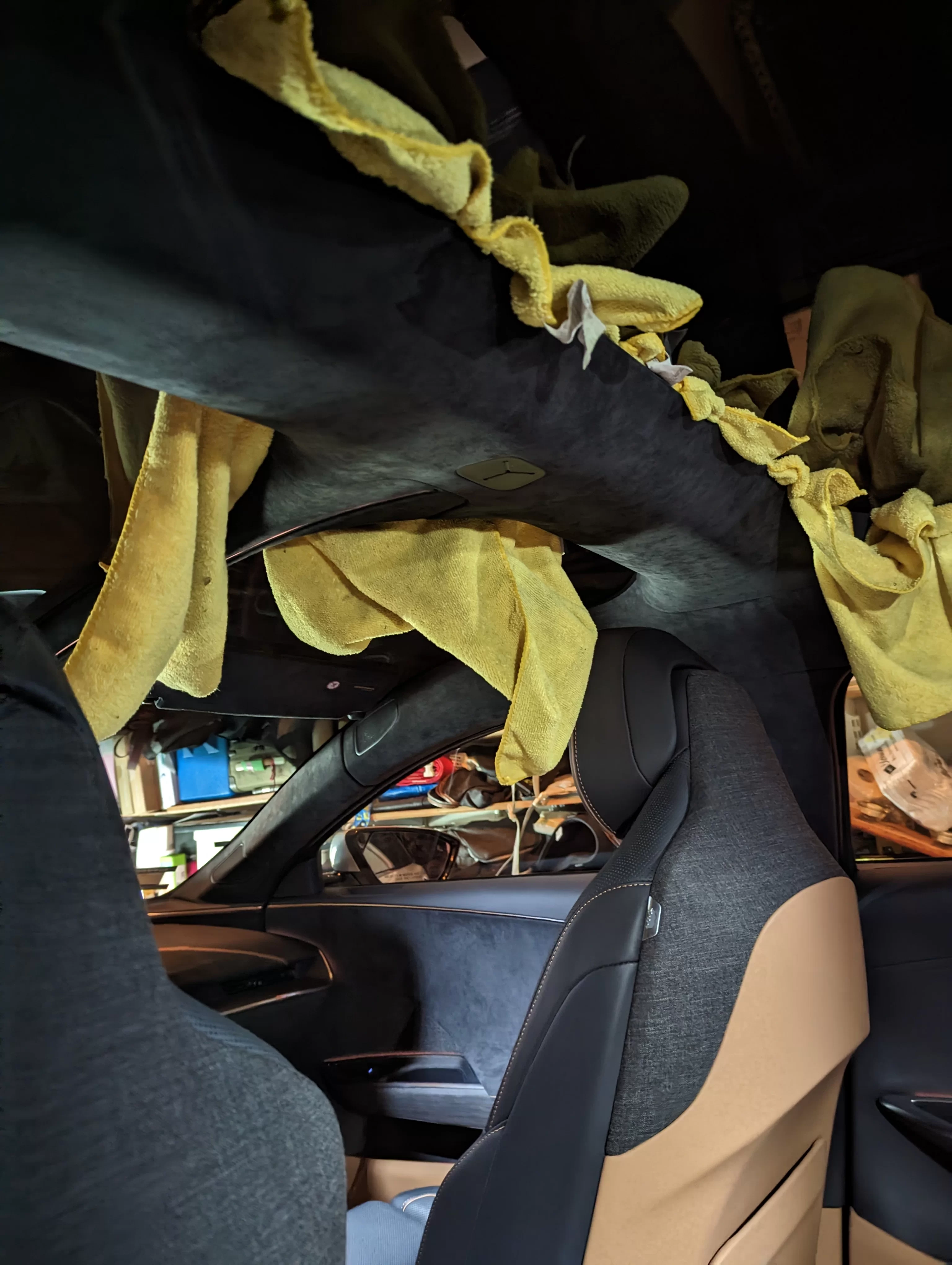

I think the noise.also comes from the roof cross bar. Thought it was just me so I took it on as a DIY project. This and some clothes at the rear deck have the noise 90% resolved.
OMG, I had no idea noise can come from the cross bar. When did you take your delivery?
Delivery 4 months/2400miles ago. The rags are not pushed in under pressure just enough to fill the empty spaces. I also found the trim above the rear window was loose so I pushed that in place pretty aggressively to make sue all the Velcro was engaged.
Looks like the noise was not from the roof cross bar . When I did this DIY repair I did not put anything at the passenger side rear deck because it had previously been fixed by Lucid service.
I purchased some scuba neoprene fabric at Joanns and put that at both corners of the rear deck. The creak seems to be gone. The scuba neoprene fabric feels like very thick spandex, not neoprene. I am headed out for a 250 mile road trip today and will report results of the fix later today
Just returned from 350 mile road trip, CA25, Jolon, Carmel Valley Rd NOT A SINGLE creak , rattle , creak or squeak! Bobby Foam rules!
