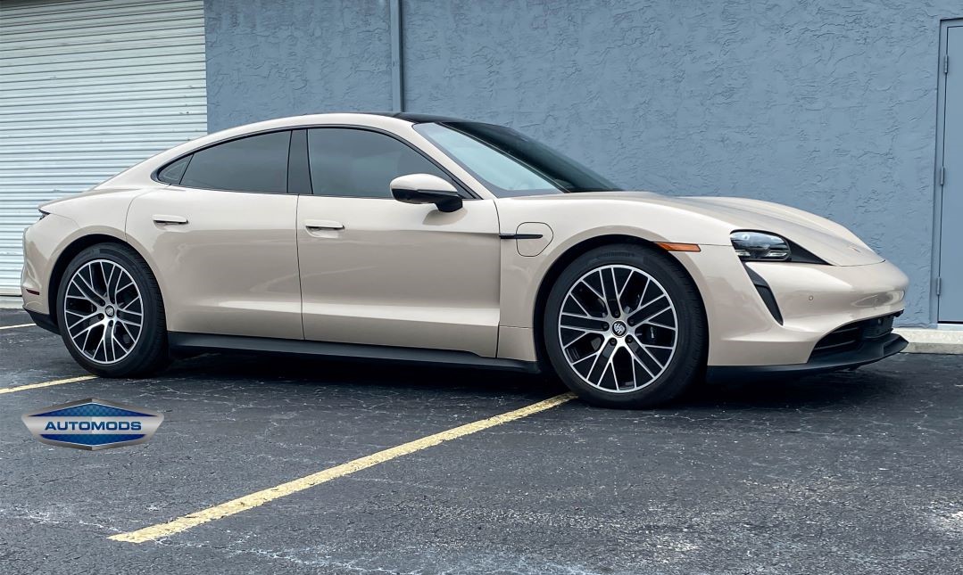

I am taking delivery of an Air GT next week and I am installing the system that I have removed from my Taycan.
does anyone else have any counter measures installed?
I plan on being able to drive this car a bit more spirited because the range is larger and I can waste range with faster driving. having counter measures IMHO is important.
here is a vid of what I had installed on the taycan
That is extremely impressive from an installation standpoint. For the ultimate stroke of irony, you could custom-mount the radar jammers into 11-99 Foundation frames.
