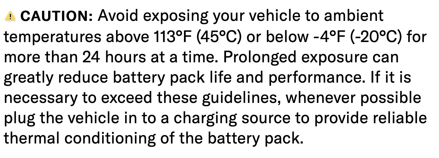

This is a concern here in Phoenix also. From the manual:

I doubt the BMS will start cooling the batteries if the car is parked and the battery pack is at or below 140 degrees F.
