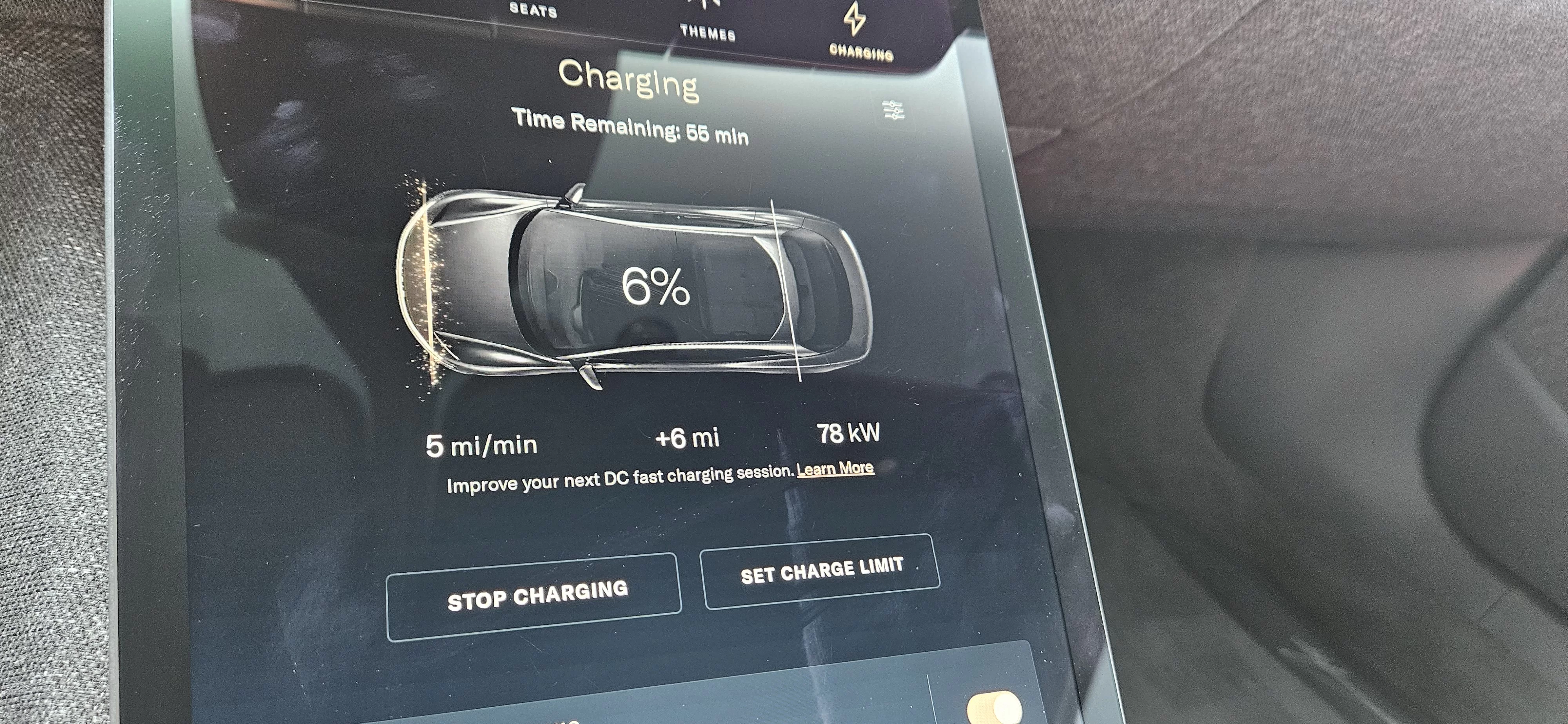

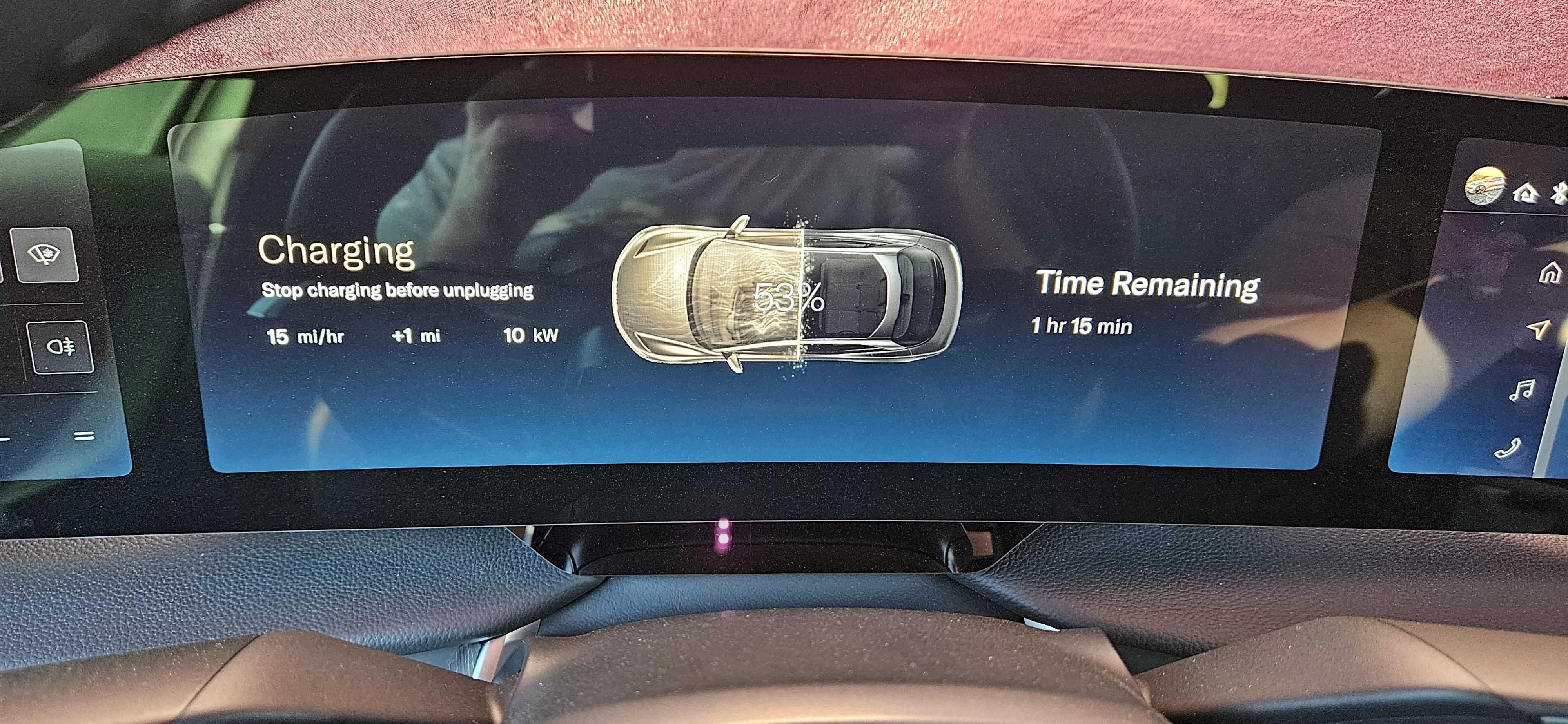

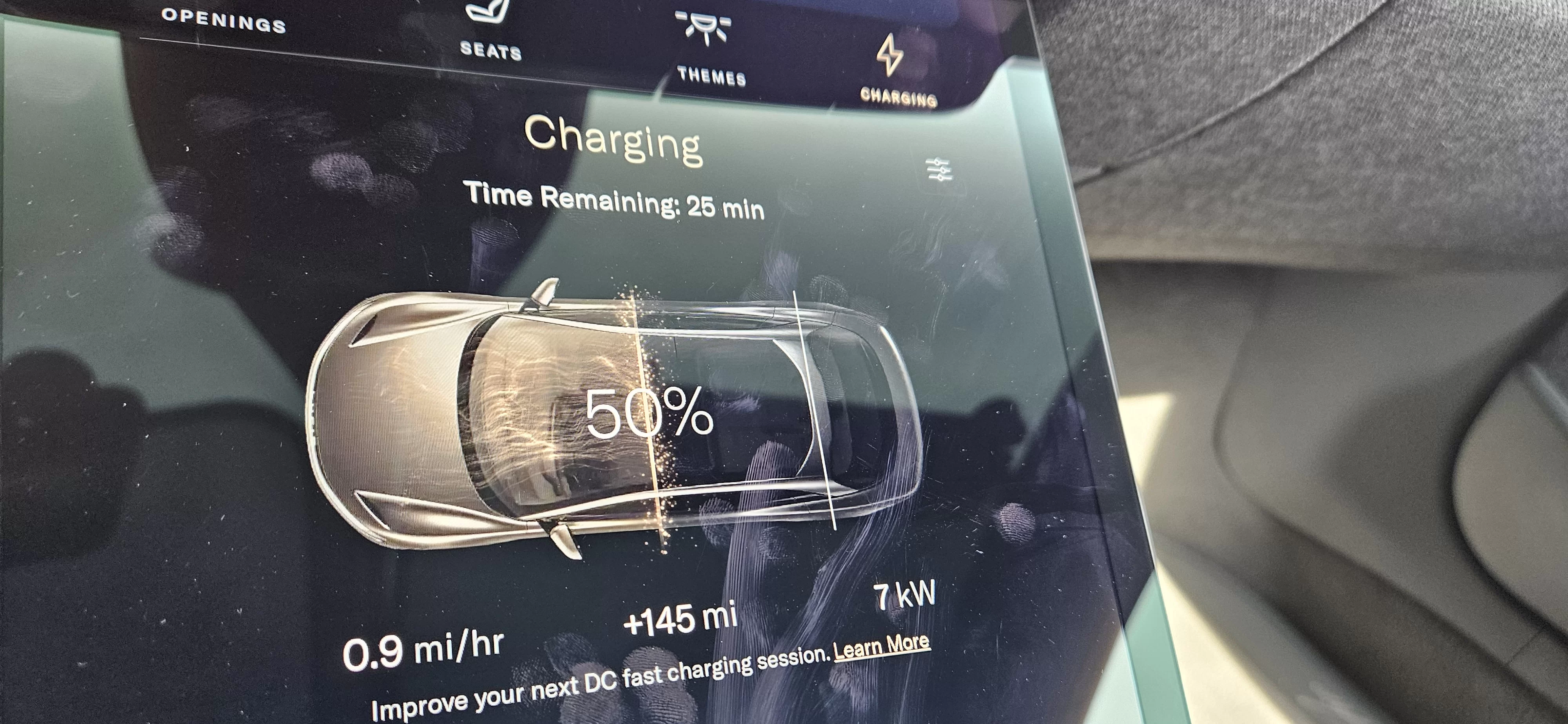

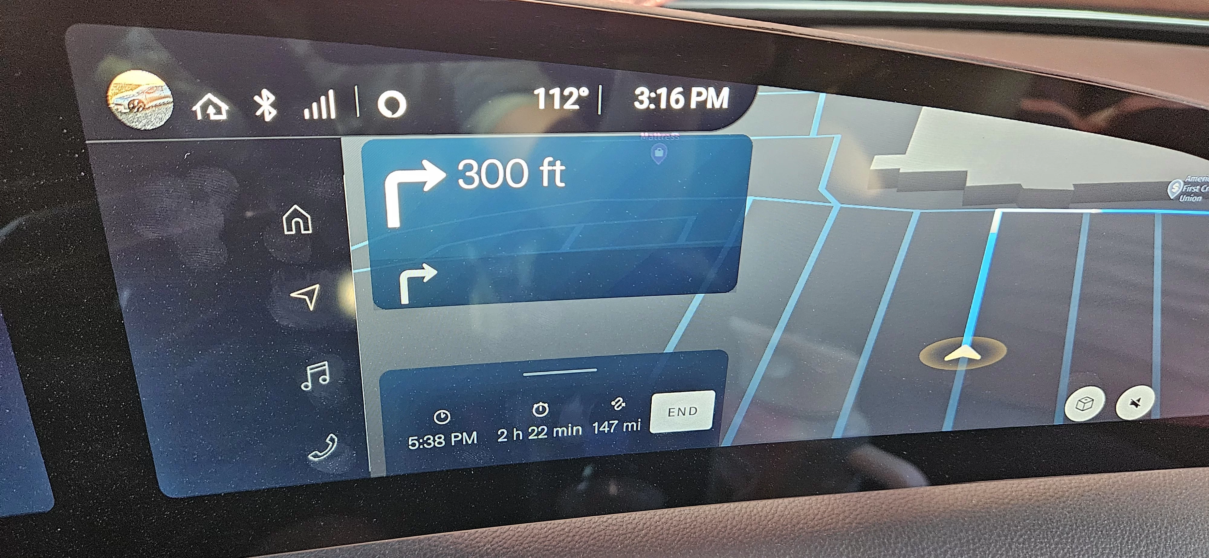

Hello forum friends,
I've been seeing some new/worrisome fast charging behavior a handful of times with my car over the past week. While charging at a few different 150 kW or 350 kW Electify America stations speeds would sharply drop from 125-150 kW down to less than 10 kW around 40-50% SoC. In each instance temperatures were about 105F or higher. Charging speeds did not seem to recover even after waiting for a few minutes and/or shutting off the air conditioning.
Has anyone else encountered this kind of charging behavior in extreme heat? I did not encounter anything like this last summer, that I recall. My theory is that the battery pack is overheating and the BMS is throttling the charging speed to protect itself. Perhaps something in the software has changed? Or perhaps it is and issue isolated to my own car, or even an issue with these specific chargers?
I've not seen any error messages or prompts that charging speed is limited by the station during these occurrences. I have not currently reached out to Lucid about the situation. Any thoughts or insights would be greatly appreciated. Thanks and all the best!

The same thing happened to me this week in Columbus, Texas on a road trip. On Monday it happened at station #4, so I waited a few minutes and moved to #3 with the same result. On the way home yesterday, I had to use the 150KW station #1 because, of course, a Bolt was at the 350KW station! Same thing happened on 3 different chargers at that location. It was sunny about about 95. My GT has 21" wheels so 80% charge is about 370 miles. I wasn't able to get past 320-330 miles before it went down to less than 100 miles/hour charging rate. Since it happened at 3 different locations on different days, I was thinking it was the car. But EA certainly has enough problems that they could also be causing this. Good to know it's not just my car.

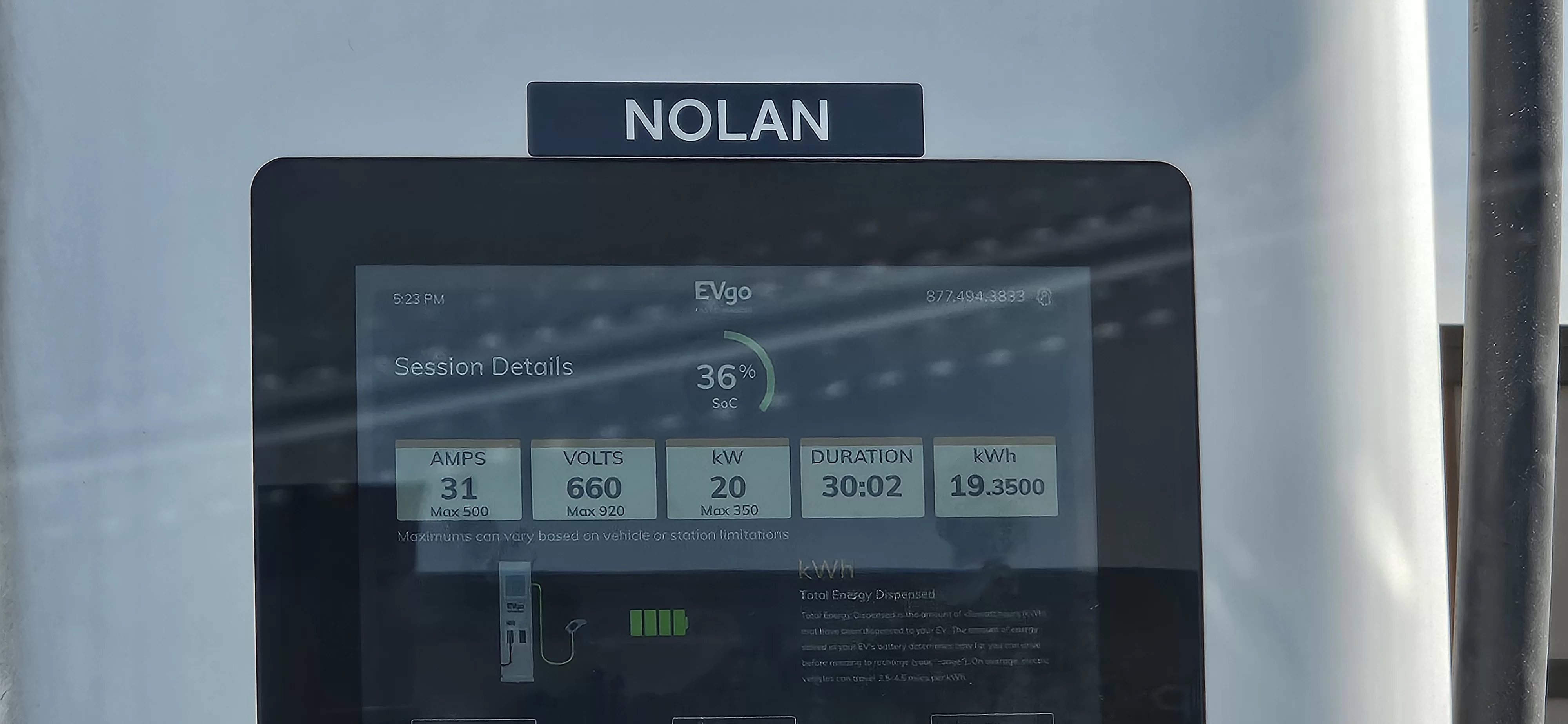

I was able to reproduce this again charging in 100F+ temperatures yesterday. I arrived at the EA station in Loveland, CO around 10% SoC with outside temperatures right at 100F. Right around 50% SoC and ~15 minutes of charging speeds plummeted to sub 10 kW. Luckily the station was empty and I was able to try out the other 3 chargers at the station to see if that made any difference. I did note that the handle I was using initially was very hot to the touch. Unfortunately, I saw similar speeds straight away on all 3 of the other units. Speeds did seem to recover slightly up to around 30-40 kW, but still significantly slower than normal.
While charging at the same location with similar temperatures today I still saw some decreased speeds a bit higher in the charging curve, but not quite as drastic. I arrived around 30% SoC and saw normal speeds up until around 60% SoC after about 20 minutes of charging. Speeds dropped and wandered between 30-50 kW, which is roughly half of what I understand is the normal charging curve. I charged up to about 70% SoC before unplugging.
Hopefully I'll be able to collect some more data tomorrow, as temperatures should be almost as high. Based on what I've been seeing in these instances i believe the car is restricting charging speeds and not the charging equipment. I'm still unsure if this is normal behavior or not, but it's certainly different from my experiences charging last summer.

Over the past few weeks I collected some more data at home here in SLC, UT, and I wanted to share it here. I also notified Lucid a few weeks ago with no real response as of yet. I apologize for the length of this post, but I want to include as much detail and context as I can. Let's get into it!
My goal with each of these tests was to determine how high ambient temperatures and a warm battery affect fast charging speeds with my car. The cases in which I've seen these poor charging speeds circumstantially were after several hours of driving in temperatures of 95F+ and after 2-3 fast charging sessions, and I wanted to see if I could replicate these scenarios reliably. For each of these tests my car was left outside in the sun from about 7am to 3pm, with interior temperatures reaching 120-130F before getting into the car. I would then spend at least 30 minutes preconditioning the battery for fast charging as well as driving the car up the nearby canyon in Sprint mode in attempt to add heat to the battery/drivetrain, followed by descending the canyon in Smooth mode while utilizing as much regen as possible. Distance travelled from the parking space, to the top of the canyon, and back down to the charger was between 15-25 miles with about 1000 feet of elevation gain and then loss. For the first test the battery was preconditioned for about 30 minutes, with the last two being a minimum of 45 minutes. Ambient temperatures for each were around 98F, +/- a few degrees.
Test #1 - July 24th, 2024 - Electify America in Millcreek, UT
After following the pre-testing procedure above, I arrived at the station with 6% SoC and the car reading an ambient temperature of 102F. Charing speeds peaked at 78 kW. After about 5 minutes of charging with no improvements in speeds seen, I tried 2 of the other 3 chargers at the site to verify it wasn't a charger-specific issue. At this point I decided to unplug the car to let it sit and precondition for an additional 20 minutes before charging again. After doing this I reached a peak charging speed of 175 kW at 14% SoC. Speeds held relatively steady until 45% SoC, when speeds began to drop sharply, eventually going below 10 kW at 50% SoC. This continued for 10 minutes before finally ticking over to 51% from 50%. At this point I swapped chargers again just in case the charging cable/handle was overheating and limiting speeds. Speeds peaked at 15-20 kW. Over the next few minutes speeds did slightly recover, reaching up to around 80 kW, before dropping again to 25 kW at 67% SoC. Charging time from 6-50% was a little over 30 minutes, and another 30 minutes to go from 50% SoC to 67% SoC. During this test I was the only one charging, save for the last 15 minutes or so when an Ioniq 5 plugged into the opposite pair of chargers and was getting 240 kW at 40% SoC.

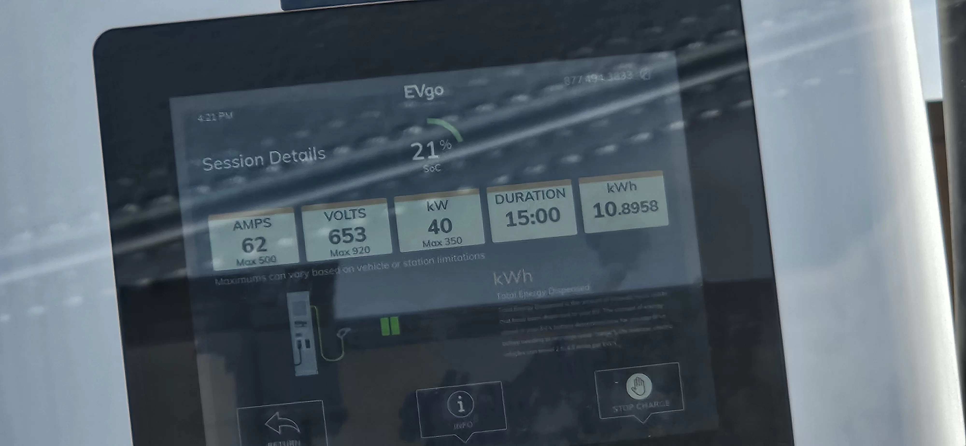

Test #2 - August 2nd, 2024 - EVgo in West Valley City, UT
I followed the same pre-testing routine as before, this time adding 30 minutes of preconditioning time via the mobile app before getting into the car. I arrived at the station with 6% SoC and the car reading an ambient temperature of 103F. Initial speed was around 35 kW. After a couple of minutes I swapped to the other functional 350 kW unit and peaked around 45 kW at 10% SoC. After 15 minutes of charging I only reached 21% SoC. At this point I unplugged the car and let it sit and precondition for 30 minutes before resuming charging to see if speeds would improve. With this new session speeds peaked at 58 kW at 17% SoC. I remained on this charger for the next 30 minutes, as speeds steadily decreased to 20kW at 36% SoC. An Etron and MachE both came and went during this time, each charging at speeds of at least 100 kW. In total I spent a little over 45 minutes to go from 6% to 36% SoC, after losing 4% in between sessions from preconditioning and air conditioning.
