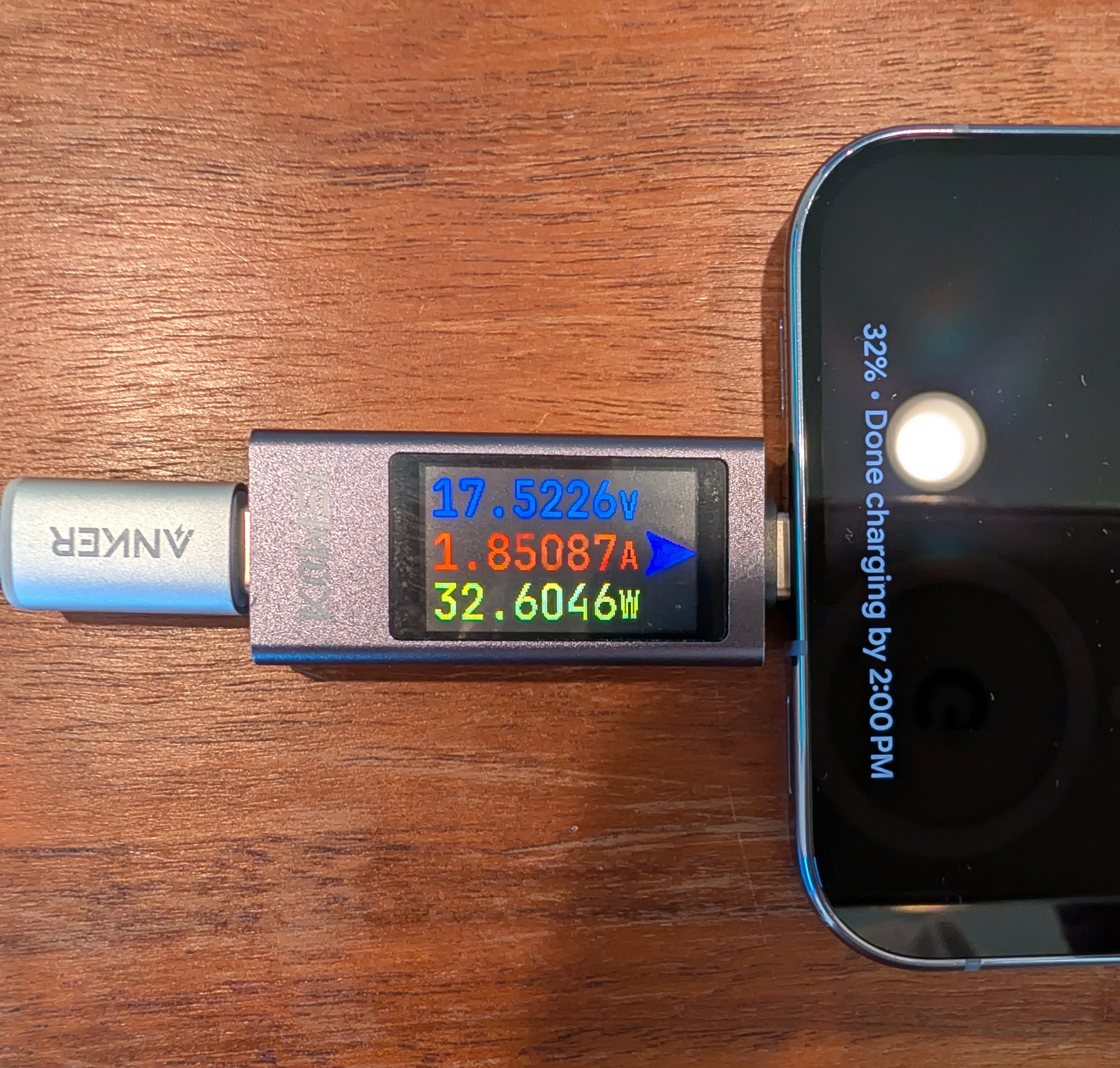

It's fine on a 140 watt charger. Pic below. My wife's Pixel 10 Pro (not XL) has the same problem with our Gravity's console USB ports.Does the Pixel 10 have a problem with higher power ports? The console ports are 100W while the back of the front seats are 45W.
