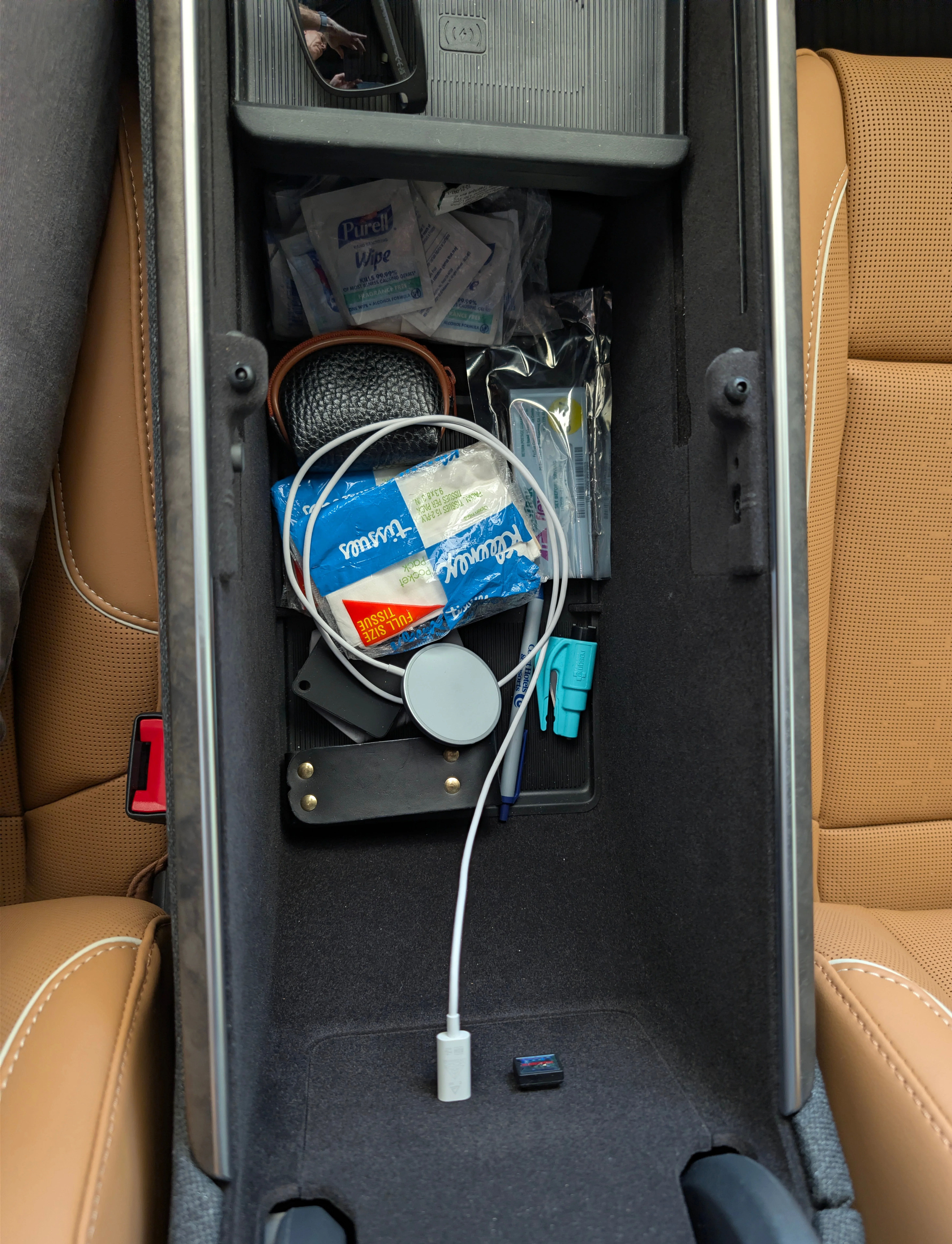

Come to think of it, Google's magnetic Qi 2 puck charges my phone at 25 watts when I plug it into the console USB port. I should just carry one of those in the console instead of a USB A-C cable, which is limited to 10 watts. And there's less risk of damaging the phone or cable if my wife leaves the car without remembering to unplug her phone first.
That charges it reliably? Hmm, might have to pick one up if so.
Yes, at up to 25 watts. It has worked great so far, and doesn't take up much more room in the console than an ordinary USB cable.
