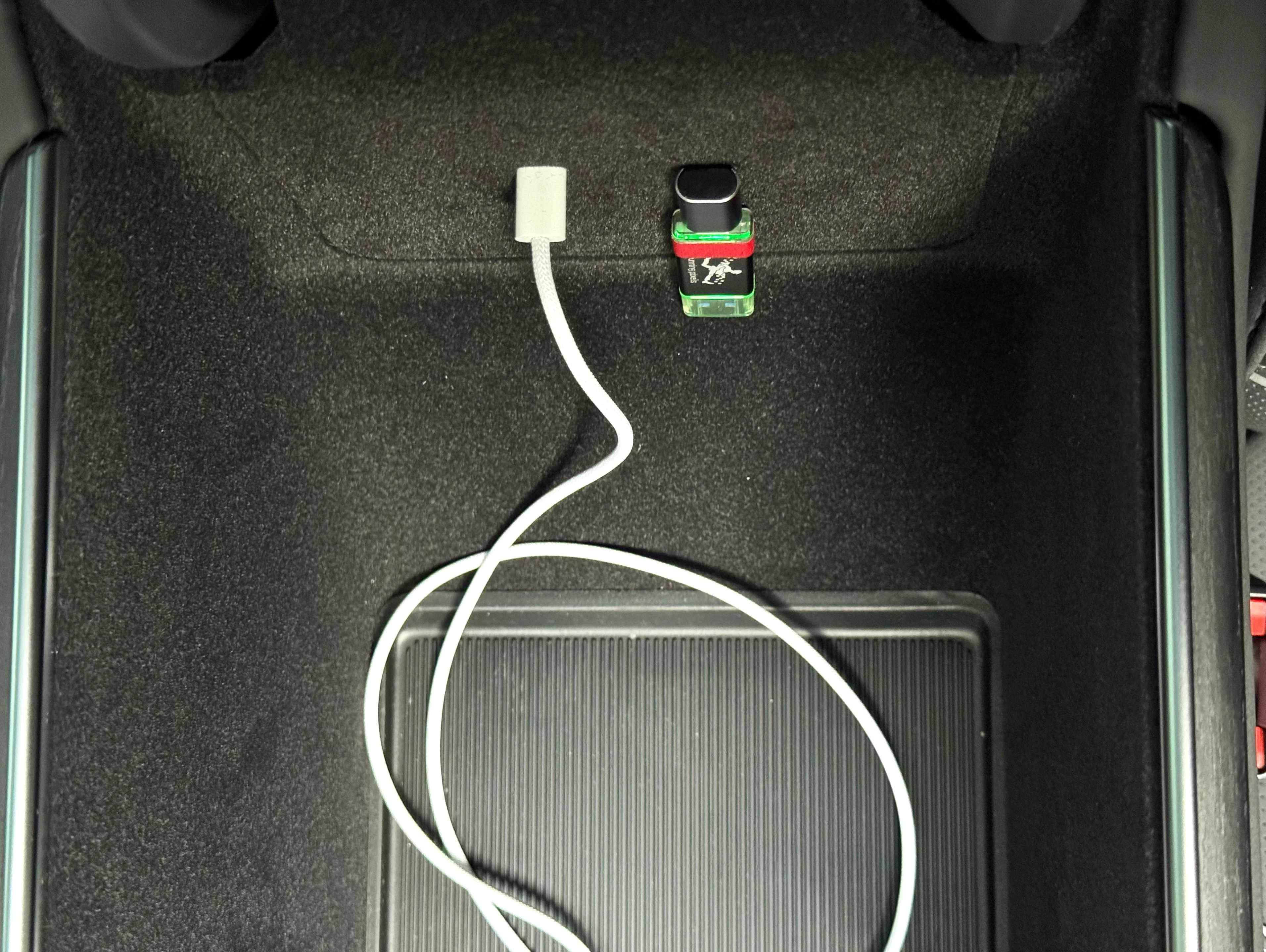

Get a Pixel 11. I'm not a fan of black phones in general, but the matte black is actually pretty nice. Mine pulled 19 watts while already at 80% SOC.
