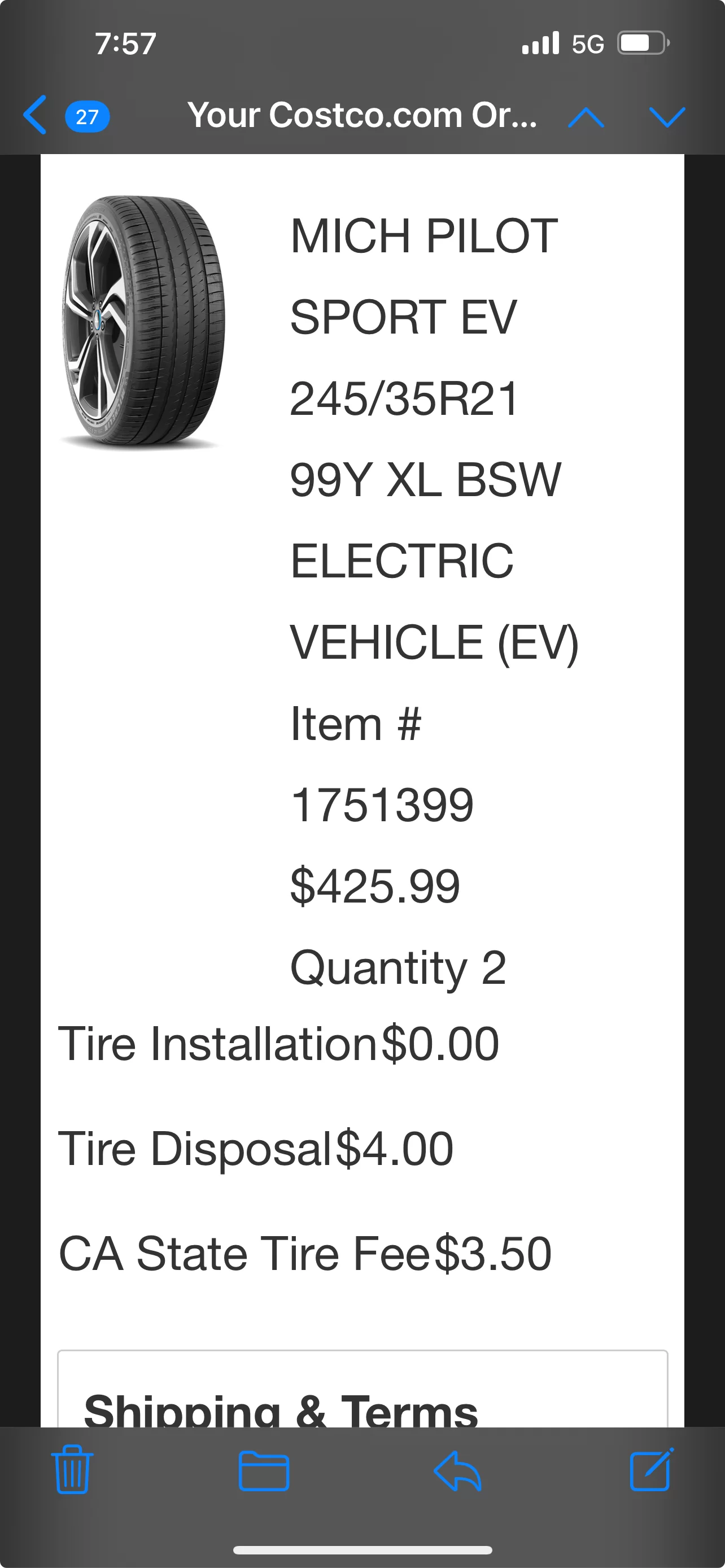

Which Michelin tires did you get for the 21"??
This one:
An XL load index tire can cope with a load capacity of up to 750kg/1650lbs (load index 98) and a HL load index tire a load capacity of up to 825kg/1820lbs (load index 101).
That means that the Michelins will support 680 lbs *less* weight than the Pirellis.
Given the high weight of the car, I would be careful how many people and how much luggage you load into the car on the Michelins.
Love to read the posts of the tire substituters who post here, because they know so much more than car designers and tire experts who came up with the Lucid-exclusive tires. Love reading how / why a six figure car should have not-recommended tires.
Tire load rating index​
Note: You should never replace your tires with a lesser speed and load rating than the original equipment tires.

Its absolutely not to suggest the Michellin's are better; just available. I would have preferred to get the Pirellis had America's Tire, Lucid dealership and Pirelli factory produced a readily available tire. All three said several months wait.

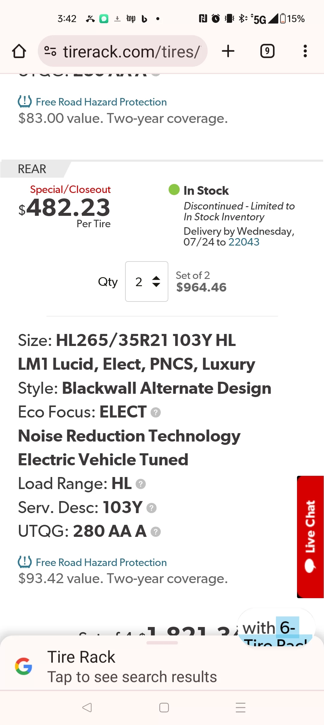

Hey all... First post here after purchasing a used '22 GT a few days ago.
I took the car as-is (of course) and grew a little concerned that there was nothing left of the center thread shallow cuts that I was able to see in online pics. Turns out that's OK; Pirelli has the thread-wear indicators, my purchase had only 11K miles, and there's still a 1/3 of an inch or so before the indicators are going to be flush.
But... Curious about what it was going to cost, I visited the Pirelli site today. Ugh.
It turns out they have the rear 21" tires down as "Discontinued - current inventory only".
I'm not entirely sure what we'll need do when we need a new set and PIrelli isn't making them anymore.
They’re not discontinued. LM1 no longer exists and LM2 is backordered. It’s just a new version.
