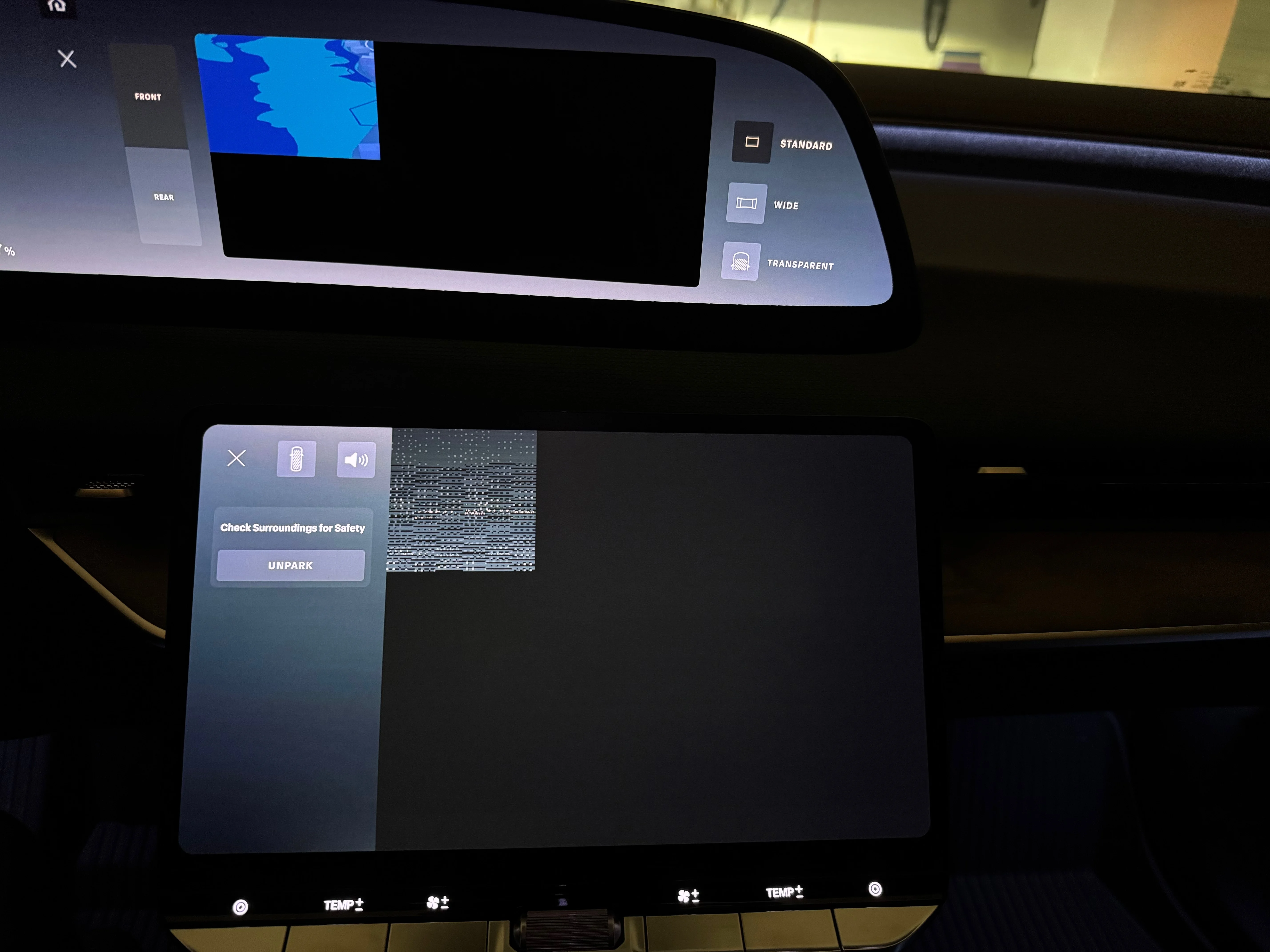

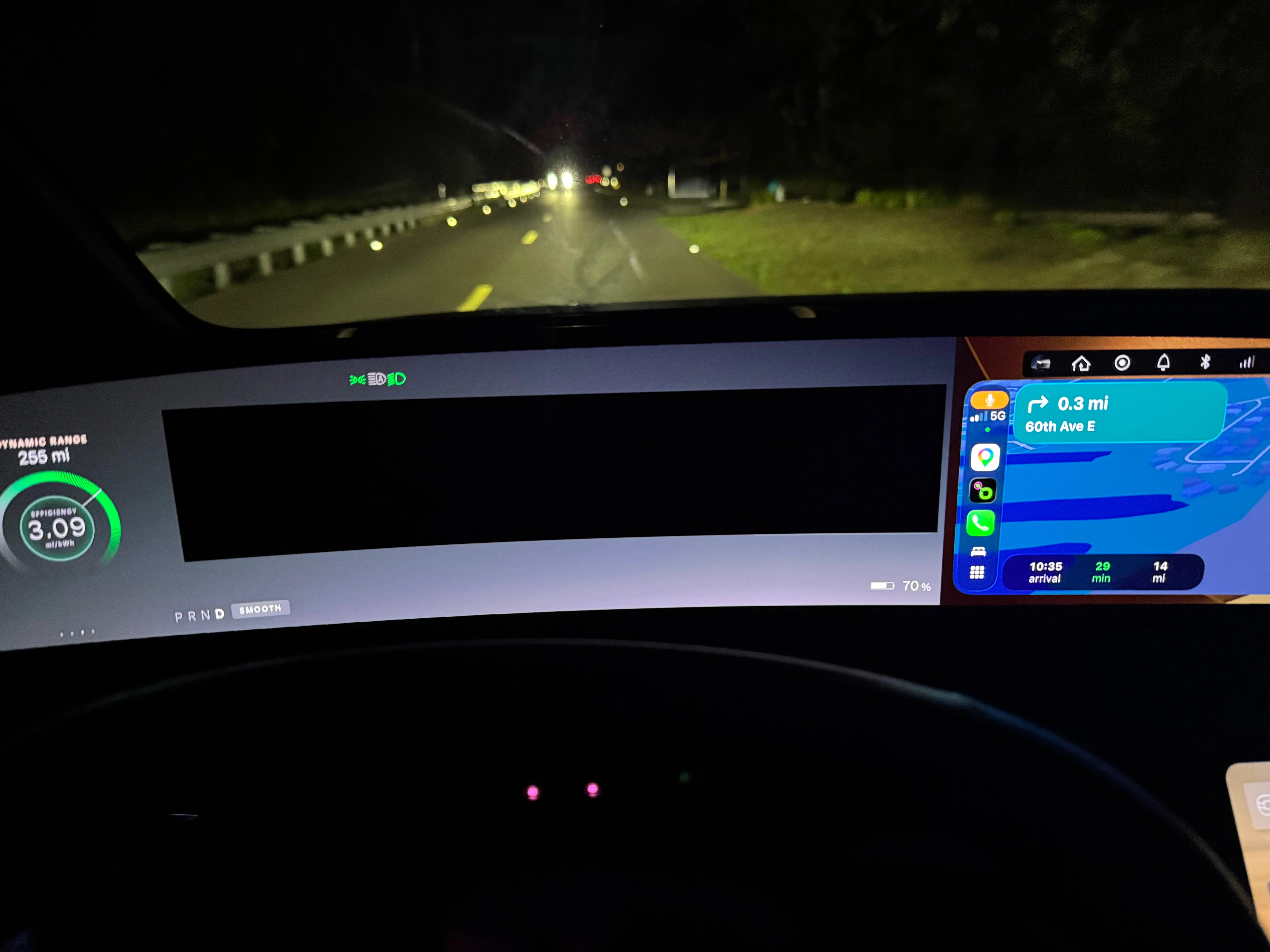

No speed was displayed for my ~30 min drive tonight, plus parking cameras were hosed too. Well, at least Google Maps in CarPlay showed me my speed.
Once home, I did soft reset and the issue seems to fixed itself, but man...that's a bad one.... I just sent emails both to swfeedback and customercare
View attachment 39061View attachment 39062
Wow, that's really messed up. I have never seen that. Looks to me like a cable issue actually, rather than a software one; that looks like when a video cable is loose or similar. I hope I'm wrong.
Well, if video cable was loose then soft recall wouldn't have helped, I think...I don't think it's a cabling issue.
Either way, I am hoping Lucid can pul logs from my vehicle remotely and determine the root cause, as I sent them a very detailed report
