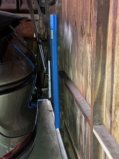

My rear hatch opened in the garage after I parked the car and went into the house. I got notification on the Lucid app that it was open. I found it half-way open pressed against the garage door. Has anyone had this happen to them?
Yup Yup, I am constantly trying to lock or unlock with the fob upside down resulting in door opening if held too long.
I'm an old dog so I installed this kids pool toy on the door. On a California door it looks like it will also prevent damage when closing the garage door without first closing the car trunk. I haven't 'tested" that yet ;)
