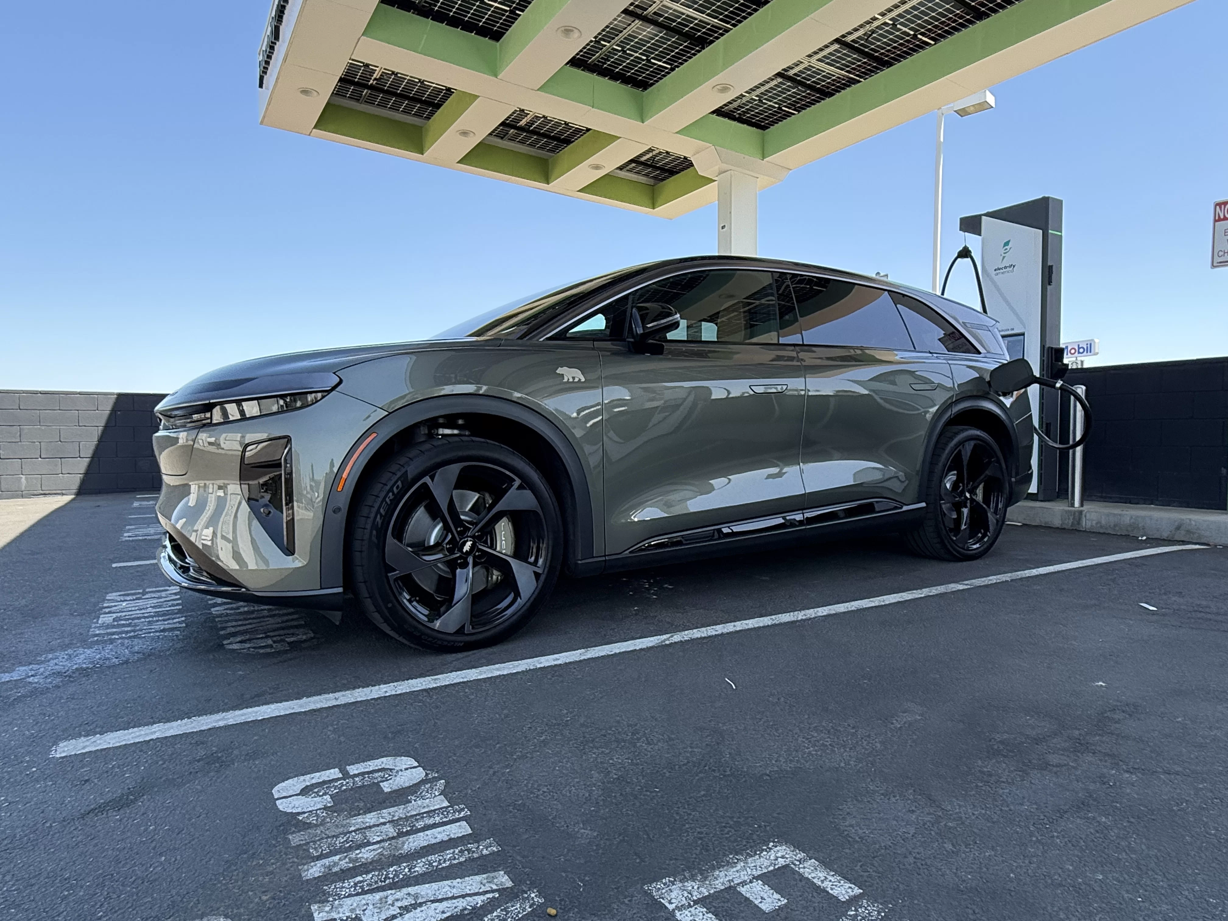

Anyone else having public charging issues? Was at a ChargePoint 125kwh charger and I couldn’t get even close to that with the adapter. Car said charging power was limited by station. Now at a 325k Tesla SC and only getting 31k and again, charging power limited at station.

Not that bad. As Tesla SC, I shot up and then got limited to 150. No limiting at the BP Pulse or EA. I don’t use charge point.
I see this maybe a third of the time, and moving to a different post typically resolves it. More common at non-Tesla SC, but I definitely see it as SC's (and did with my Model X too). I appreciate that the Lucid does indicate if the charge limit is being requested by the EVSE or EV.
