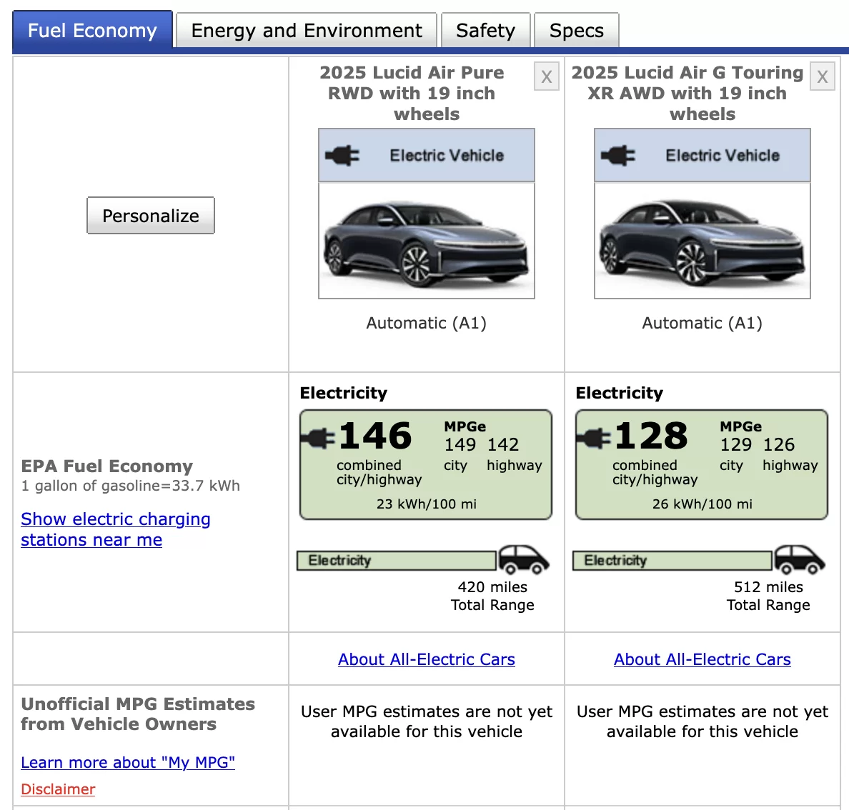

So, does the EPA miles/kWh that appears on EV window stickers include or not include charging losses? Stated differently, does Lucid report in a different manner from everyone else?
The pure on 19in wheels will definitely do 5 mi/kwhr on the EPA drive cycle without charging losses included.
From Car and Driver's explanation of testing their real-world vs EPA.
"That's why there are two terms used: efficiency, which can be expressed in MPGe, includes charging losses, while consumption, the energy use while driving, doesn't include them."
Yes the mileage on the EPA label includes charging losses. The EPA also specifies efficiency on kWhr/100mi.
The Pure has an 84kWhr pack so Lucid calculates the driving efficiency 420 miles of range divided by 84kWhr or 5.0 mi/kWhr
The EPA shows efficiency of 23kWhr/100mi or 4.35 mi/kWhr. The details showing the inclusion of level 2 charging losses are in the testing procedure, not on the label.
Thanks! I understand now! Much appreciated.
