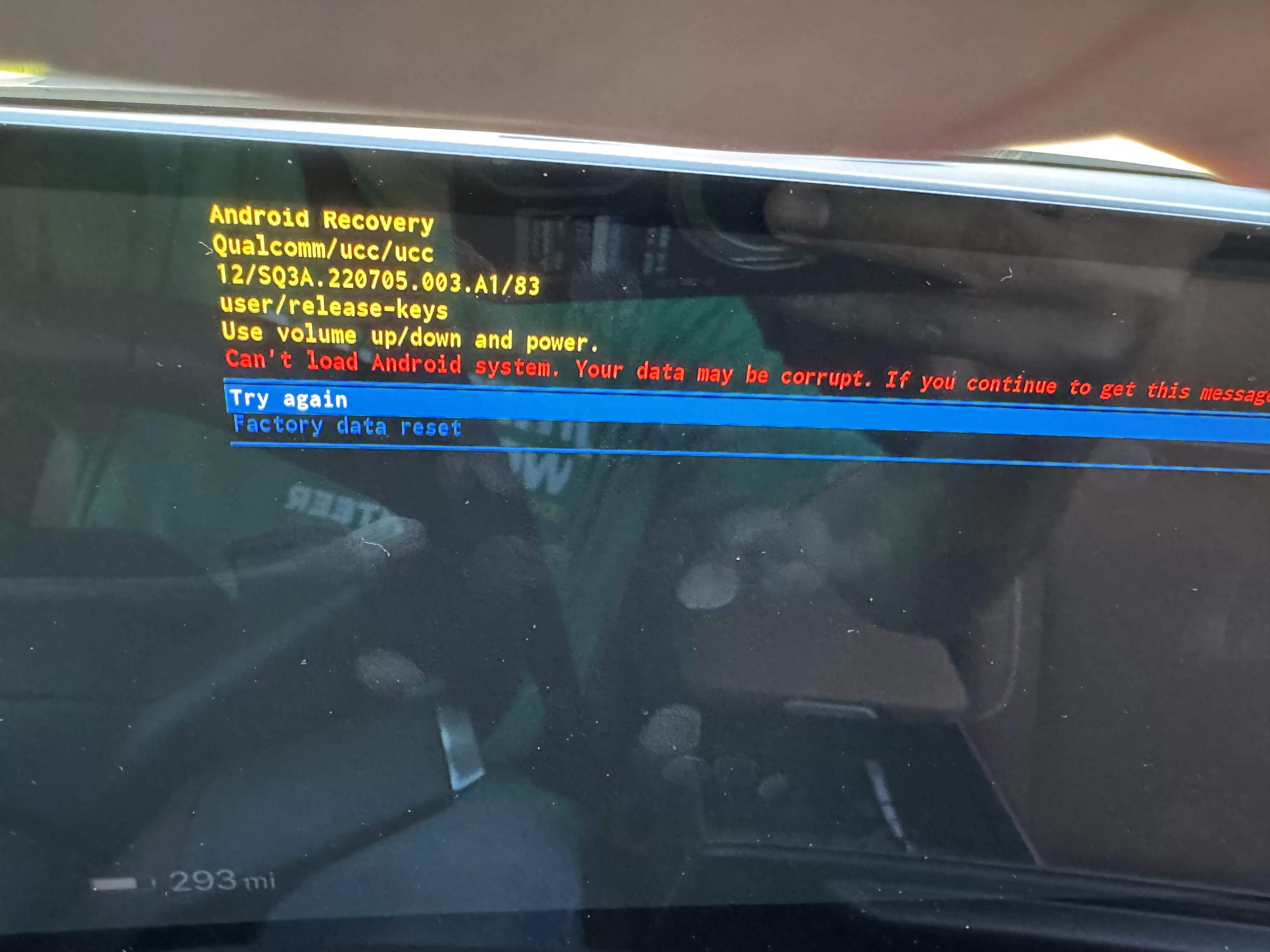

Got in the car in the AM - all screens were blank. Waited 30s.. no change, so rebooted (10s). This time the system didn't come back as expected. Called SC and per their direction I let the system sleep for 10-15 mins. Tried to wake up again and still no dice.
Car is with SC now - they are looking into it.

- FWIW My initial hunch was that when the system reboots, the android system looks for the OS boot drive. So perhaps it was stuck trying to read from the USB drive Im using for Halo Secure. I was unable to confirm this hypothesis since the glove compartment was closed and the screens were off ... I was not able to open it and remove the USB to check.
- However, the SC tried to look up similar incidents and mentioned that this might be a module change (not sure which module). So looks like my hunch was likely wrong.
