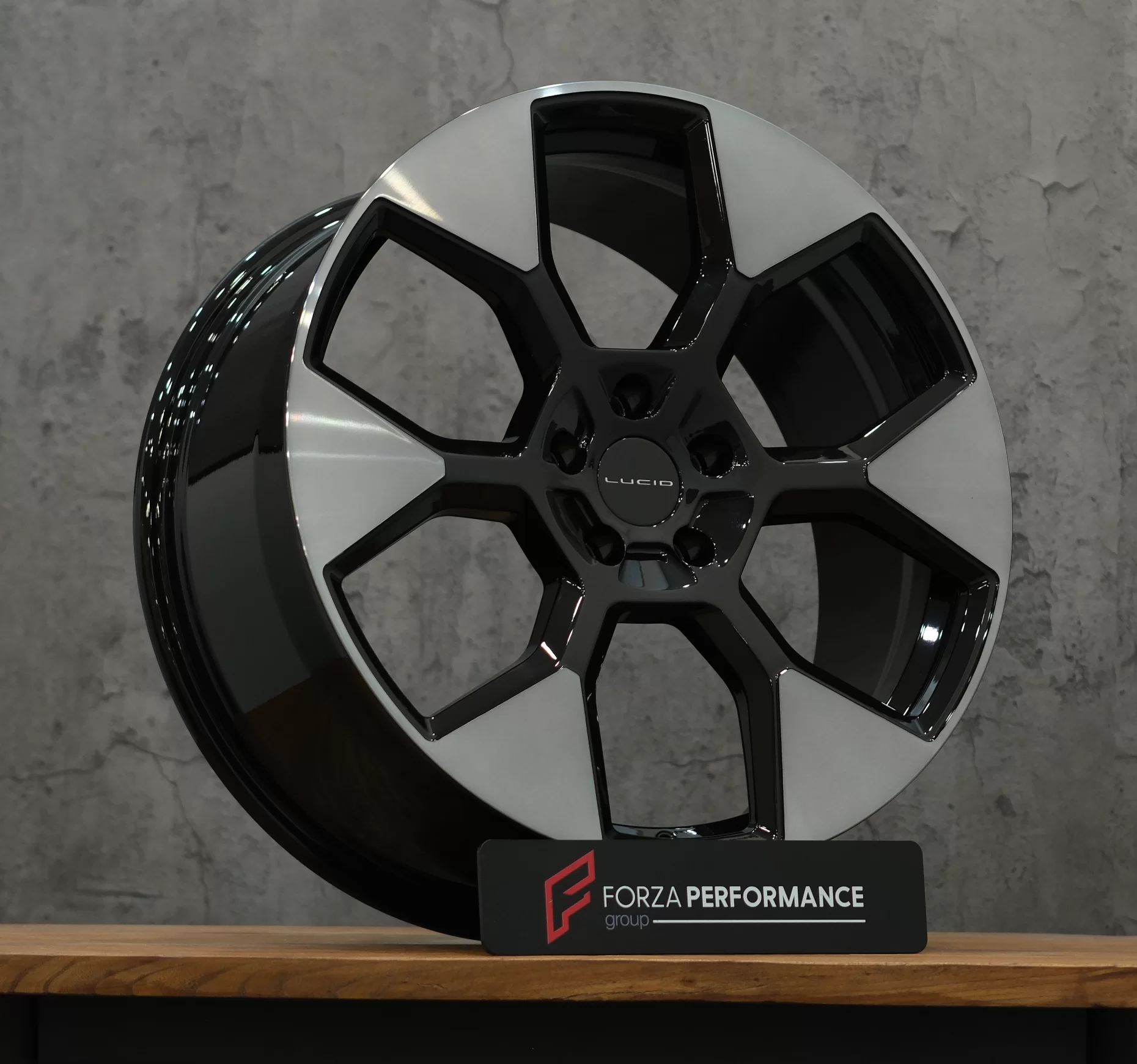

FYI, I received my Lucid Gravity X imitation wheels from Forza Performance in the 20/21 sizes, they have a 1000kg weight rating and everything went smoothly, and the wheels look great. I will share photos once I have tires mounted on them and get them installed in the next couple weeks. They are forged and were $3142 including shipping. The set of Michelin Cross Climate tires installed will be another $2k.
Here's a photo of the rim. View attachment 33955
What’s the weight on these? Did you happen to weigh the stock wheels?
Shoot, no I didn't weigh them. Not sure it's much value to weigh the stock wheels with tires on them, but I can once I get the new ones mounted. I'll see if I can get a weight for the new ones as well.
I will weigh the stock 20/21 this weekend if no one else does, subtracting tire weight is pretty easy and good info for when messing with wheels and tires.
