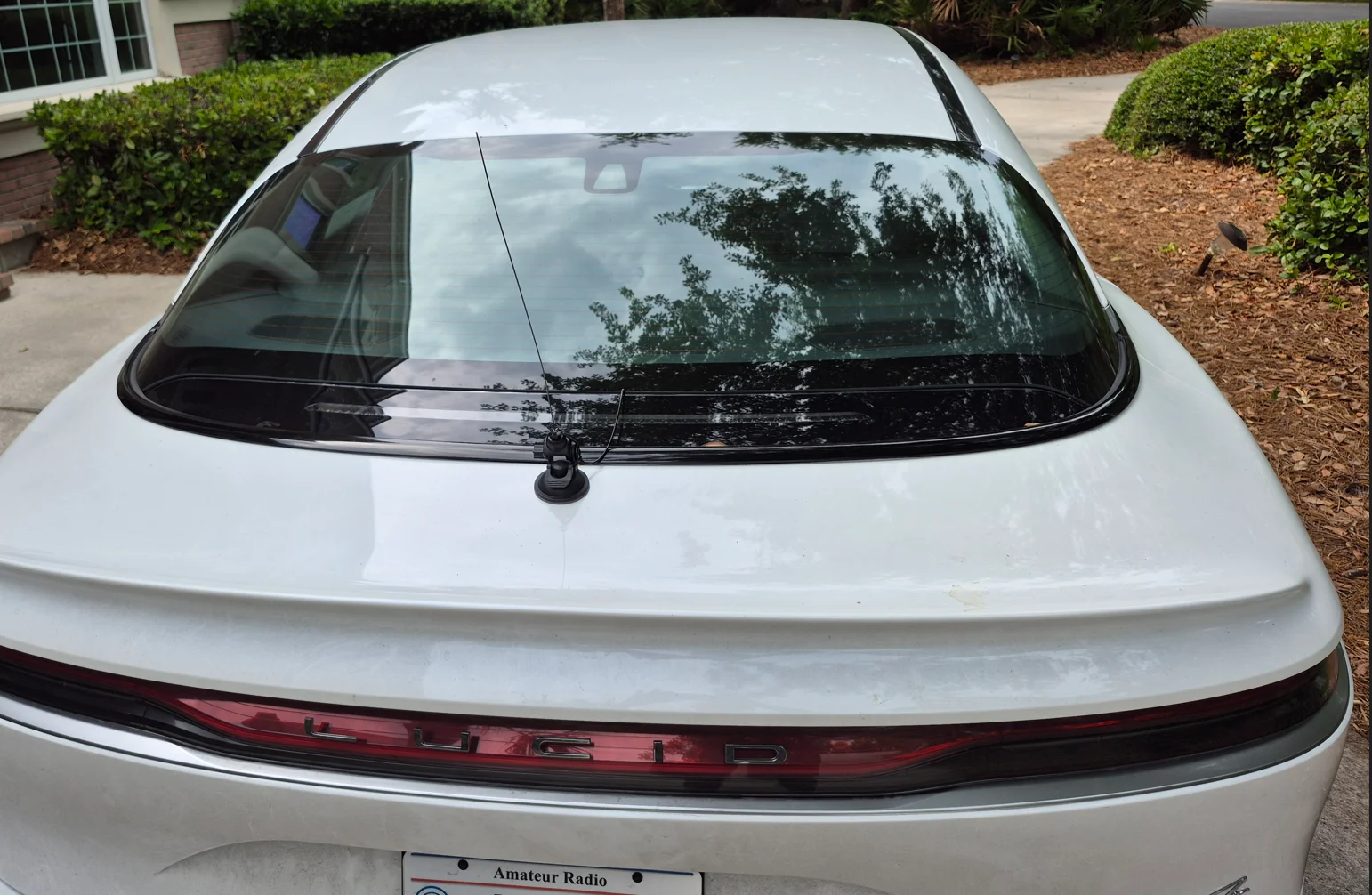

UPDATE - Just received the antenna/mount kit and did a rough, trial installation w/o using the mount's adhesive pad. It fits with an inch to spare below the rubber coaming around the garage door trim. It turns out that when Diamond spec'd the antenna length as 40.2 inches they were including the added height of the mount. But the antenna element is only 38.25 inches long. So um good to go. And the RG316 coax fits perfectly at the corner of the trumk lid without pinching. I'm tied up the next 2-3 days so I won't be able to tackle it as quickly as I'd like. Standby for further.

It hasn't happened yet. Pics planned when I install it in the next coupla days. There wasn’t anything to take a photo of because all I did was park the Air logo below my garage door opening and then hold the mount and antenna in place above the logo to verify that it cleared the overhead coaming.
The mounting plate will need a very subtle bending to be sure it conforms to the slight curvature of the C-pillar. It’s definitely gonna work. Even the coax fits snuggly under the trunk lip without being pinched.

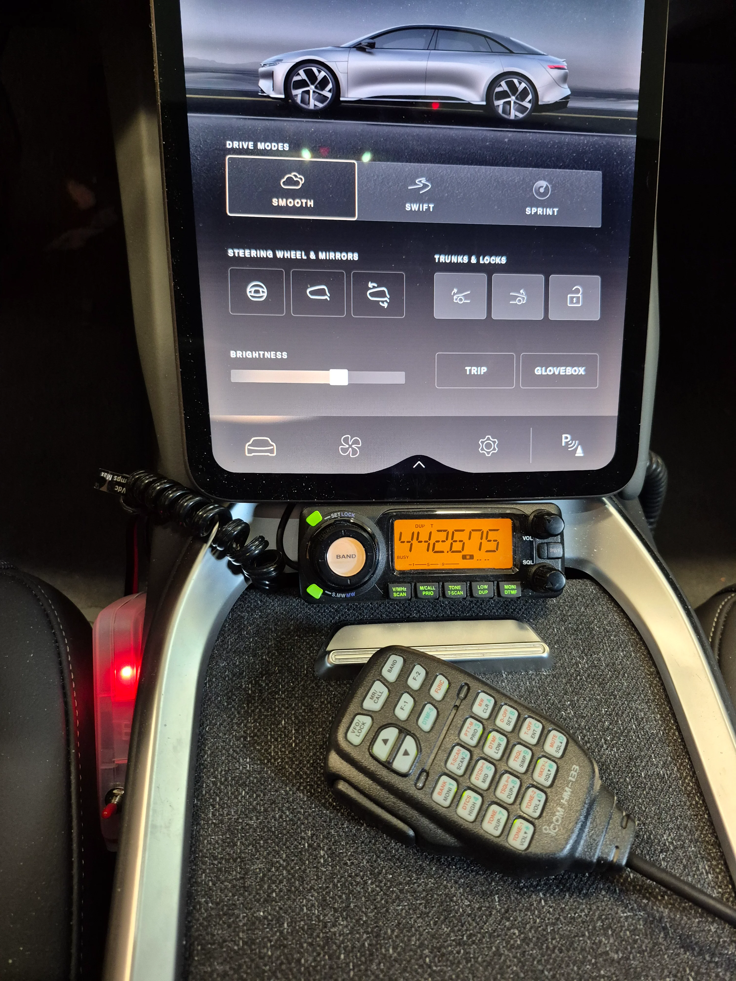

I'm also a ham. I have a 2025 Air PURE. My IC - 208H works well sitting behind the screen, fed with 12V from the trunk. I solved the antenna problem by using a suction cup from an old HP GPS mount. Thin coax is fed through trunk lid seam. All works better than the 6 M Saturn 6 Halo on my 56 Merc. 73
Steve

Looks pretty much like my planned installation except for the antenna placement. I considered using a suction cup mount. Aren't you worried about it coming loose at high speed and scratching your finish?

Glass canopy is only a show stopper if you want to mount your antenna on the roof with a mag mount or drill a hole thru it. Maybe a suction cup mount would work (at least for a while until it blows off) but I'm not sure if the metallic tint will provide a good ground plane. The Diamond antenna that I bought doesn't need a ground plane.
I use the kind of suction cup that has a lever to remove the air. Its fairly reliable and has only come loose once, when I brushed a bush in my driveway. The parts are coated metal or plastic and caused no damage.
Good to know. Can you tell us the model nbr?
