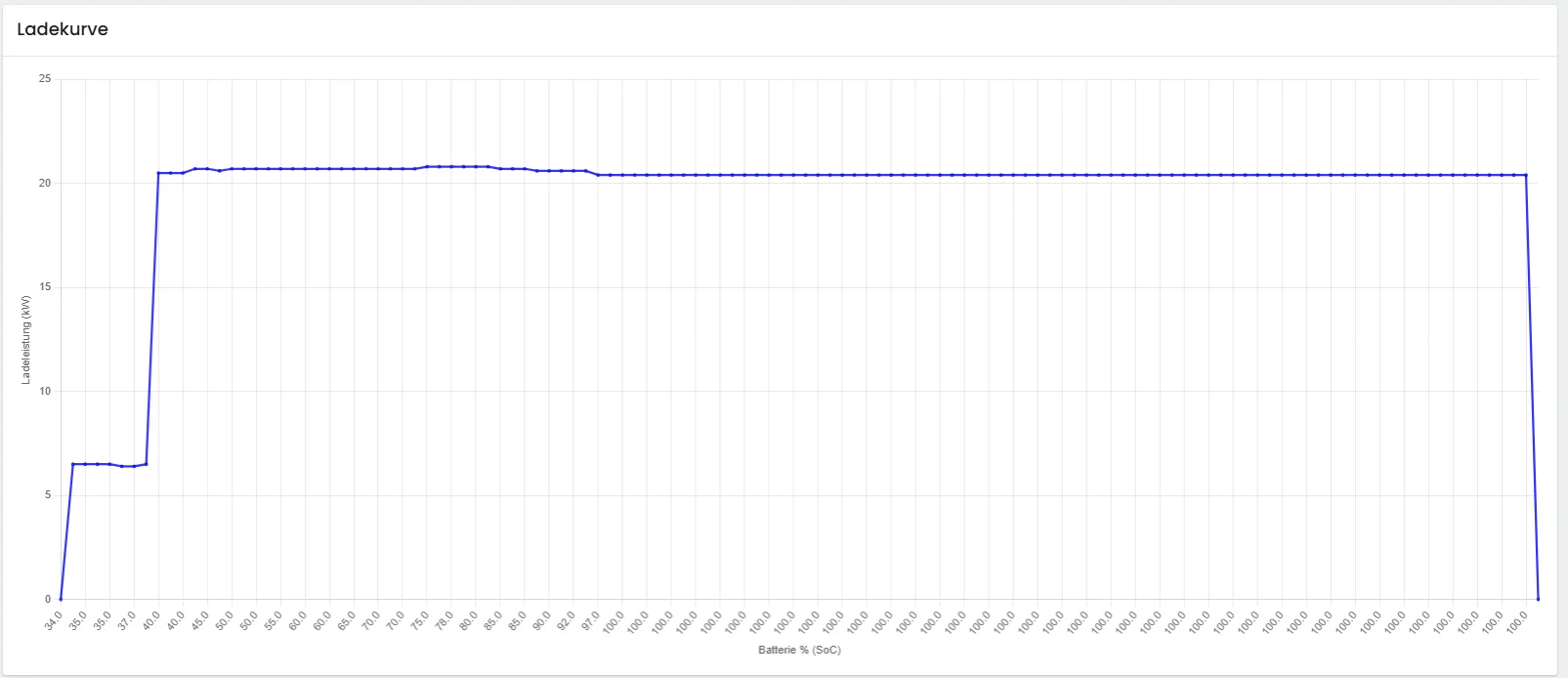

Audi etron sportback 55 (2022 model)
It sure does charge with full speed until 100% with out decreasing the speed.
AC should always without any compromise be at 100% charging speed.
If not, then there is a limit in software usually
Do you have an actual link to the test, or just that highly suspect graphic? Did anyone here besides me notice the bottom scale? Here's a close up:

Yeah, the battery supposedly hits 100% well before halfway through the chart. That means they're claiming the battery is pulling at least 20kW AFTER the battery is already at 100% SOC. And well after considering more than half the chart is taken up with that! It makes no sense (where's all that juice going for so long?) and so I conclude the graph is suspect.
Common Core math, you wouldn't understand.

I use Tronity to track all our 6 evs charging and driving sessions. It is just the graph I have many more. All since we have the Audi since November 2022. Since we have a 85 kwp photovoltaik on our roof we usually have enough power to charge with solar only. So some graphs are below 19 kw because we mostly like using surplus only. However most of the graphs look like this I have also the actual protocol for each charge. So I can show the soc every minute or so and also show the time it took to charge etc. So one can calculate backwards.
Hint: The chart does not have a time scale. It is just showing SoC advancing, but it does not indicate time between each data point. I agree it is a funky view, but there is no indication that the charge was driving 20kW for several more hours after 100%.

Full speed until 100%. It shows data points because the car was not disconnected. Tronity still tracks until the charge is disconnected.
57.09 kWh was charged

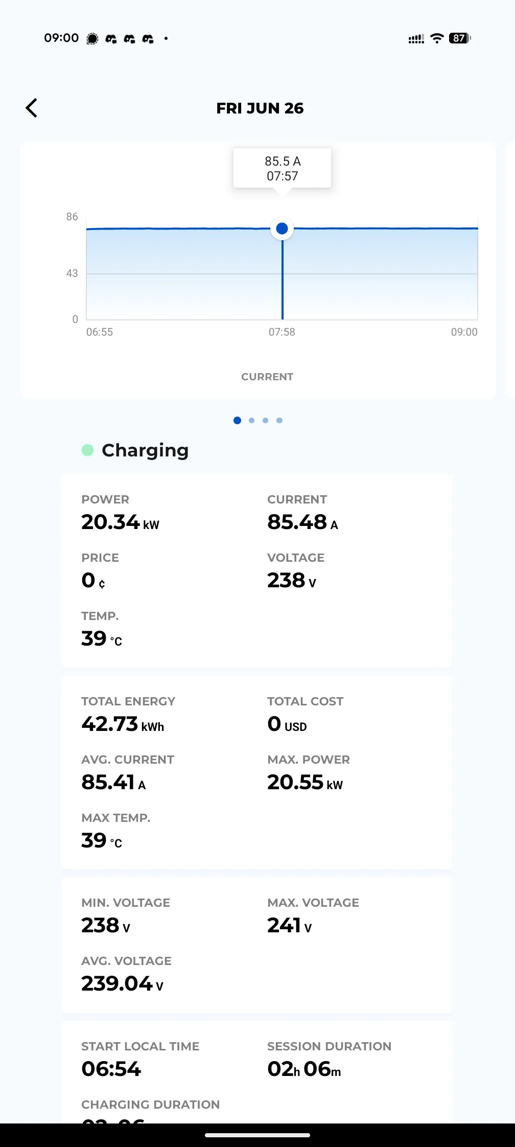

From 55% to 89% holding 85A+.
I think it has something to do with duration. Somewhere around 3 hrs it suddenly will stop taking 19kw
