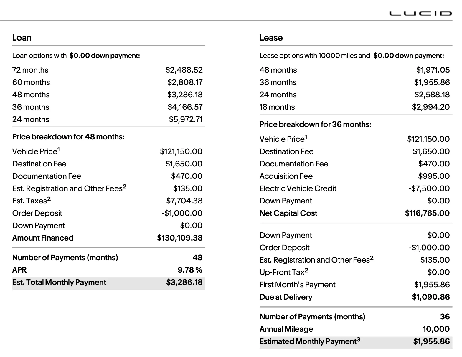

I am struggling on the lease versus buy decision - and it is a little involved
1. Buying car primarily for business travel. Second car is a pre-owned 2023 Air GT we bought (cash) in Q2.
2. Current lease MF is 0.00299 (around 7.16% APR), for 36 months / 10k miles. Residual is $70,671 (from a separate email the rep sent). Sharing lease calls below.
3. Rep mentioned
4. I am able finance via bank at 5.25 - 5.5% (72 months), and overall we do not quality for $7.5k EV credit due to being above AGI.
Is it more prudent to lease or to buy ?

The only reasons I am leasing are:
1) I have bought my past three expensive EVs thinking I’d keep them and then realizing I want the newest tech every 2-3 years - so I can justify lease cost. And two were teslas, so depreciation was extreme as Tesla kept lowering prices. I can sell my R1S today and use the proceeds to lease the Gravity for 36 months and still have some leftover. This is primarily because my R1S was original pricing.
2) Strange anxiety that Lucid BKs within 3 years and I’d rather give the car back to BofA at end of lease versus worry about what else to do with it.
