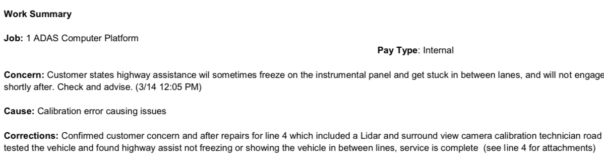

Very, very inconsistent pickup of Drive Assist or Adaptive Cruise Control. Once it starts to work, it seems to work fine, But it often takes a number of tries to get it going. (Possibly hardware)
Hmm, might be hardware. I took mine in for something similar and turned out to be a calibration thing. Covered by warranty:
I’d call service and at least get it diagnosed, take pictures or videos with time stamps within 30 days of the service date. They can pull the log and see what was happening with the computer.
Sounds like it needs calibration. Haven’t seen any other reports of this due to the latest software; worth having service check the ADAS calibration if it keeps happening.
