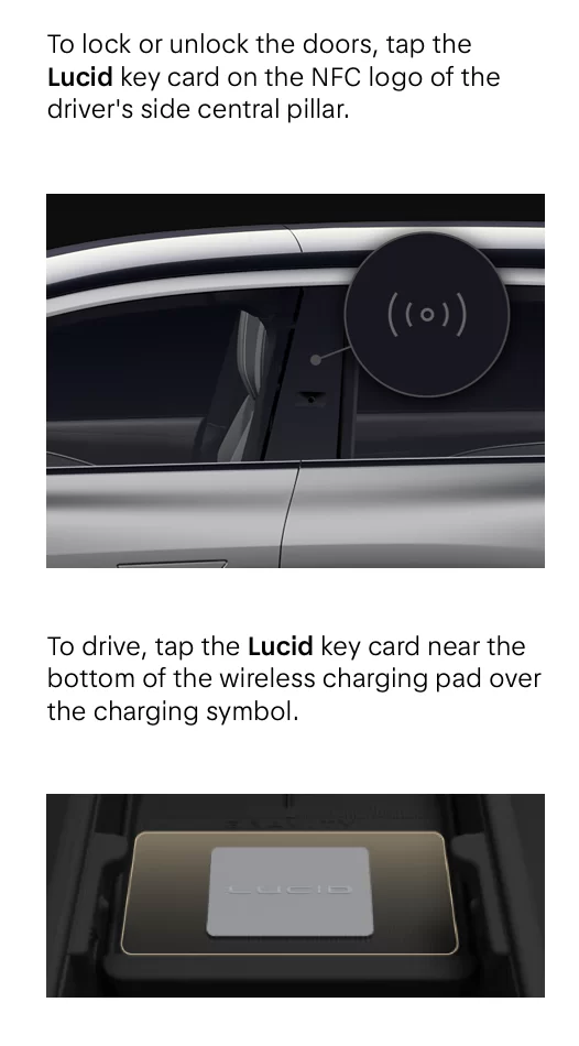

It's of a prime concern for me because due to my center console issue I can't use my key cards. If my Fob battery dies 50 miles from home I've got a long walk ahead of me. I guess my best option is to put some spares in the glove box. I can still unlock the car with my phone and then swap out the fob battery if it came to that.
For Air: https://lucidowners.com/threads/using-the-valet-key-card.685/
Maybe there's an equivalent for Gravity?
Edit:
