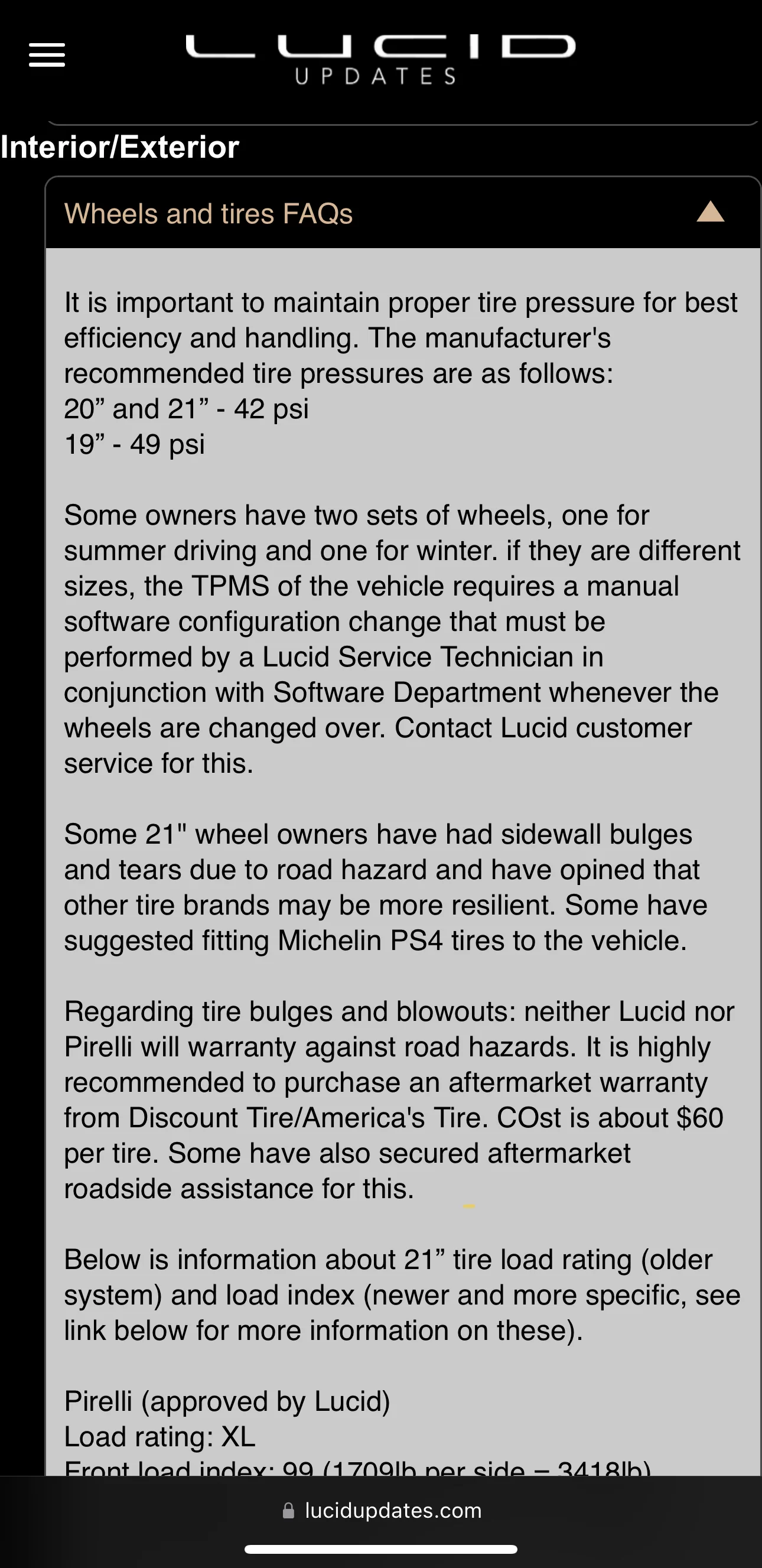

Where can we find this torque spec? Perhaps @Bobby could add the info to the Lucid Updates -> Wheels and Tires FAQs once the verified specs are noted?
