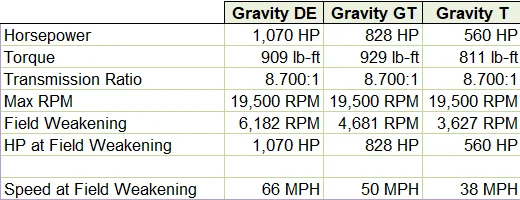

Those are great... which model is that Dream Edition, Grand Touring, or Touring. A while ago I made a little table comparing all the cars I have been shopping. The interesting thing about the Gravitys is their high motor RPM and low gear ration which allows both high top speed and high acceleration. But you can see the impacts of the motor configurations in this table and how that affects acceleration.
Depending which model you tested, you would expect to see acceleration fall off around 50-60 MPH, which seems to show on the quarter run. Also, the acceleration line is kind of jaggedy, but it does not look like they are limiting torque early on.

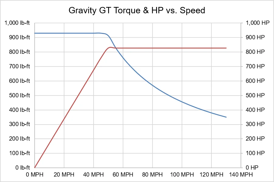

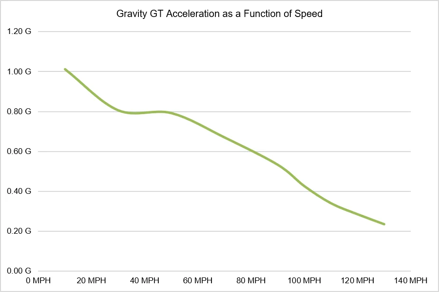

Here are a couple fun little charts interpolated from your data and interpreted from the Gravity motor and transmission specs.
The first chart is the acceleration rate as a function of speed. The 0-10 MPH segment is off, but that is most likely because it has rollout removed, and that inflates the calculated acceleration rate. If you add back the 0.1 to 0.2 seconds for rollout, it looks a little more normal. The gist is that the rate of acceleration is probably flat until around 50 MPH.

Then this chart is the estimation of torque and horsepower as a function of speed. The key inflection point is 49 MPH, where Horsepower reaches its peak but Torque slopes downward.

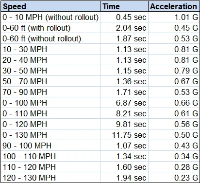

That is not what I expected to see at all. It looks like the first chart is saying it reached 60' at 21.84 MPH. Doing the math two different ways, that is 0.53 g, much lower than what is showing on the acceleration line in the chart above. I thought that the 1.87 second split actually included rollout. The earlier table is showing 10-30 MPH much quicker than 0-21.84 MPH. Ditto 0-10 MPH, that is much quicker as well.
Those 0-60 ft splits do not appear to be consistent with the other data from the app.
The one key observation from the chart itself is that rate of acceleration appears to be dead-flat from near-0 to the right side. You only see a very short jerk torque transition (ft/sec^3) at the very start of the run.

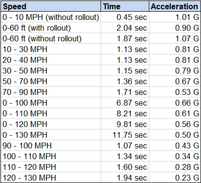

This table shows the Gs for each split from your original table way above. As you can see, the 0-60ft is a major anomaly. That segment should have had a split in the 0.9g range. There is no way it could have taken 1.87 seconds to get to 60' at 21.84 MPH if it only took 1.58 seconds to get to 30 MPH.

It’s not a question of soft launch. Those two 60’ data points are wrong. They do not match other surrounding data points. The split times shown at the bottom do not match the acceleration graph at the top.

No. Math and physics are quite simple. In that table you posted above, the 60’ time and the 0-30 times are incompatible. The 60’ split is at 21 MPH, right? They both cannot be true. Unless I am misreading something, and feel free to clarify what is presented, one of those two is wrong. The fact that the 10 MPH, 30 MPH, 50 MPH, etc. data points all align, the 60’ split is wrong. It is simply impossible. Your unrelated track slips are irrelevant.

I figured it out. Your app is showing the incorrect trap speed at 60'. It should be around 44 MPH. This is the corrected table ignoring the bad trap speed. The app has a defect. Bad data, not bad math. The math always maths.
