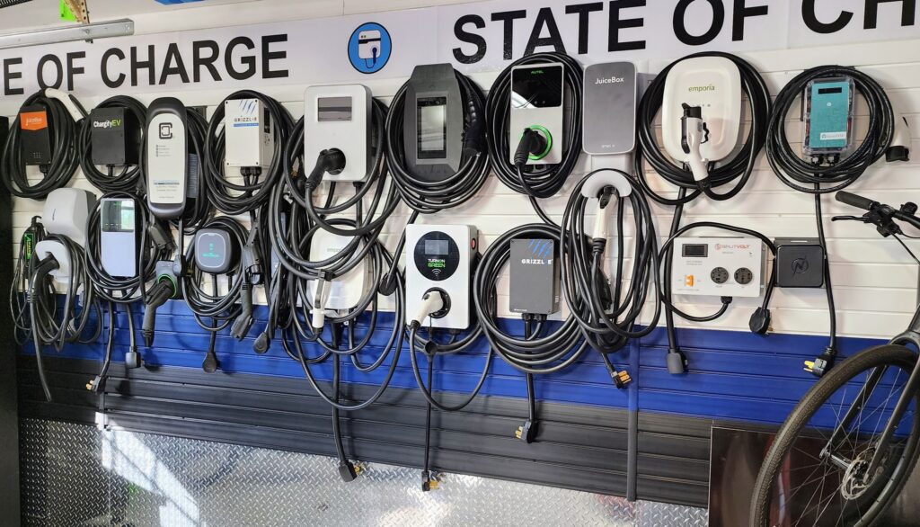

Emporia Level 2 charger
it was well rated in Tom Moloughney’s reviews.
