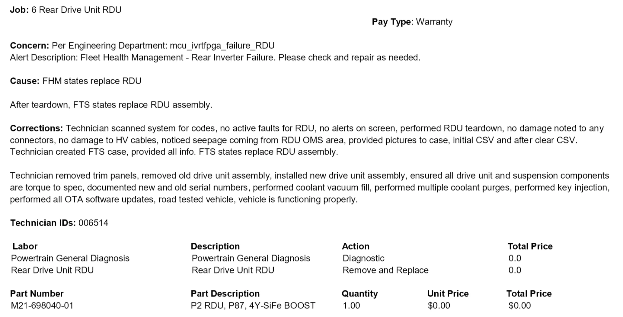

Interested in knowing whether the observations and replacement procedure match others who've had RDU replacements (@hmp10 I'm lookin' at you):
I'll let you know what I can find out when we get our car back. We're coming up on three weeks tomorrow.

Got a call from my SA today, and after having spent nearly three and a half weeks in service, Velocitron is going to be ready for pick up from the service center tomorrow afternoon, 1 Oct. The SA confirmed he had my second key fob and key card in hand as well (and that both key fobs have received the firmware update) fulfilling the due bill
As I mentioned up-thread, I'll ultimately need to return the car to have the middle row seats and assembly completely replaced whenever those are in stock, but at least they took care of the other issues, including some I didn't report -- like replacing the entire Rear Drive Unit (RDU). That particular repair sounds hairy... specifically the "...seepage coming from RDU OMS area." Here's a screenshot of that portion of the work order. Interested in knowing whether the observations and replacement procedure match others who've had RDU replacements (@hmp10 I'm lookin' at you):
FHM aka Fleet Health Management means that your Gravity threw remote errors to 'the mothership.' Those stories you read here of folks getting a call saying 'hey, we need you to bring your car in so we can replace thing' when the car was seemingly otherwise operating perfectly fine? Same deal - those are the vehicles telling Lucid's FHM system 'Houston, we have a problem'

Closing the loop. After three and a half weeks in service, I picked up my GDE from the service center this evening, and am happy to report all issues (with the exception of the second row seats and mechanism) have been addressed to satisfaction!
