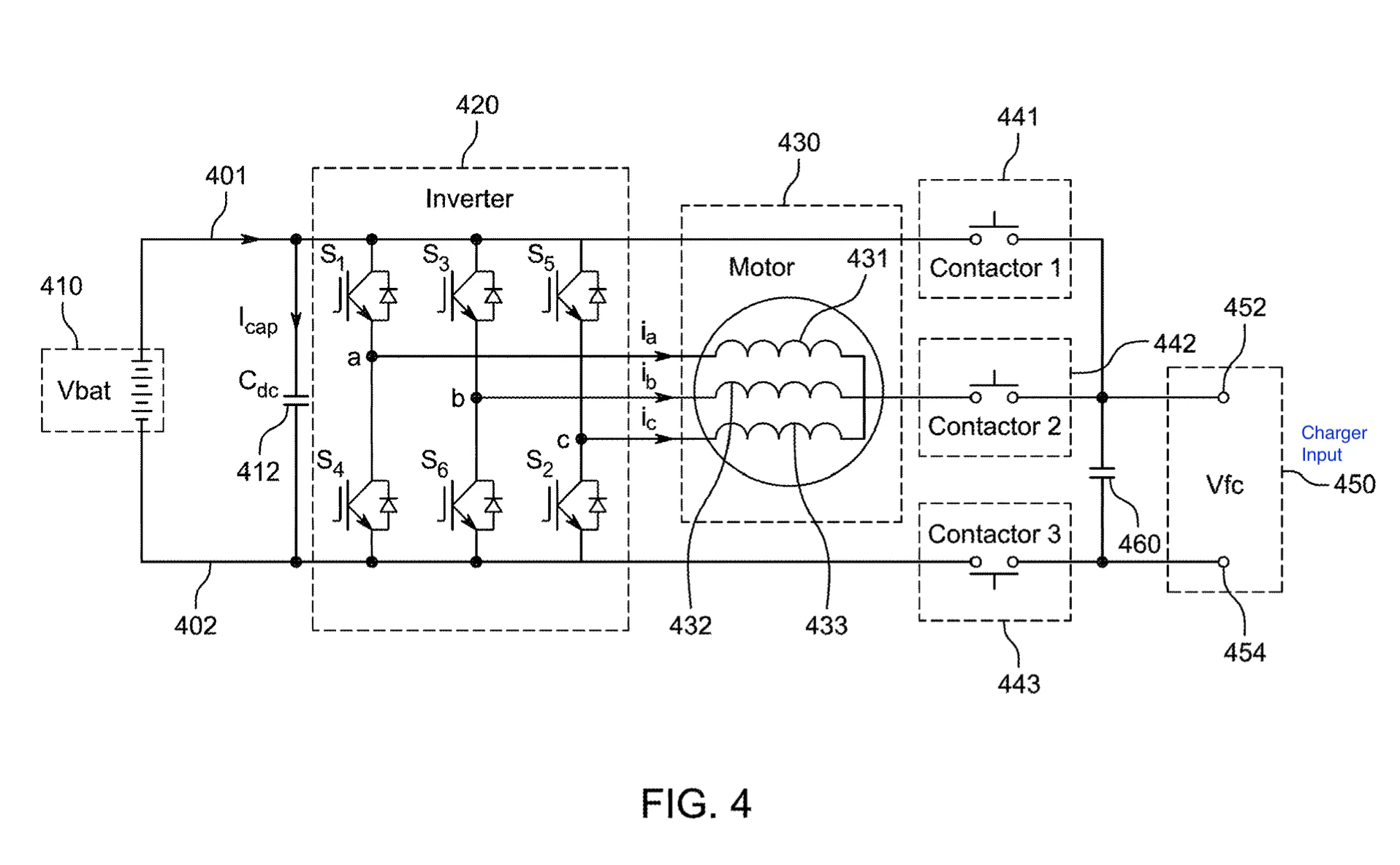

A basic DC to DC boost circuit requires an inductor, a switch and a smoothing capacitor. The circuit works by taking advantage of the property of an inductor where its voltage will rise as it tries to maintain a constant current. The switch is used to change the current through the inductor and thereby increase the voltage across the inductor. The switching frequency controls the amount of voltage boost. The smoothing capacitor helps make the output voltage constant so that it can be used for battery charging.
The stator of an electric motor is a large inductor, the motor inverter is multiple switches. Hence, most of the components for the DC to DC converter are already part of the motor. Lucid was issued patent US10505455B1 on Dec 10 of 2019 for this DC to DC boost methodology. A figure from their patent helps illustrate how it works. Contactor1 bypasses the motor boost circuit for high voltage chargers, Contactor2 engages the motor as a boost circuit. The advantage of having three stator windings is that currents can be interleaved and phased to minimize motor torque and reduce ripple on the boosted voltage.

If I interpret your tutorial correctly,
> if the DCFC is capable of 1000V, Contactor 1 and Contactor 3 will close and charge the batteries directly.
> if the DCFC voltage is say, 500V, Contactor 2 (and contactor 3) will close. The DCFC current flows through the (3) motor windings (phased), acting as inductors to boost the voltage, and, them combined and filtered by CDC to generate a "slightly rippled" DC to charge the batteries.

Yes you are correct.

Here is the circuit from Hyundai's patent. I think it's identical except for the placement of R3 which makes no functional difference.

The diagram doesn't really tell you anything about what's being patented. I don't have time to give the patents a full read right now, but a cursory look at the 1st claim of each patent seems to indicate that they claim almost exactly the same thing, with the key addition in the Hyundai patent (which came after the Lucid patent) is that that the neutral point capacitor will be drained once charging is complete. Welcome to the world of patents, where even tiny things can make the difference in what is covered and what is not.
