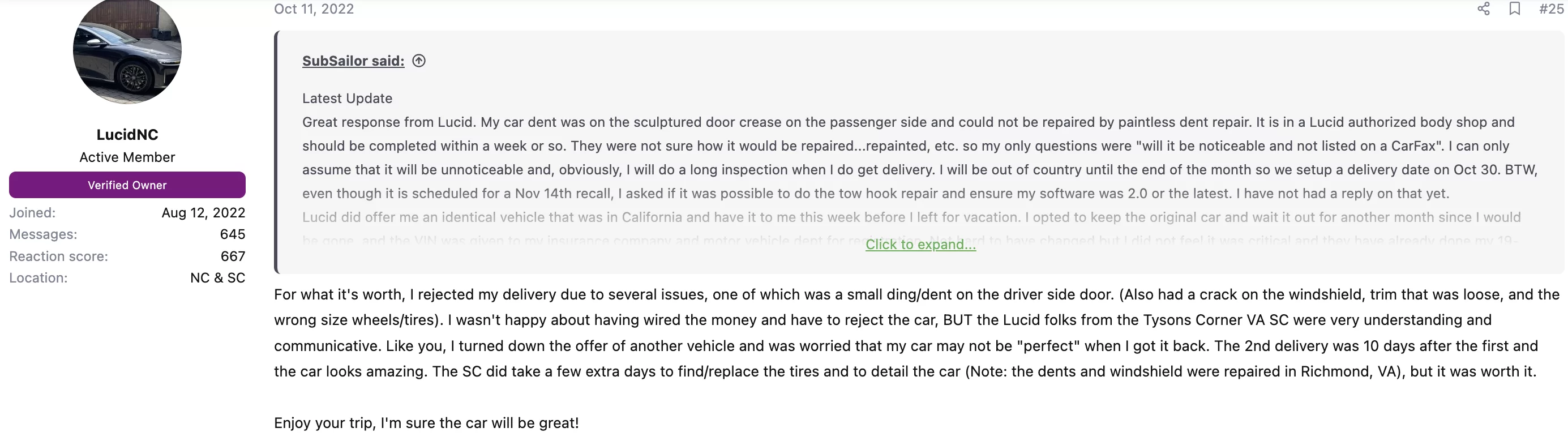

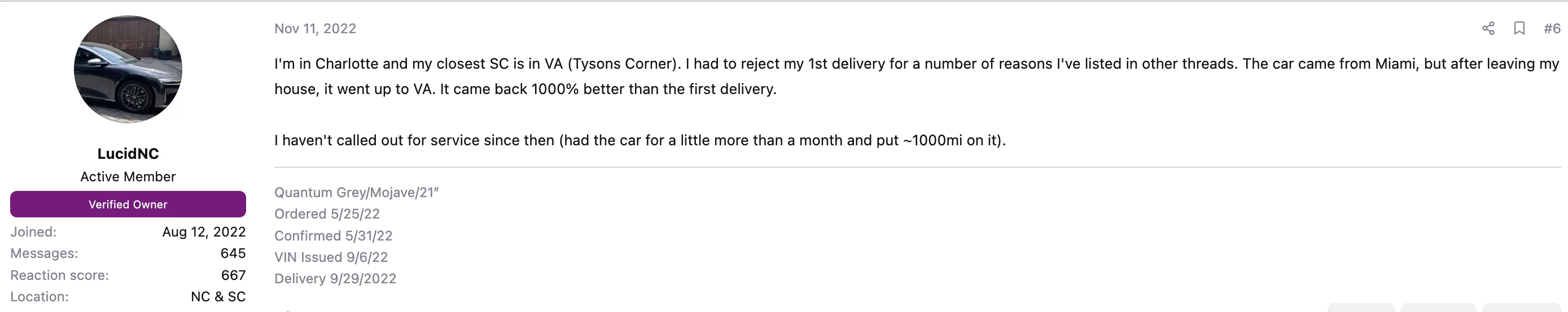

Just curious; does the delivery advisor state the option of delivery rejection exists, is it in the documentation before signing, or what?
I see from posts like the one below that the option of a replacement exists in addition to having the original fixed.

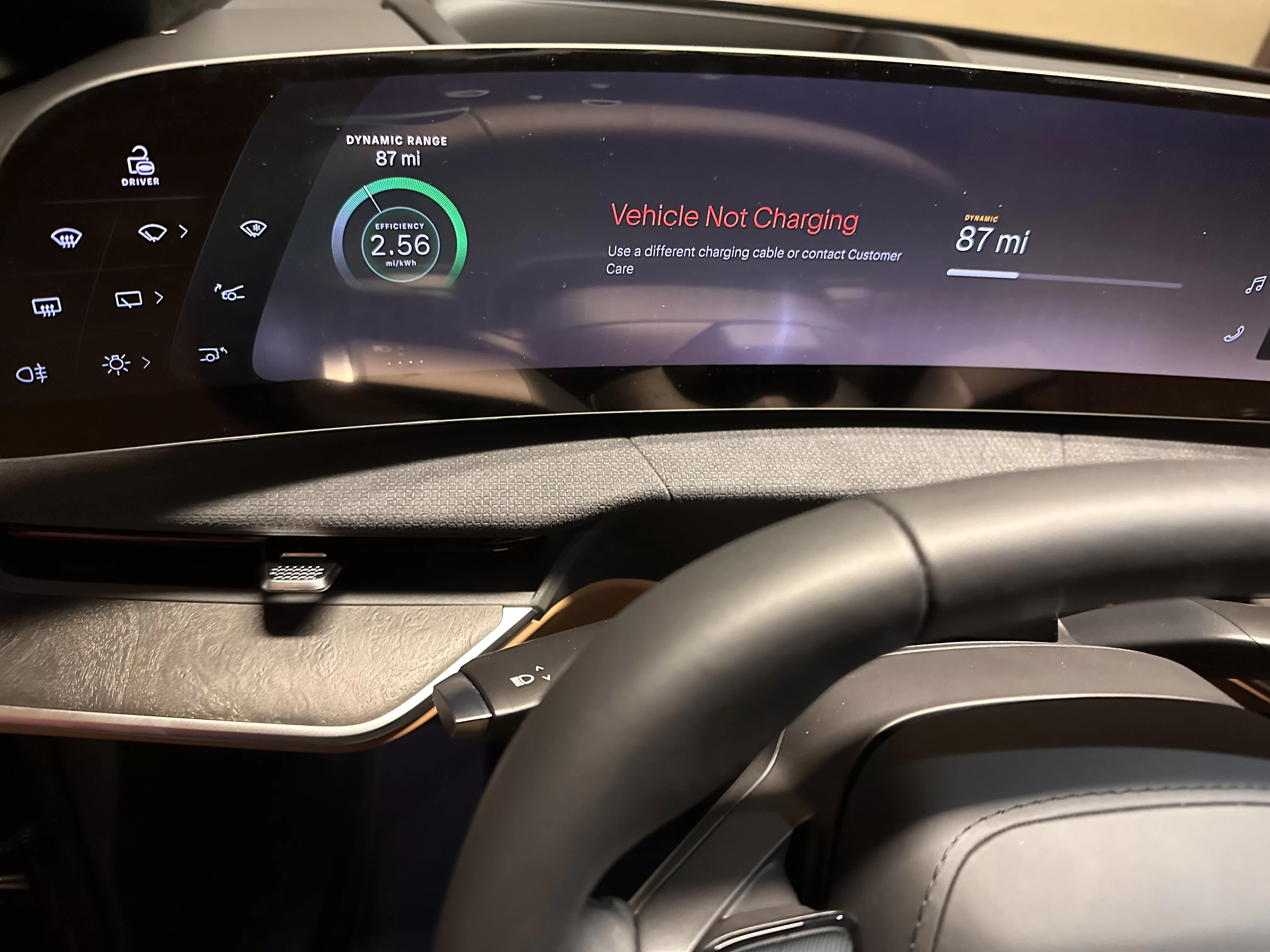

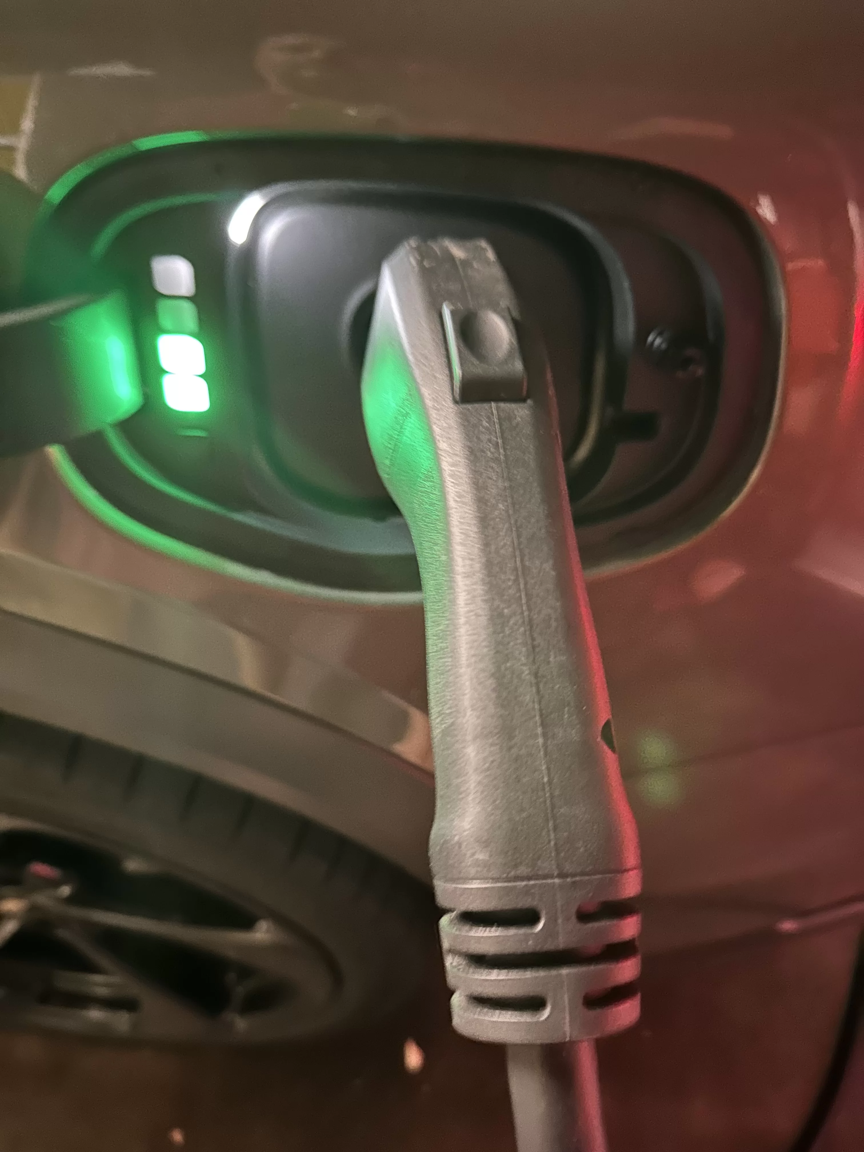

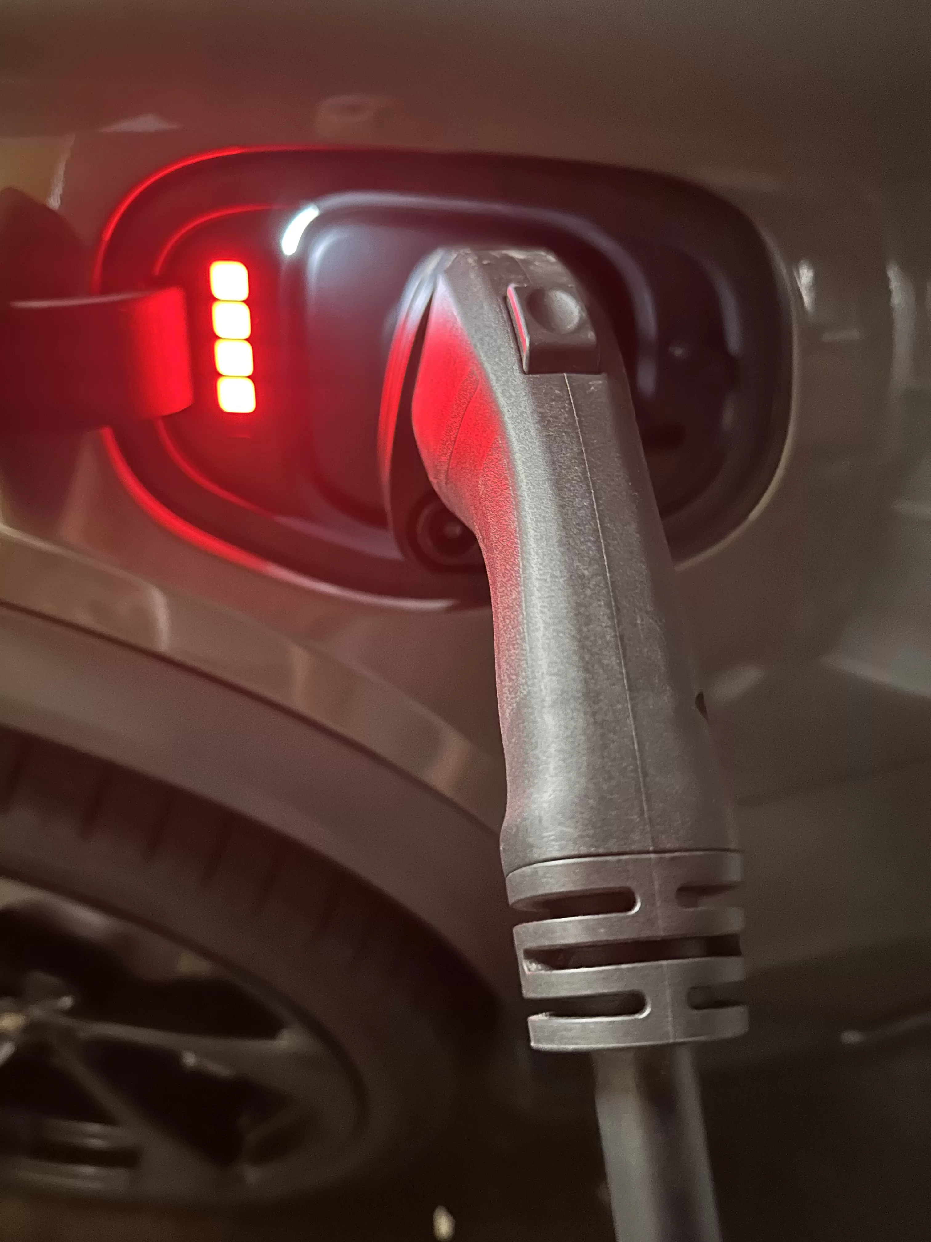

Lucid Gravity Issues – Seeking Support for solutions
I’ve been having a few issues with my Gravity:
• Homelink & Wireless Charger – Not working. These are minor and I can wait on them.

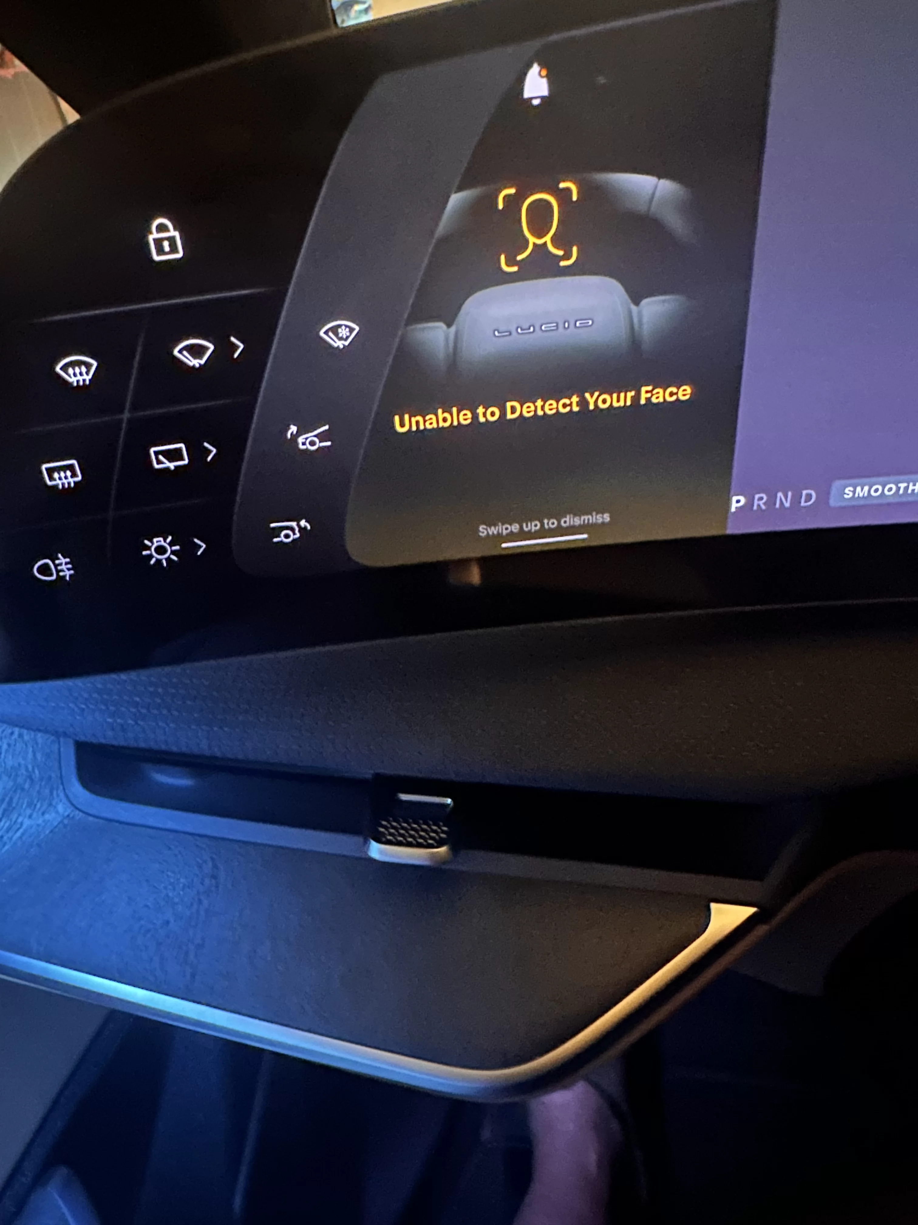

• Facial Recognition at Night – The car sometimes doesn’t recognize my face in the dark. Has anyone else experienced this?
• TIDAL App – Keeps disconnecting unless I start the trip from home.
• Tesla Charger – In town I’m getting ~5 miles/minute, which is okay since I mostly charge at home.
• Home Charger (Lucid brand) – This is the real problem. My home charger has stopped working and I need a solution ASAP.
Despite these hiccups, I absolutely love this car. It’s easily the best purchase I’ve made. I’m proud I waited almost two years for it, and every time I drive it, I’m reminded why it was worth it. Just hoping to get the charging issue resolved quickly so we and our kids can fully enjoy it.

I would have a backup 14-50 outlet and a mobile connector in case the wall connector is not working.
I see that you are using a CCS1 to NACS adapter at home which should NOT work. That adapter is for DC Fast Charging like Electrify America to your NACS port.
At home, you need J-1772 to NACS adapter which should come with your Gravity purchase also. If not, call to get one.
I have no idea why we need 2 separate adapters!
I wouldn't worry about the Facial Recognition feature. It'll be useful in some future but not now.

use the smaller adapter lucid included with the purchase of your gravity
I tried the smaller one and it was not fitting. I’ll try again.
