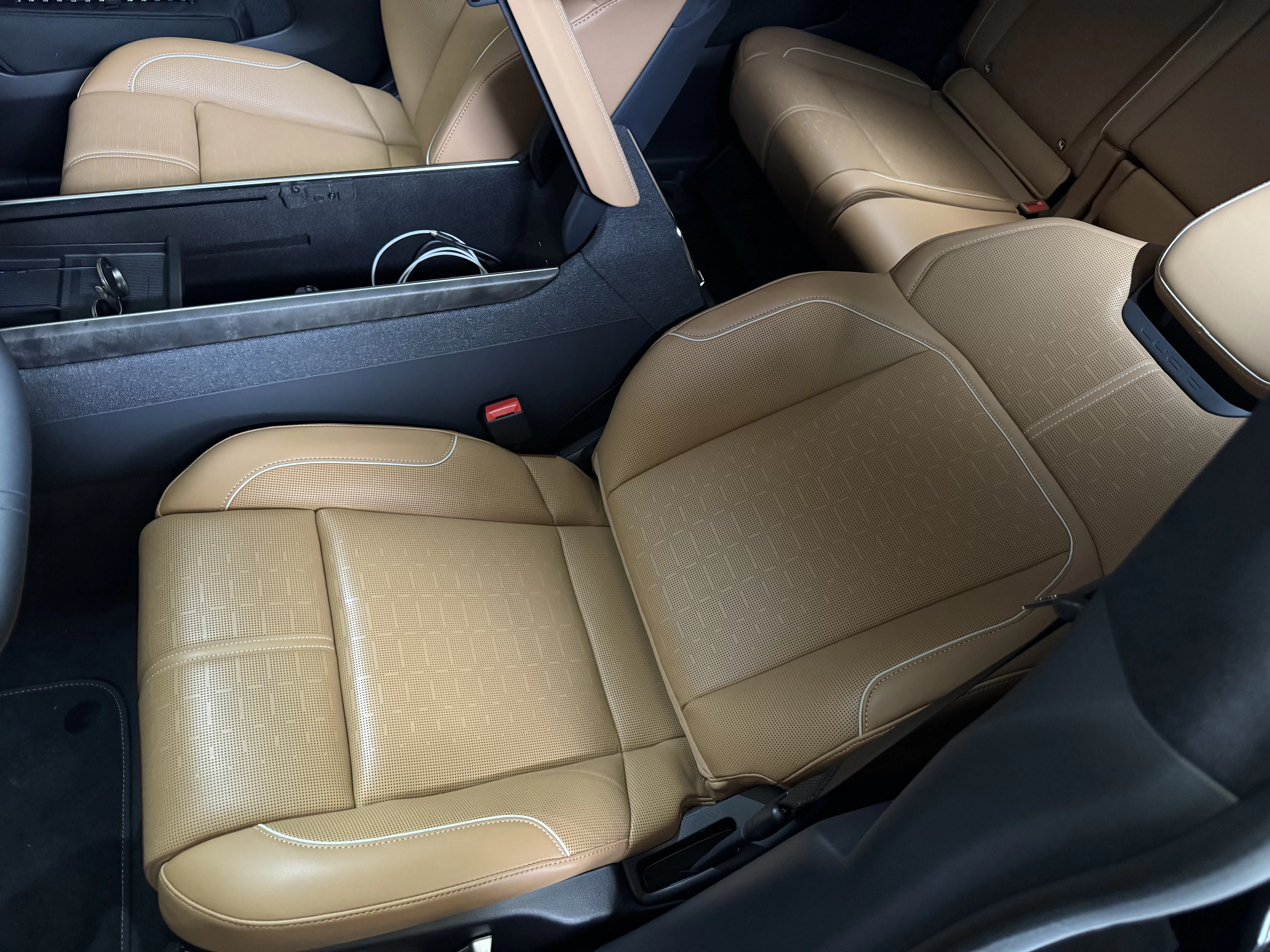

Well this is a new one…I guess my car didn’t want me to go to work this morning and just sleep in it.
Opened my door in the garage and the seat moved into this position.
Wow. My seat doesn’t always move for easy access OR for my profile, but it has yet to invite me to take a nap!
Had the exact same experience this morning.
First time ever.
Hit the restore button and everything returned to saved position, but what a surprise.
