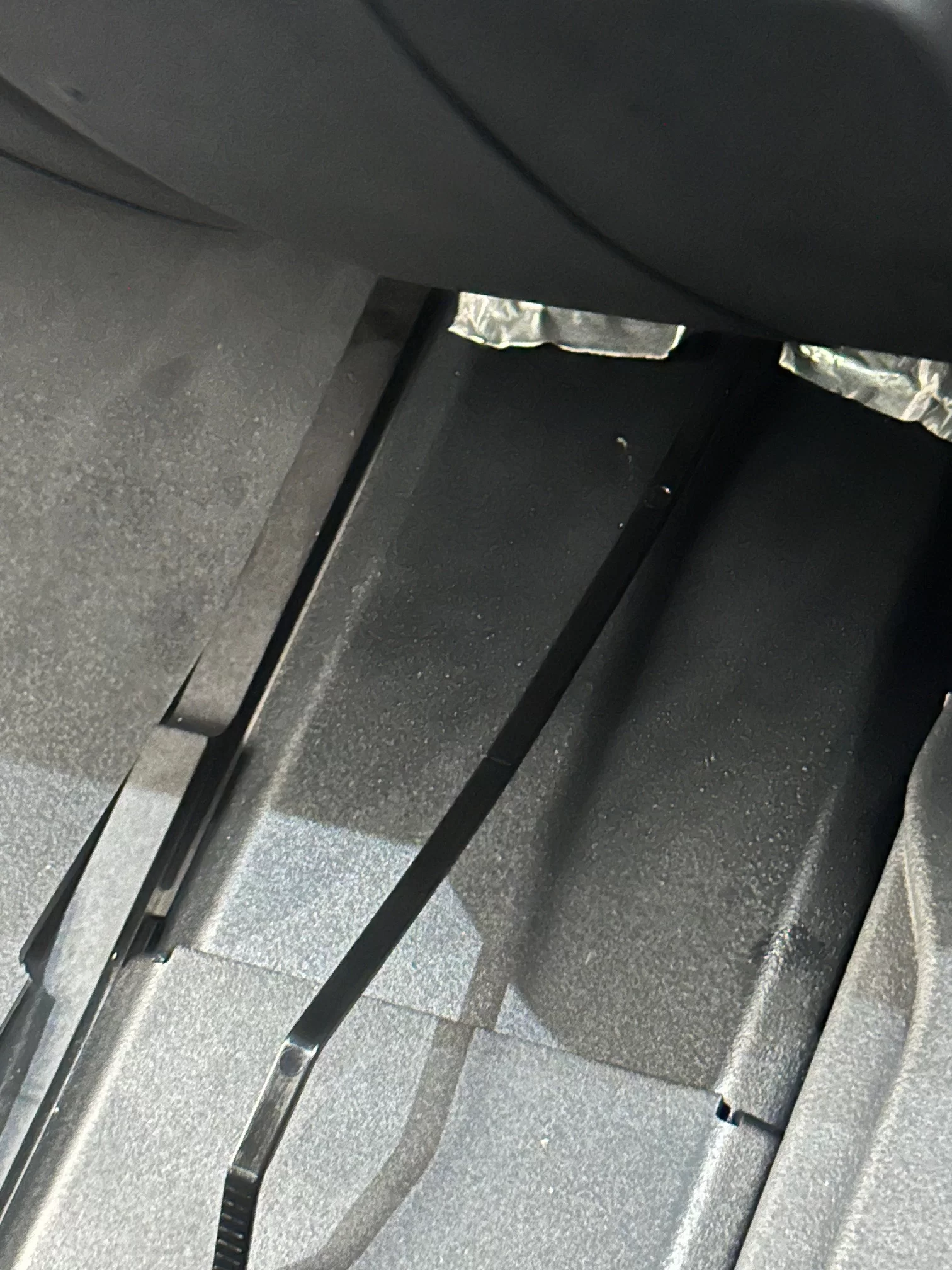

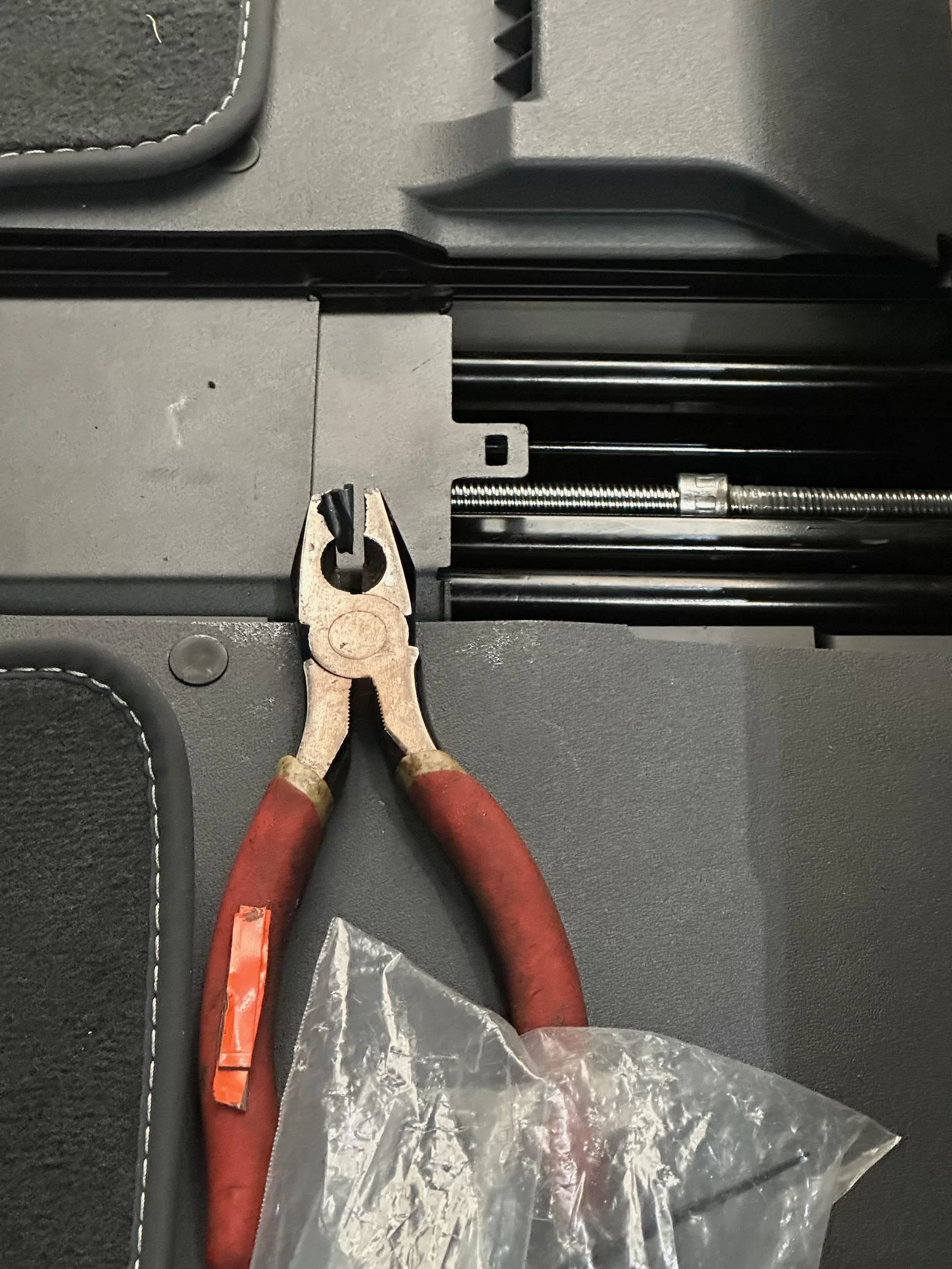

Our mobile tech just finished working on the second-row seat rattle in our Gravity. Here's what's going on:
There are four sliding metal covers (each with two telescoping layers) that slide back and forth over the four screw mechanisms when the seats are moved. The covers have a metal tab to which a zip tie is attached to hook the covers to the seats so that the seats will pull the covers back and forth as the seats move.
Here are the sliding metal plates in place:
And here are the plates pushed back, showing the tab through which the zip tie passes to hook the plates to the seat:
There are four such tracks in the second row, all of which are attached with zip ties. However, the mobile tech said the rattles they've been seeing thus far emanate only from the two inboard tracks.
None of our zip ties were broken. The issue seemed to be that they were not tensioned correctly to keep the plates from rattling. He has resolved the issue for now but had to use off-the-shelf zip ties and some plastic packing instead of the felt tape that should be used to keep the metal plates from rubbing against each other. He says the Service Center will install the proper parts when the car goes there on the 25th for the navigation system repair.
The edges of that hole in the tab for the zip ties is not filed smooth. My guess is that over time these zip ties will fail -- and the sooner the more the seats are moved.
