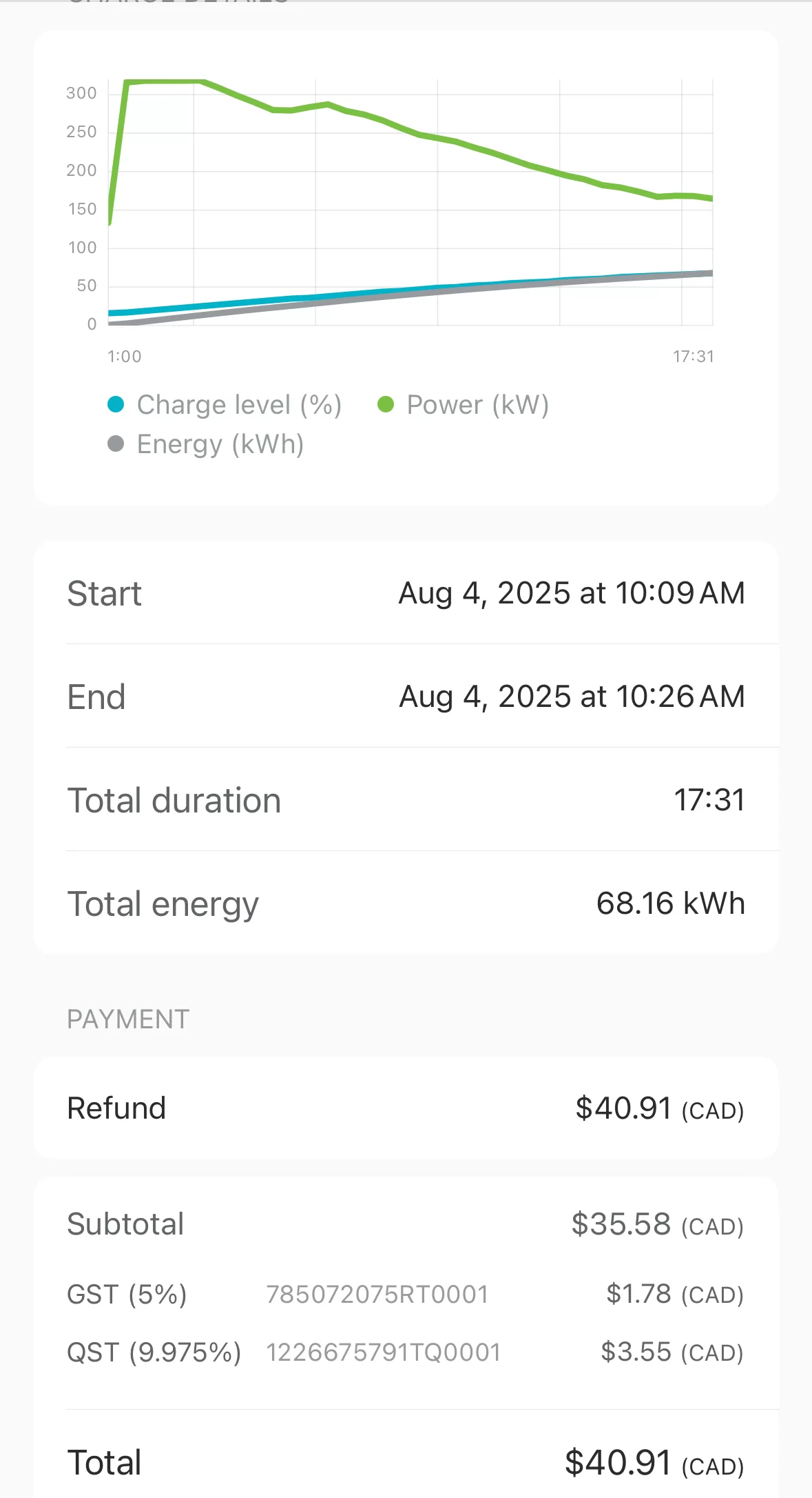

I've had several successful charges at 320+ kW sites, it's just that there are (around here) so many small sites that are clogged with slow-charging vehicles. At least with Tesla, there are 8-24 stalls at each site so I'm not waiting 30 minutes to charge.
We had some mixed experiences today. I stopped by a non-busy Circuit Electrique today and got 320kW sustained for a while:
Later we stopped by a Rivian Adventure Network site, which was very awkward in terms of cable length and location, and didn't work. It might have been a timing issue, but we went back to the EA site that was full instead of trying to debug. The EA site was 4 "balanced" 350 kW chargers, and on a shared post we couldn't get more than 115 kW. Once we moved to a non-shared charger we burst to 325kW for a while. With overly congested tiny sites and power sharing, all of these non-Tesla sites are just not a good experience. I hope this gets better. (Unfortunately the Tesla Supercharger in the same locale is mixed V2+V3 and so not open to NACS partners.)
Also, as mentioned above, the Lucid app data on all these stations was correct, but the in-vehicle nav had wrong charge-rate data and listed the unavailable Tesla. It's bizarre to me that the app and the car pull from different data sources here.

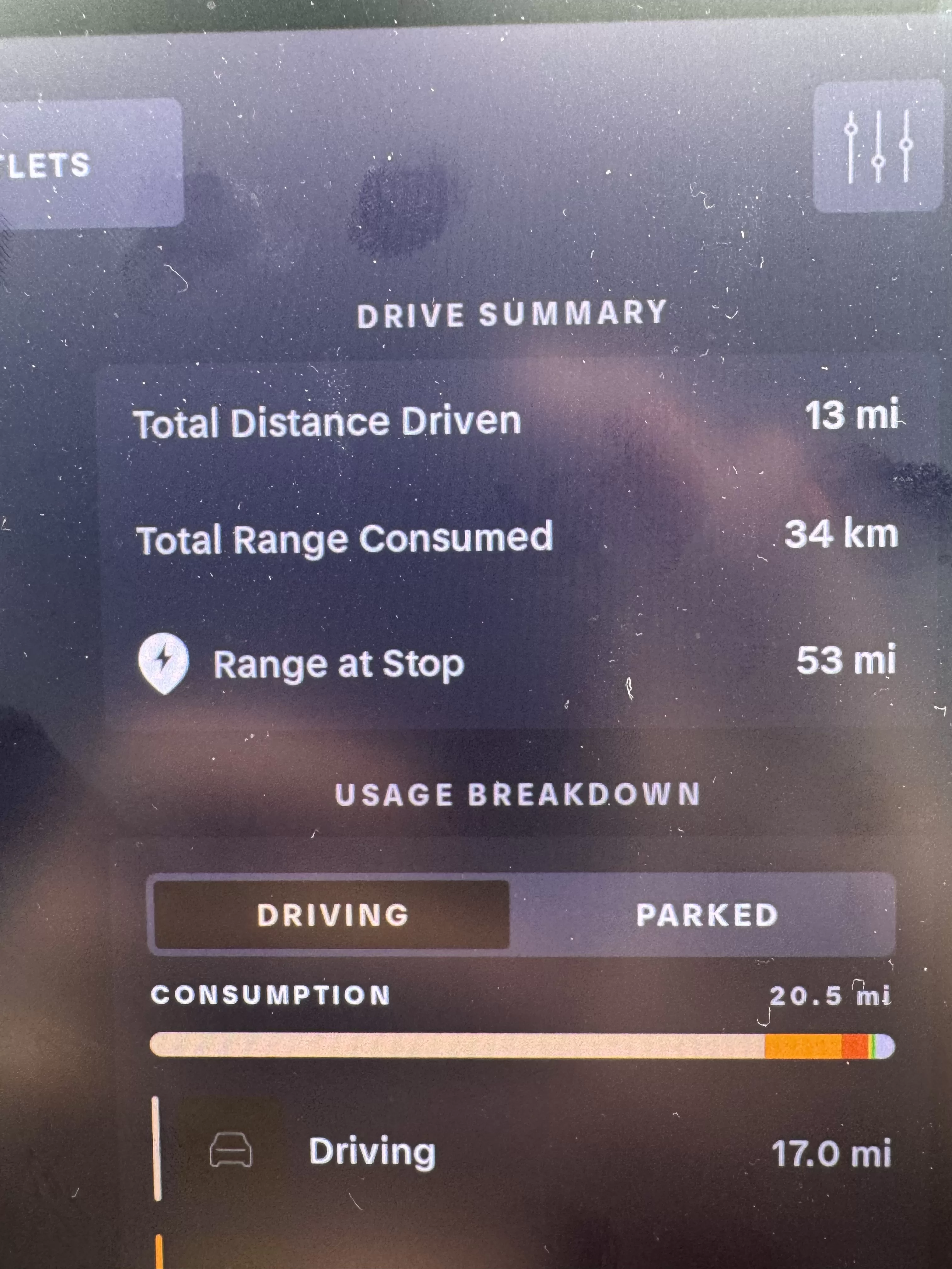

Separately, the Gravity continues to be very confused about imperial vs metric units:

I was still in Canada at the time of that picture, and the vehicle was auto-converting metric speed limits to imperial on the dash... so I suspect someone just left out a "convertToDefaultDisplayUnits()" call. Home now and all of the fields are now in miles again.
Then our cause might be different. We were in the U.S., the speed limit signs are posted in Imperial units, and the car was set to display Imperial units. Yet we got speedometer readouts in MPH and posted speed displays apparently in KPH . . . and not because the system was converting MPH on the sign to KPH on the car display. If so, a 45mph speed limit would be converted to display as 72kph, not to the 28 we're seeing.
If I was debugging this, I would speculate it's related to your weird GPS issues. The vehicle obviously "knows" what the speed limits are supposed to be, perhaps from the HERE map data, and then "knows" what units it's "supposed to" present info in. That's pretty wild though -- I assume you've reset/set the preferred units in your profile and so forth. We had weird F/C temperature issues on delivery, but nothing like what you're describing. I'm guessing they re-pushed 3.2.2 and you've done a factory reset, so the problems you're seeing are unfortunately quite the mystery.

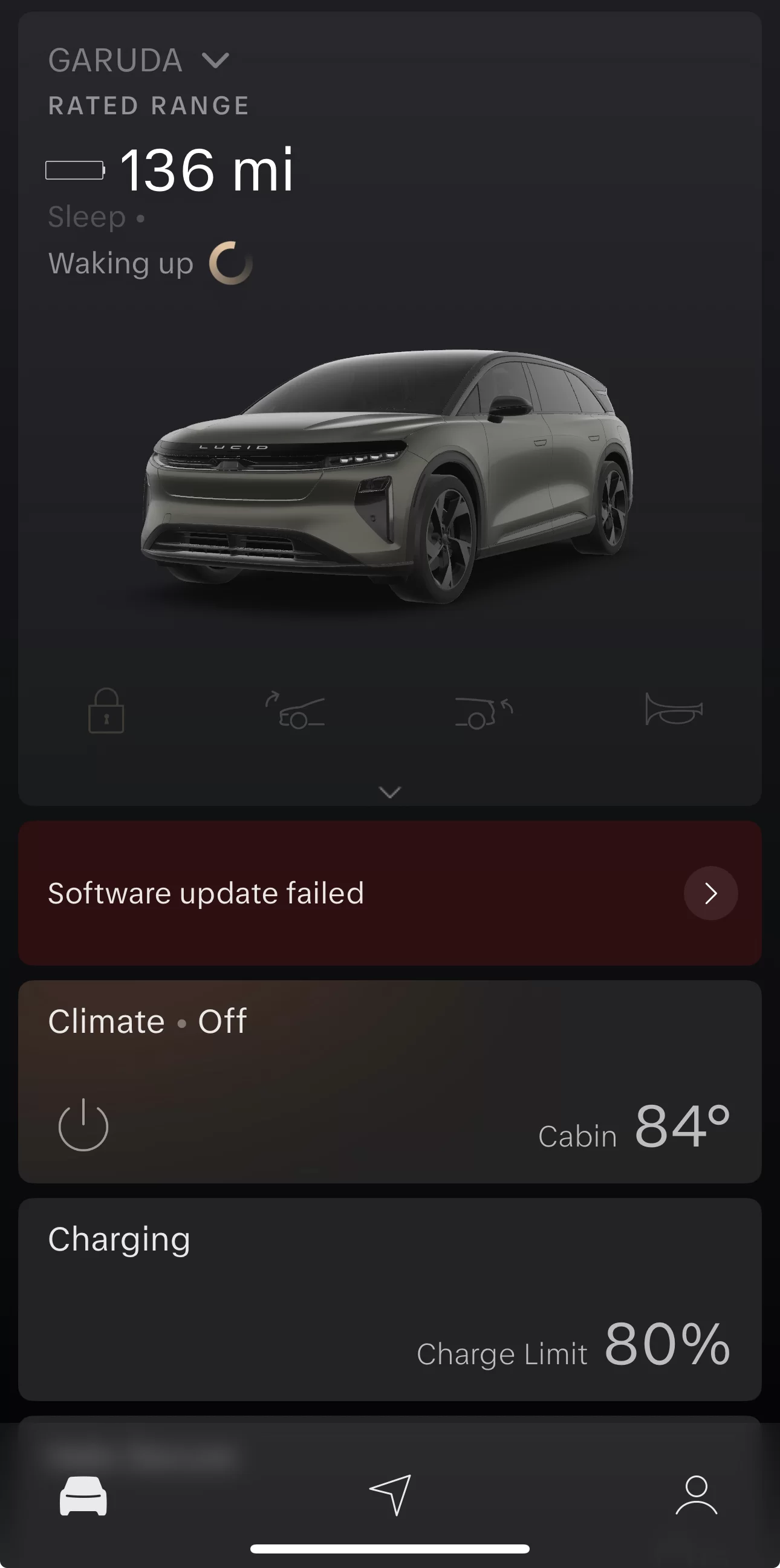

The “Update Failed” message has been stuck on my screen for the past 10 days (since last Saturday). Hoping it resolves soon with a fix.
Also, Sanctuary Mode isn’t working. I hadn’t tried it in a while, but after about a month, I tested it again today — still no luck. I’m wondering if this could be related to the failed update? Anyone else seeing this?
Definitely something wonky with the software on your car. Have they tried repushing it or doing some sort of hard/factory reset?
Customer care reached out to me last Saturday asking why I hadn’t updated yet. When I explained that I’m getting an “Update Failed” error, the person said they would notify the team. That was the last contact I’ve had regarding this issue.
Just patiently waiting at the moment to see how it gets resolved.
Lucid fixes problems at the end ,but takes its own sweet time. 🤷🏻‍♂️
I think the speed limit sign recognition was incorrectly interpreting the number on the sign as KPH, and displaying that speed in MPH.
Someone pointed out that 30KPH is closer to 19MPH (18.6), but that would be slightly over the limit, so they would rather display the integer closest but less than the computed speed limit.
