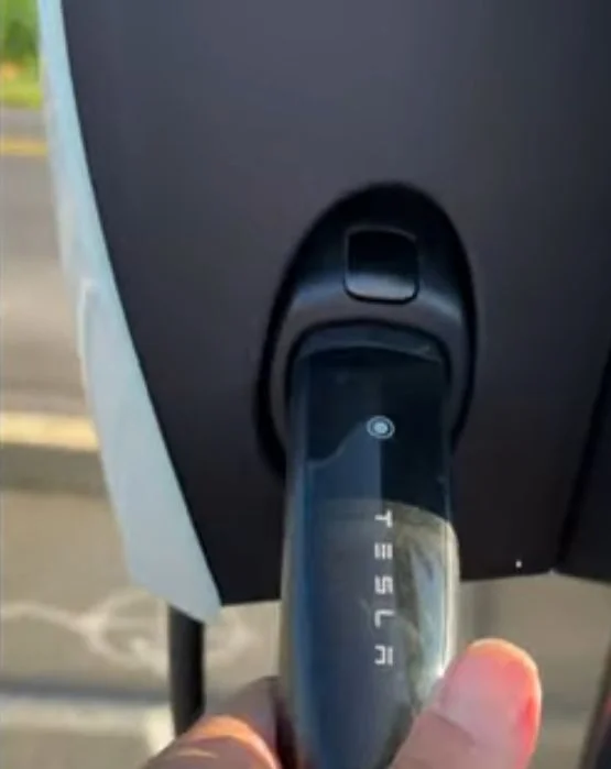

The Gravity does not work with the older Tesla Destination wall chargers. (Lots of EVs don't, IIRC.) Only the newer ones that have the built-in adapter. You can fool the old ones with a TeslaTap adapter though (adding the reverse adapter to it to convert back to NACS), which I had to do on a recent road trip.
I'm not an expert on Tesla wall chargers so maybe someone else that knows them better can chime in, but at hotels I just know to look at the holster slot to see if it's the old style or the new style. That's about the only difference I can see (the built-in adapter inside the holster).
Here's a pic I took of a Tesla wall charger that DOES work. The ones that don't work just have an empty holster hole instead. I had to look for the difference on a recent trip. The Peppermill Hotel Casino in Reno has 6 of the old ones and 4 of the new ones, and I figured out I had to stick to the new ones.
I didn't bring my old TeslaTap with me on that trip because I figured I'd never need it since the Gravity has a NACS port. On the following trip I brought it along in case I needed to use an old Tesla wall charger, and I did. Daisy-chaining the TeslaTap + reverse adapter did work, although I only got 3kw. Still not sure if that was the adapter or the charger. I assume it was the chargers just being configured for lower power in that parking garage (Barona Casino near San Diego).
Define old Tesla charger. I have one that was installed in 2014, it it worked fine with my Model S, my Mustang Mach E, and now my GGT. I have the car set to 40 amps.
My Tesla Wall Charger from 2018 works fine and has the "empty holster" you mentioned.
That's why I asked for someone who's more familiar with Tesla Destination chargers to chime in. I know it's often the case at hotels that have Tesla Destination chargers, but I don't know if it's the same for Tesla Wall chargers for home. They look like the same hardware but maybe they're configured differently? Perhaps some are somehow set to work on Teslas only. 🤷‍♂️
(I do see that the OP was talking about the Tesla mobile charger, so none of this may apply to them anyway.)
