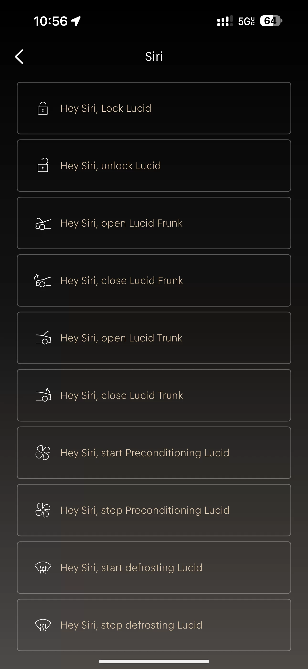

If you are using an iPhone create a Shortcut that you can put on your Home Screen or in a widget. You can then tap it without having to wait. It still in theory takes the same amount of time to wake and set the vehicle, but you don't have to wait for the app to become functional before doing so.
33 seconds just now. This feels about normal to me. Have you tried the Siri shortcuts? That might be less frustrating, even if it still takes just as long at least you don’t have to wait for the buttons to become usable.
That's pretty cool (no pun intended). Obviously I know you have an iPhone. But do you know if these types of commands are available on Android? I can't stand the app delay to wake the car and use the buttons
Disregard. I just found it and will definitely try it!
