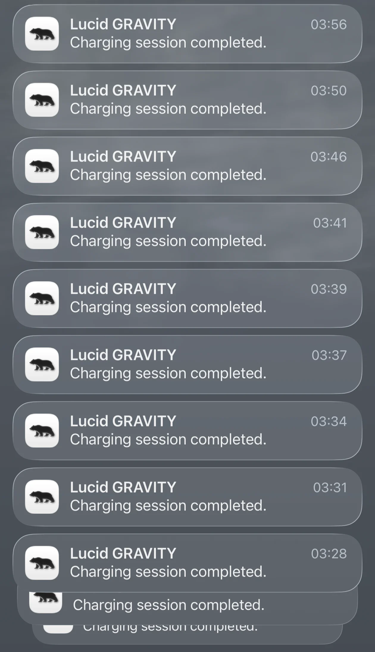

I just tried my 80A Lucid charger on the Gravity at my vacation home. It started out fine at 19kw, but when I checked it at 70%, it would go between 11kW and 14kw. After reaching 80% if would get the charged message repeatedly. I unplugged it at this time.
