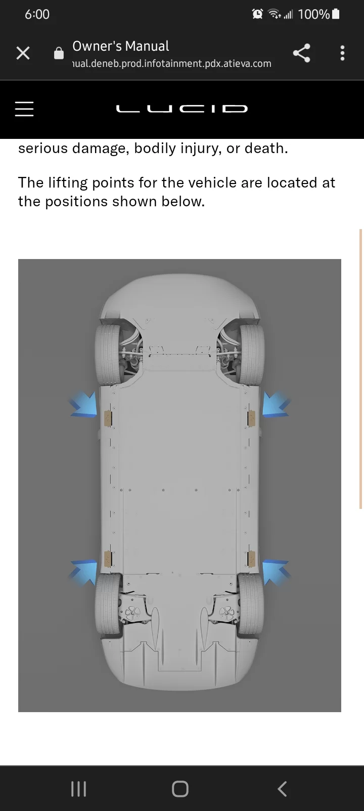

The lift points are very similar to the plastic lift point plates on my MS. The cup on a platform jack is wider that the plastic plate and has raised edges that could damage the adjacent vehicle. On the Tesla owners website, many users mentioned placement of hockey puck into cup of the jack to prevent the edges of the cup from damaging the car adjacent to the lift point. Alternatively, one owner designed a wooden jack plate with three short wooden dowels that inserted into the three depressions on the lift point plate. I followed the directions and made the wooden jack plate that has worked well on several occasions. BUT, a hockey puck is an easier solution.
