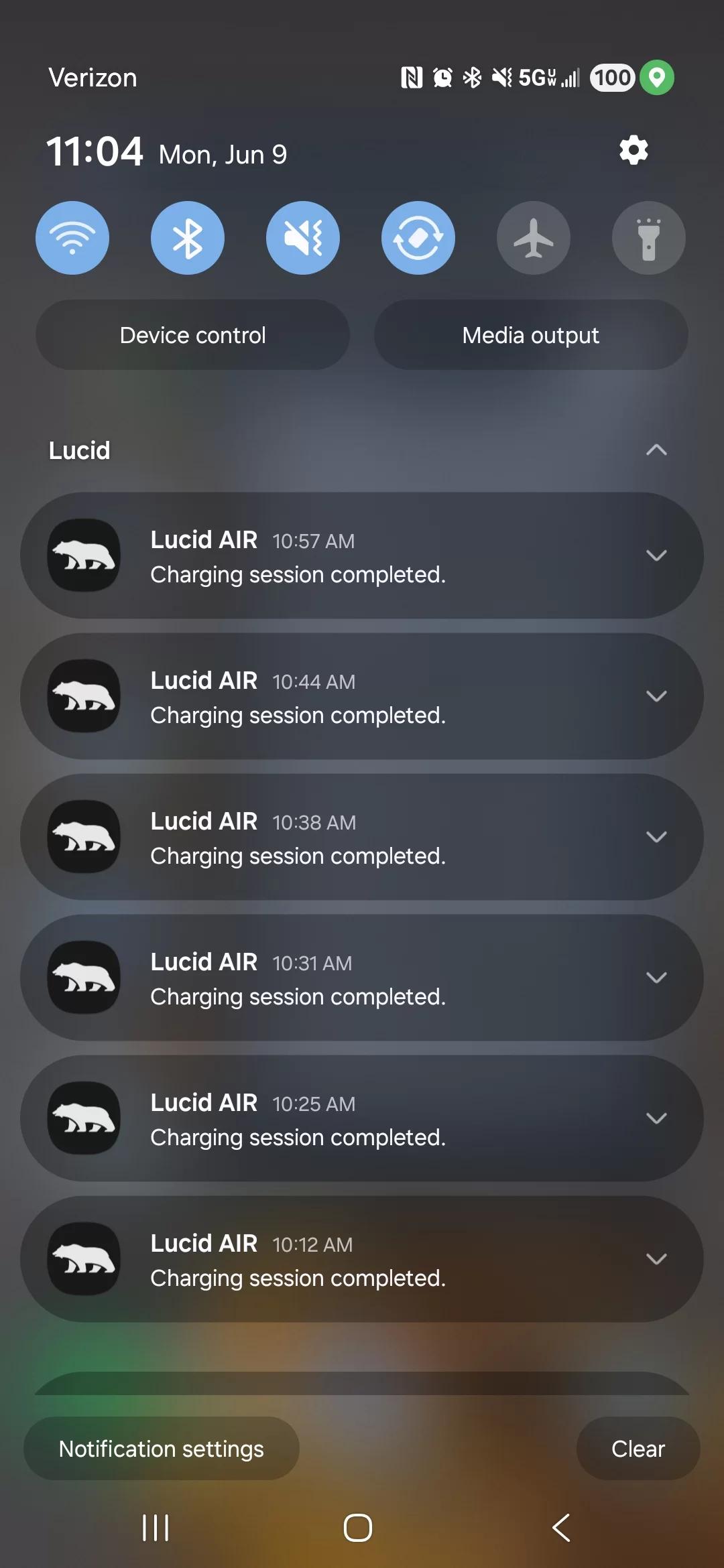

Anyone else have this issue recently? Got the new aOS app last week and after charging last night I get a notification while plugged in that charging is complete, almost every 10-15 min.
You can turn that off in the app. I agree, it’s pretty silly that it works the way it does. It would be nice if they gated it so that it doesn’t report anything g less than a kilowatt to clean that up.
Tagging @marqie for awareness. Hope this gets resolved in future updates and communications around resolutions are made in detailed fashion. I personally am shutting off notifications (as it seems others have) but one day would like to turn notifications back on to have a full featured lucid experience.
I had 49 of them yesterday morning. I just unplugged the car lol
Customer service said they are aware of the issue but no fix yet
