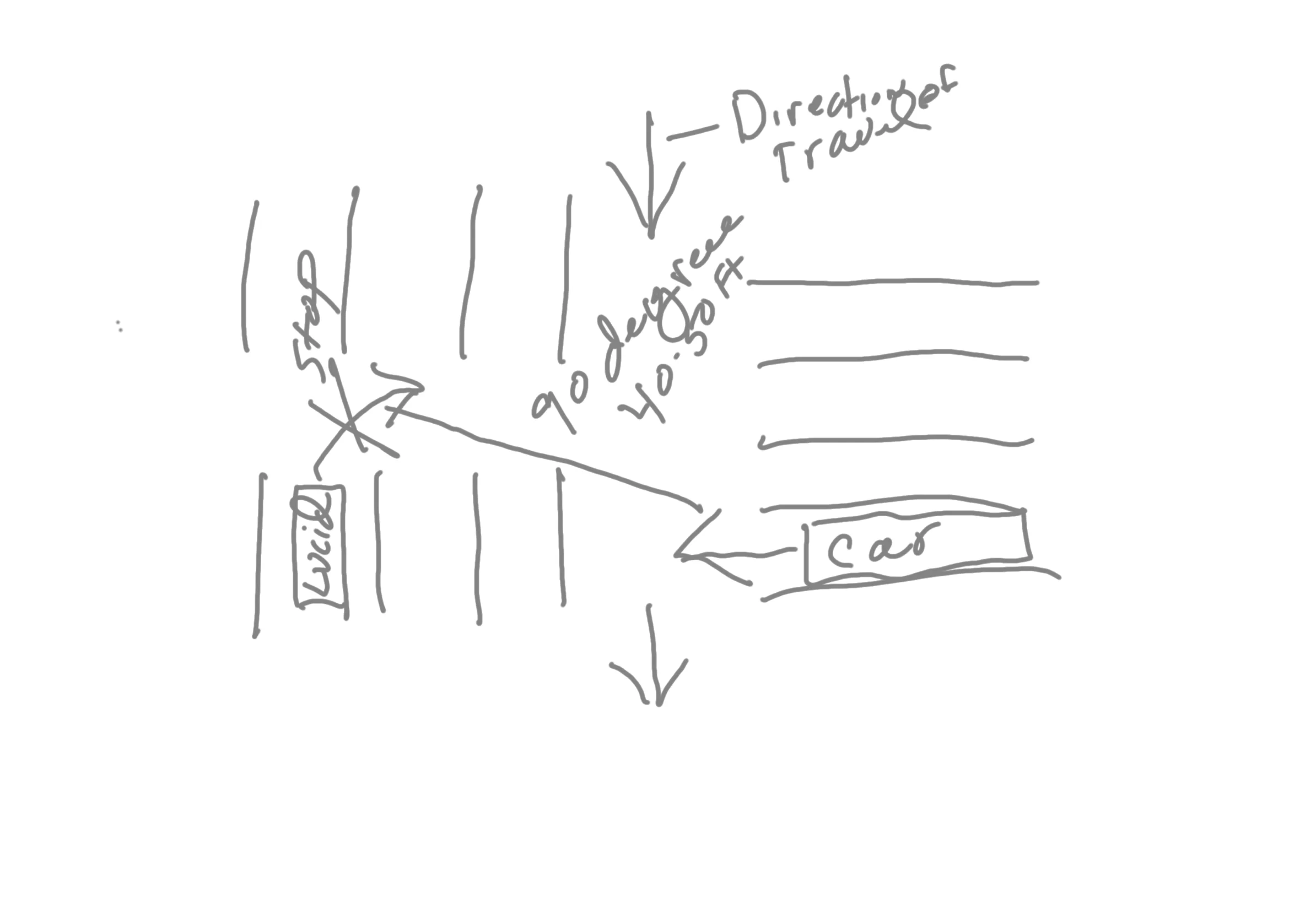

Anyone had this happen? After dropping my wife off at FLL yesterday morning, I began pulling out into the thru traffic lanes and the car came to a complete and abrupt stop, from about 5mph. So I didn’t have my signal on, as there was nobody in the lane I was creeping into but when it stopped, about halfway into the lane next to me, it popped up the left signal camera, sounded and turned red. Naturally, I (and the car to my right that was unloading) said, wtf! The car that it had identified as potential collision was 20 feet from me and in a different lane! I chalked it up to a one off, but it wasn‘t. Today I had an even more bizarre thing happen where it did the same thing. Without drawing a picture of the parking garage I was in, it’ll be difficult to explain but this time I was 40-50 feet from the other car and not even on the same row. Lol.

I’ve never seen that happen yet. *Could* you draw us a picture?

Yes, I believe it is but it’s overly aggressive, so to speak. In both instances I was at a point where the lanes or rows curved, so my car was at a 90 degree angle to the other car that the cross traffic picked up on.

I think I get what happened here: you were going to turn across traffic and there was a car that might pull out into traffic, correct?
At this angle, the other car is not covered by long range active sensors, so this probably is being checked by cameras at long range only (ultrasonic doesn't reliably get more than 20-30ft last I checked).
In my awful drawing, those are parking spaces. This is not something that should happen and likely can easily be replicated by anyone that gives it a try.
