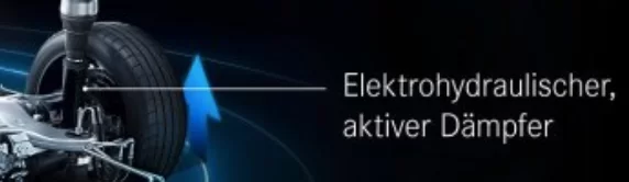

The innovation in the Damptronic Sky damper is that it uses separate valving for compression and rebound which avoids the compromise of having to use a single valve for both states. However, the viscosity of the hydraulic fluid is still controlled electromagnetically. While providing greater control and more refined ride, merely separating compression valving from rebound valving would not allow the variable softening or firming up of the ride via drive mode settings in a coil suspension setup.
Here is a photo from the Bilstein website of a Damptronic Sky damper installed in a Mercedes setup. You will note that Bilstein labels it an "electrohydraulic" damper. And notice the "tronic" in the name "Damptronic". It is an electronically-controlled valve system, not a mechanically-controlled one.

I guess you can consider electronically controlling a valve as magnetic but true magnetic ride control does not use valves. It varies the viscosity of the fluid magnetically. It was developed by the Delphi division of General Motors and initially used by Cadillac. Delphi was eventually sold to BWI and continues to be offered in several GM vehicles including the C8 Corvette. It has also been used by Ferrari, Acura, Lamborghini, and Audi (I'm sure if that included your R8s). But is is not used in the Lucid. Using computer controlled algorithms to control dampener valve is not magnetic ride control.

I guess we have fallen into a semantic abyss with this. No, the hydraulic fluid is not itself electromagnetic, but the damper valving is electromagnetically-controlled.
The larger point is that there is nothing primitive about the Lucid suspension, which you seemed to be implying. The Damptronic Sky damper is every bit as "cutting edge" as the Magneride system (or even more so, as the Magneride system is 20 years old now and has remained limited in the number of higher-end models that use it). Virtually every seasoned race driver, such as Ben (The Stig) Collins, who has gotten into the Air has found its dynamic abilities astonishing, while reviewers more focused on luxury have found its ride compliance outstanding.
